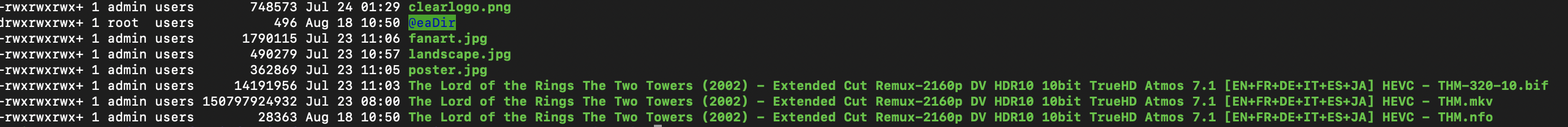

CRiXiD 25 Posted August 18, 2025 Posted August 18, 2025 I'm wanting to migrate my libraries from my docker install on a NUC to a Silicone Mac, and with the inability to access GPU on Mac within docker I'm trying to use the native app, meaning that my resource paths are no longer the same. When adding a library with "Save artwork into media folders" checked, I'm surprised to see that the artwork stored in media folders is being ignored or overridden on import. I've reviewed the naming convention docs, and using posters as an example, all images are either poster.jpg or {name}-poster.ext (as you'd expect, given that Emby created them to begin with). When the new item is added to the library, Any instance of poster.jpg is ignored, with a new {name}-poster.ext created Any instance of {name}-poster.ext is just overridden How do I get Emby to use the local artwork? I've spent A LOT of time setting up artwork I like.

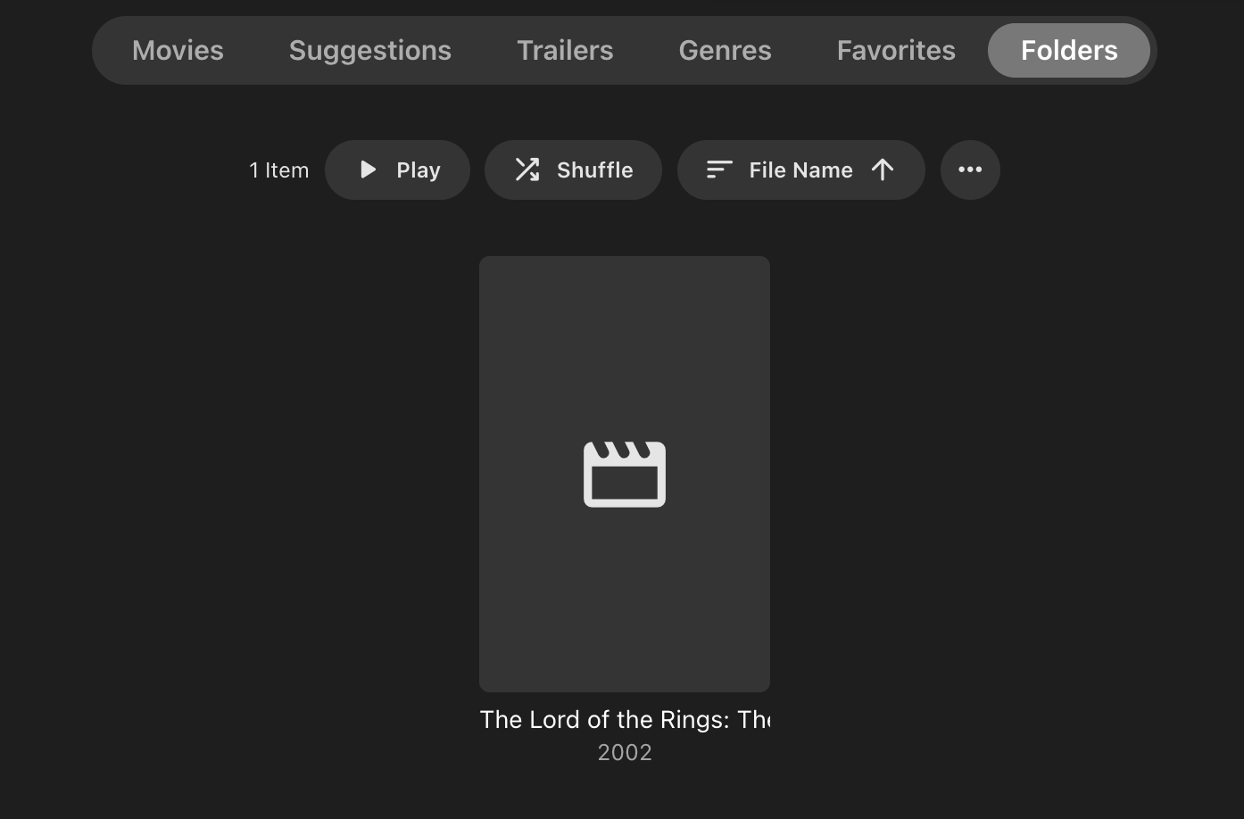

CRiXiD 25 Posted August 18, 2025 Author Posted August 18, 2025 Sure thing. What do you want the screenshot of, the folder in Mac OS?

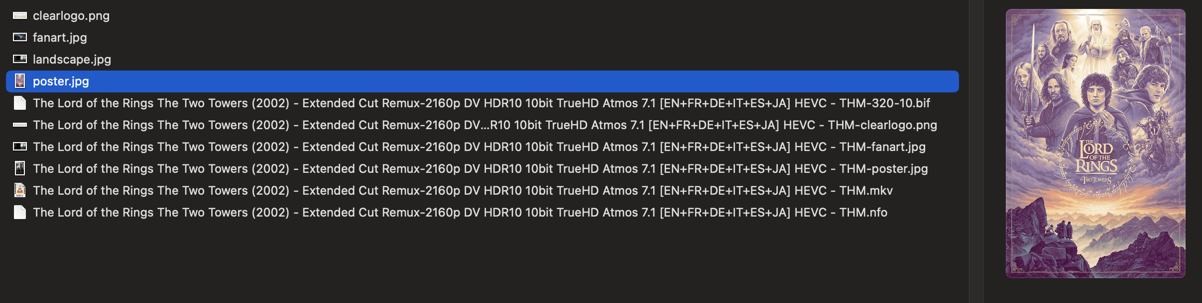

CRiXiD 25 Posted August 18, 2025 Author Posted August 18, 2025 This is the folder I tested with fetchers disabled. All existing artwork was created by Emby on linux / docker.
CRiXiD 25 Posted August 18, 2025 Author Posted August 18, 2025 Here are the permissions for reference

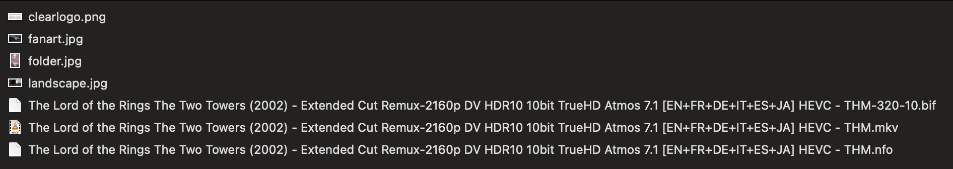

GrimReaper 4893 Posted August 18, 2025 Posted August 18, 2025 Nothing sticks out there, that should definitely work. Is poster-type image the only one that doesn't get read or no artwork type gets imported? As a test, if you rename poster.jpg to folder.jpg, does same occur?
CRiXiD 25 Posted August 18, 2025 Author Posted August 18, 2025 No artwork gets imported. After renaming poster.jpg to folder.jpg and re-adding that folder as a source, this is the outcome

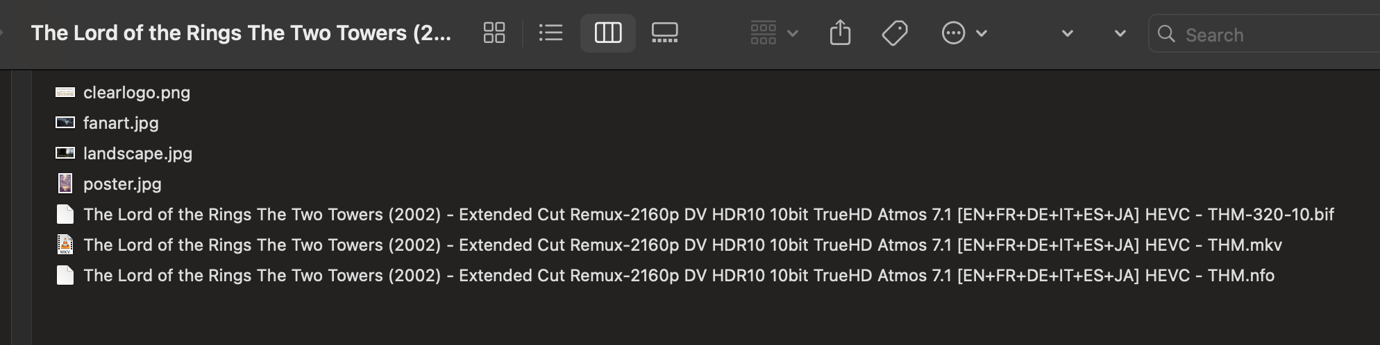

Luke 42237 Posted August 18, 2025 Posted August 18, 2025 HI, what are the complete contents of the folder?

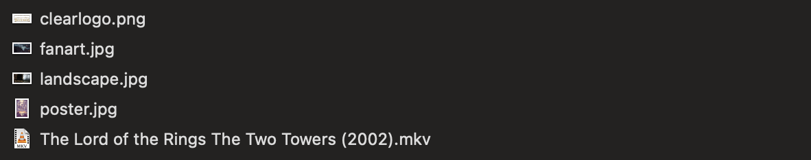

GrimReaper 4893 Posted August 18, 2025 Posted August 18, 2025 (edited) That's good, but it still doesn't explain why fetched artwork was pulled and named in such convention, as if it was movie in a multi-movie folder or it were a multi-version movie. Another test: if you rename media file so it doesn't follow multi-version naming convention ("space-dash-space" after folder name), i.e. just "LOTR (2022).mkv" while dumping cut and mediainfo suffixes for example, how does it behave? Edited August 18, 2025 by GrimReaper
CRiXiD 25 Posted August 18, 2025 Author Posted August 18, 2025 14 minutes ago, GrimReaper said: That's good, but it still doesn't explain why fetched artwork was pulled and named in such convention, as if it was movie in a multi-movie folder or it were a multi-version movie. Another test: if you rename media file so it doesn't follow multi-version naming convention ("space-dash-space" after folder name), i.e. just "LOTR (2022).mkv" while dumping cut and mediainfo suffixes for example, how does it behave? Same outcome unfortunately - no reading of local artwork
