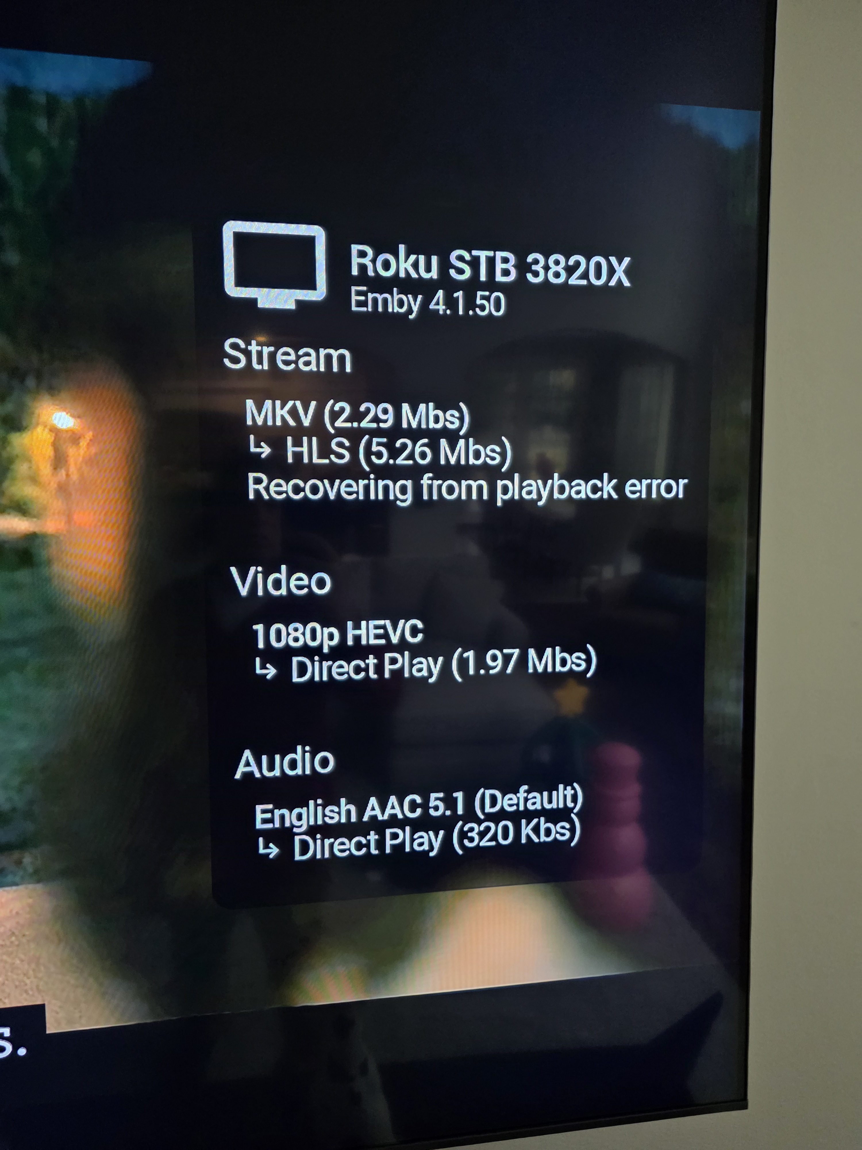

Soundchasr 19 Posted November 18, 2025 Author Posted November 18, 2025 8 minutes ago, Luke said: Hi there, I don't see any playback activity in this log file. Are you sure this is the right one? Ok I played a video. The subs didn't show so I hit playback correct and the subs came back. embyserver.txt
ebr 16354 Posted November 19, 2025 Posted November 19, 2025 20 hours ago, Soundchasr said: Any idea why the problem doesn't occur with Plex (on Roku) They may already be transcoding?
ebr 16354 Posted November 19, 2025 Posted November 19, 2025 21 hours ago, Soundchasr said: Ok. When I click "attempt playback correction," they will show. What's happening there? It will force the server to transcode which will re-package the item and deliver the proper subs so the Roku isn't confused by the flags.
