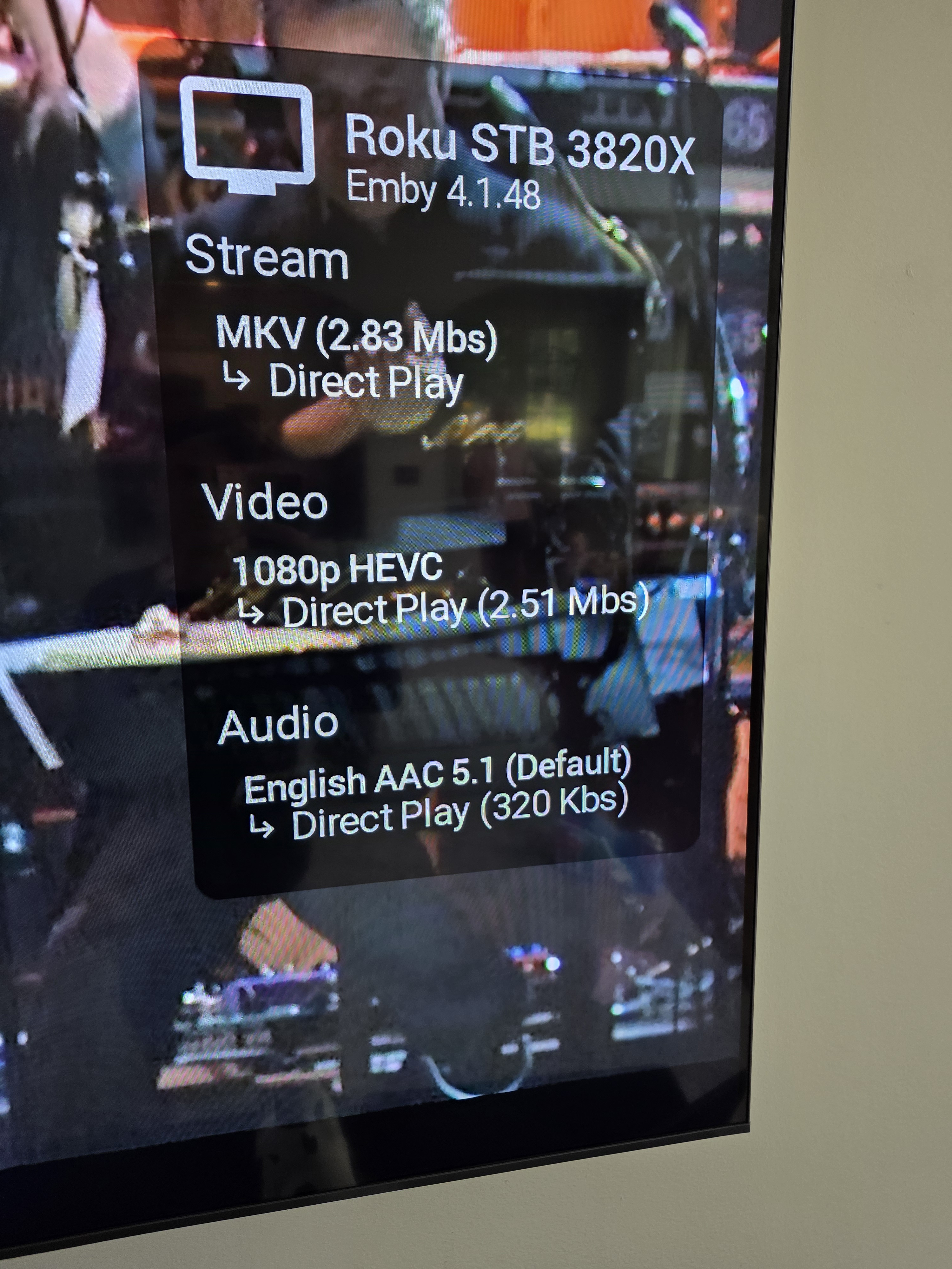

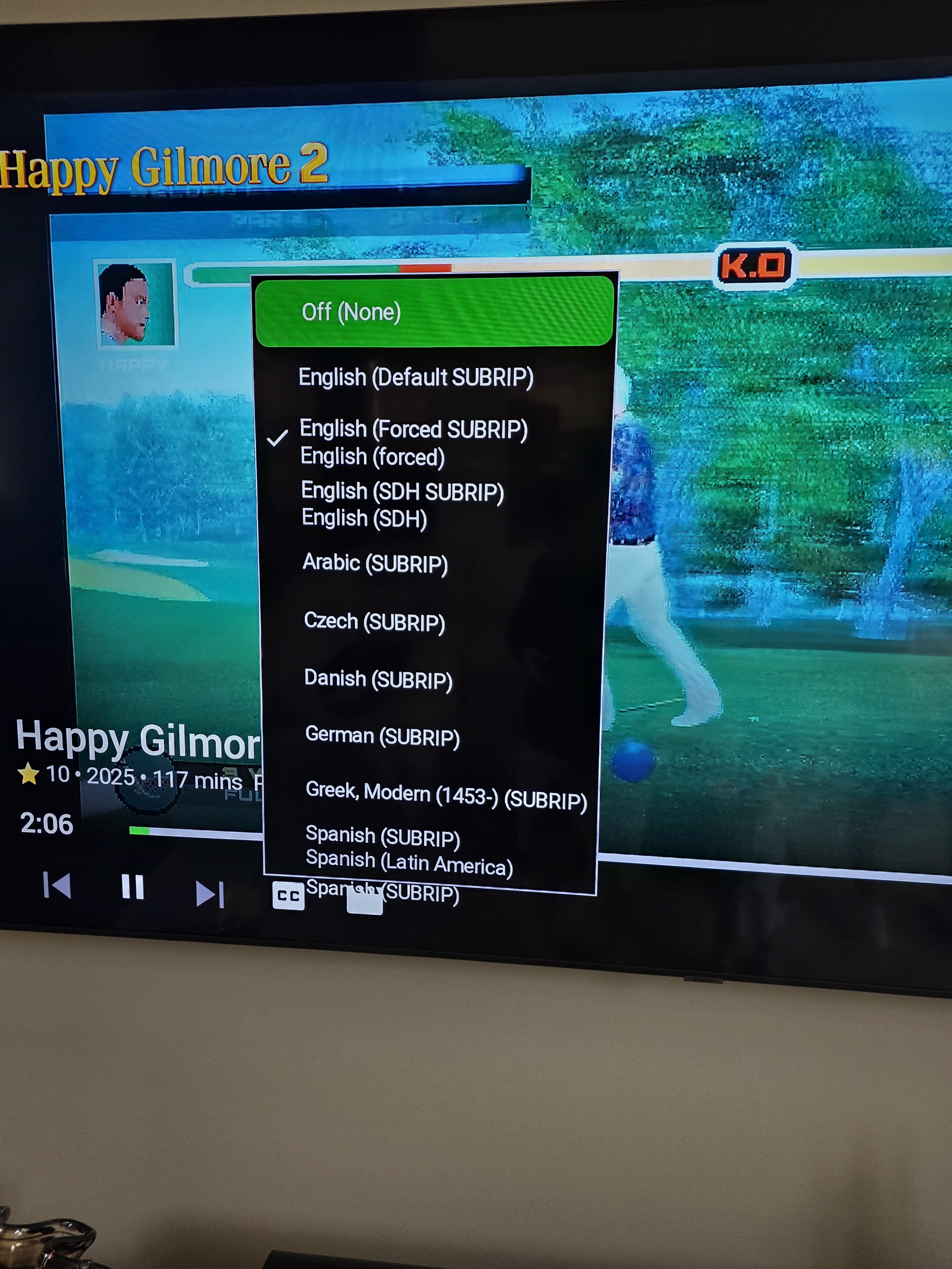

Soundchasr 19 Posted August 17, 2025 Author Posted August 17, 2025 (edited) 18 minutes ago, Neminem said: Need a lot more info that that Ok, sorry. I'm attaching the log file and a couple pics. I just tried watching two movies, Happy Gilmore and Greedy People. Happy is the problem file. When I go to CC I see the whole list of all the subs including multiple English. No matter what one I choose the subs do not show up on screen. I'm using a Roku. I don't see how to send logs from that. . When I play the file through the Emby web page the subs work.... embyserver.txt Edited August 17, 2025 by Soundchasr

ebr 16354 Posted August 17, 2025 Posted August 17, 2025 10 minutes ago, Soundchasr said: but the subs still don't appear I noticed the subs you selected were "forced". Are you sure you are looking in the right place for them? They wouldn't be throughout the movie. Also, for the Roku, make sure that you don't have any other sub streams marked as "default" as the Roku player will be confused if multiples are default. 1
Soundchasr 19 Posted August 17, 2025 Author Posted August 17, 2025 7 minutes ago, ebr said: I noticed the subs you selected were "forced". Are you sure you are looking in the right place for them? They wouldn't be throughout the movie. Also, for the Roku, make sure that you don't have any other sub streams marked as "default" as the Roku player will be confused if multiples are default. I tried all of them (forced and not). I'm not sure what you mean about the Roku. Should I go out to main Roku settings to find that "default" setting?

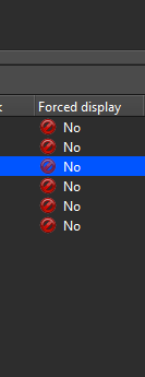

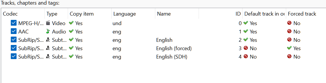

Neminem 1630 Posted August 17, 2025 Posted August 17, 2025 (edited) You should see something like this in MKVToolnix Make sure that there is only 1 set to Forces. Edited August 17, 2025 by Neminem
Soundchasr 19 Posted August 17, 2025 Author Posted August 17, 2025 Here are all my log files. ffmpeg-transcode-d9c51687-5c29-4f49-b1de-66c52b0cff21_1.txt embyserver-63891024513.txt hardware_detection-63891024533.txt embyserver.txt
Soundchasr 19 Posted August 17, 2025 Author Posted August 17, 2025 2 minutes ago, Neminem said: You should see something like this in MKVToolnix Make sure that there is only 1 set to Forces. Yes. Just one forced. 1
ebr 16354 Posted August 17, 2025 Posted August 17, 2025 For kicks try unchecking that forced flag and see if that makes a difference on your Roku.

Soundchasr 19 Posted August 17, 2025 Author Posted August 17, 2025 10 minutes ago, ebr said: For kicks try unchecking that forced flag and see if that makes a difference on your Roku. What the heck! That worked! Not sure why...... Thanks!
Soundchasr 19 Posted August 17, 2025 Author Posted August 17, 2025 Just now, Neminem said: So you are good now ? Yes. Thank you all. I'm not real sure why it happened but it's working now.
Neminem 1630 Posted August 17, 2025 Posted August 17, 2025 Too many subs and the lack of a rescan after altering the movie file 1
ebr 16354 Posted August 17, 2025 Posted August 17, 2025 The Roku is very finicky about those subtitle flags and it gets confused when there is both a "default" and a "forced" one. It thinks it should show both and just throws up its hands and does nothing. 1 1
ebr 16354 Posted August 17, 2025 Posted August 17, 2025 Just now, Neminem said: Too many subs and the lack of a rescan after altering the movie file Perhaps this as well... would be interesting to test if putting that default sub flag back and refreshing still allowed it to work.
Soundchasr 19 Posted August 17, 2025 Author Posted August 17, 2025 1 minute ago, ebr said: The Roku is very finicky about those subtitle flags and it gets confused when there is both a "default" and a "forced" one. It thinks it should show both and just throws up its hands and does nothing. Lol. Thanks.
Soundchasr 19 Posted August 17, 2025 Author Posted August 17, 2025 1 minute ago, ebr said: Perhaps this as well... would be interesting to test if putting that default sub flag back and refreshing still allowed it to work. Will do now. Hold one. 1
Soundchasr 19 Posted August 17, 2025 Author Posted August 17, 2025 6 minutes ago, ebr said: Perhaps this as well... would be interesting to test if putting that default sub flag back and refreshing still allowed it to work. Ok, as soon as I put the forced back in (and refreshed) it won't show any of the subs. 1
