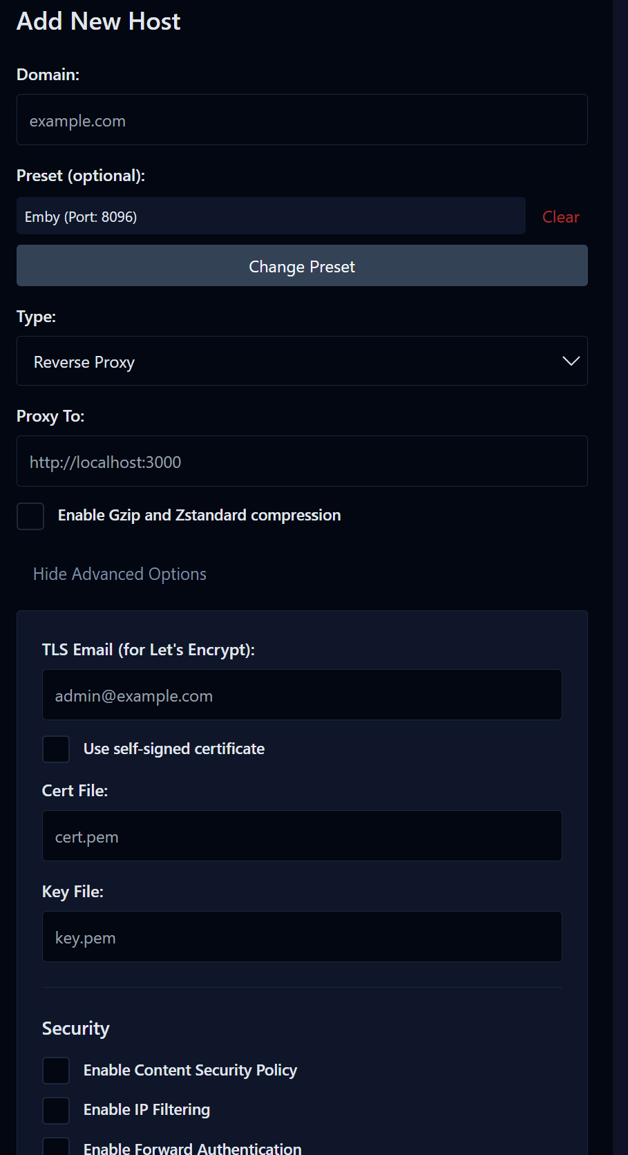

yocker 1414 Posted August 17, 2025 Posted August 17, 2025 1 hour ago, donniedarko83 said: Thank you. That one looks also very promising NPM is a tried and tested industry standard and has a gui and is relatively easy to setup and understand. While Caddy does not have a gui i will argue it's even easier since all you have to put into the config file is something like this: --- { email your@email.com } your.domain.com { reverse_proxy embyeerver:8096 header { X-Robots-Tag "none" } } --- It will automatically handle the rest. You can't go wrong with either of them.
donniedarko83 6 Posted August 17, 2025 Author Posted August 17, 2025 Thank you for the example config file. I can also choose from various presets like this. Would that be easier? What should be entered in the Proxy To: field? C
