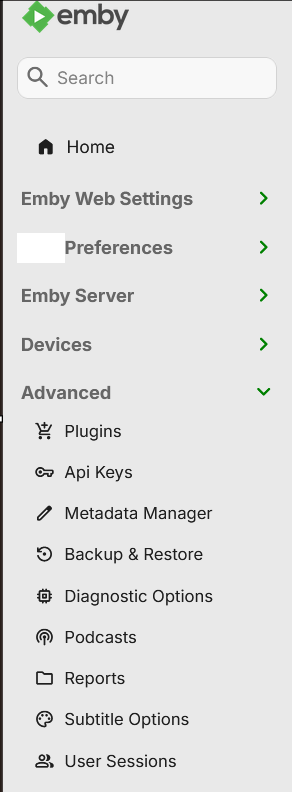

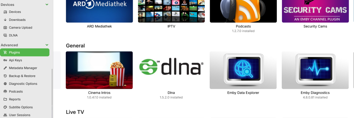

RanmaCanada 503 Posted August 18, 2025 Posted August 18, 2025 @treeger8686the diagnostics plugin, in the plugin section.

RanmaCanada 503 Posted August 19, 2025 Posted August 19, 2025 19 hours ago, treeger8686 said: i check but i dont know where to see informations and log of playback stream. While you are playing something on your device, go to your computer or mobile, doesn't matter, go to manage your server, and in the drop down on the left you should see the user sessions tab, as I posted in the previous image. As it's is discussed in this post.

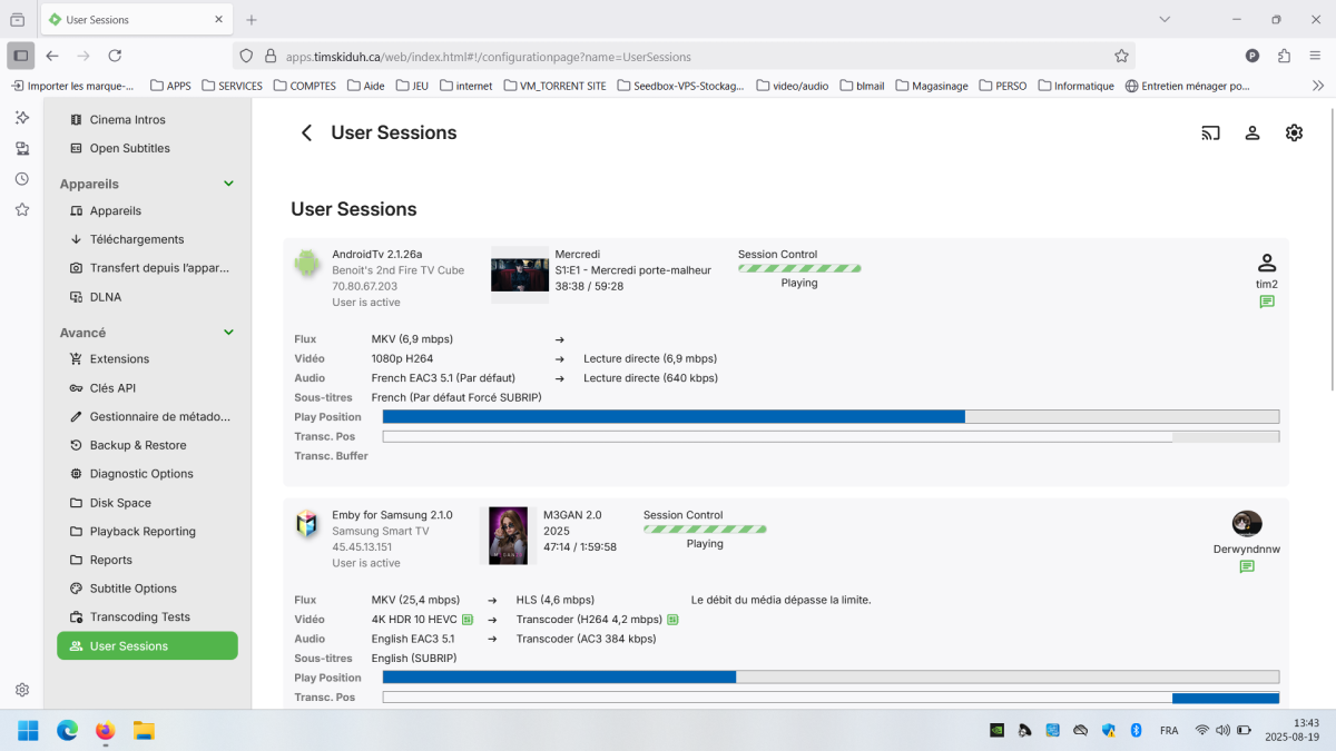

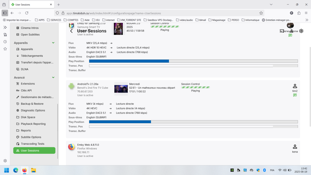

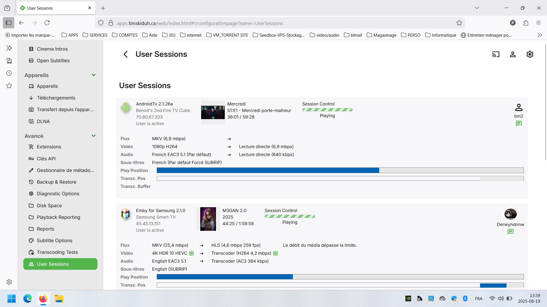

treeger8686 2 Posted August 20, 2025 Author Posted August 20, 2025 1-a 4k file to 4mbits read in direct that suppose to be transcode because is 4-5 mbits. that's the problem 2- second image 4k file to 720kbits direct 3- 1080p file to 5bits not transcoding direct stream stream no transcoding that explain to much bandwith always with version 2.1.26a

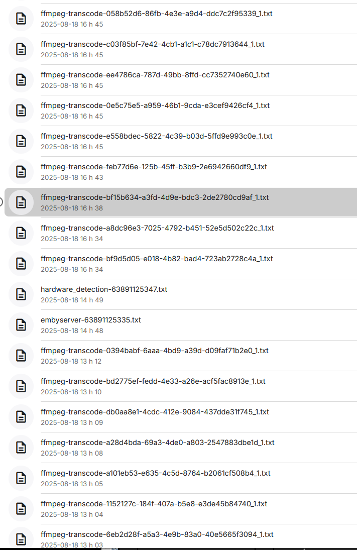

Q-Droid 1011 Posted August 20, 2025 Posted August 20, 2025 Can you upload the logs that include those test sessions? Not transcoding when you think it should makes more sense.

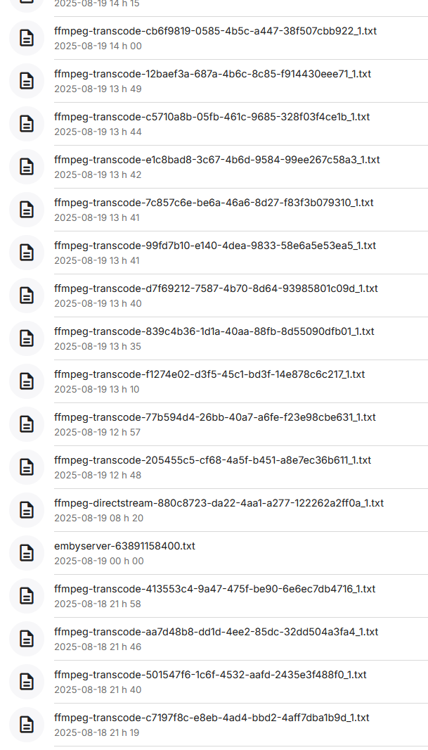

treeger8686 2 Posted August 20, 2025 Author Posted August 20, 2025 i save my screen capture 2025-08-19 at 13h42pm that begin with ffmpeg-transcode-f1274e02-d3f5-45c1-bd3f-14e878c6c217_1.txt ffmpeg-transcode-839c4b36-1d1a-40aa-88fb-8d55090dfb01_1.txt ffmpeg-transcode-d7f69212-7587-4b70-8d64-93985801c09d_1.txt ffmpeg-transcode-99fd7b10-e140-4dea-9833-58e6a5e53ea5_1.txt ffmpeg-transcode-7c857c6e-be6a-46a6-8d27-f83f3b079310_1.txt ffmpeg-transcode-e1c8bad8-3c67-4b6d-9584-99ee267c58a3_1.txt ffmpeg-transcode-c5710a8b-05fb-461c-9685-328f03f4ce1b_1.txt ffmpeg-transcode-12baef3a-687a-4b6c-8c85-f914430eee71_1.txt end with: ffmpeg-transcode-cb6f9819-0585-4b5c-a447-38f507cbb922_1.txt ffmpeg-transcode-1eab30eb-087f-4d43-adcc-8bb0a1816e93_1.txt ffmpeg-transcode-e365b8e0-bf3c-4dc9-8a47-682d274050d2_1.txt ffmpeg-transcode-cb6f9819-0585-4b5c-a447-38f507cbb922_1.txt ffmpeg-transcode-12baef3a-687a-4b6c-8c85-f914430eee71_1.txt ffmpeg-transcode-c5710a8b-05fb-461c-9685-328f03f4ce1b_1.txt ffmpeg-transcode-e1c8bad8-3c67-4b6d-9584-99ee267c58a3_1.txt ffmpeg-transcode-7c857c6e-be6a-46a6-8d27-f83f3b079310_1.txt ffmpeg-transcode-99fd7b10-e140-4dea-9833-58e6a5e53ea5_1.txt ffmpeg-transcode-d7f69212-7587-4b70-8d64-93985801c09d_1.txt ffmpeg-transcode-f1274e02-d3f5-45c1-bd3f-14e878c6c217_1.txt

Q-Droid 1011 Posted August 20, 2025 Posted August 20, 2025 Can you also upload the server log for those sessions?
treeger8686 2 Posted August 20, 2025 Author Posted August 20, 2025 embyserver-63891158400.txt embyserver.txt embyserver-63891244800.txt
Q-Droid 1011 Posted August 20, 2025 Posted August 20, 2025 From your logs: You have mixed bitrate limits of 6mbps and 7mbps (user/global?) The Fire TV connects as local and remote. Local - Benoit's 2nd Fire TV Cube Emby-Client-Version=3.4.74 Remote - Benoit's 2nd Fire TV Cube Emby-Client-Version=2.1.26a The Samsung TV appears to always be a remote connection so it doesn't make any sense why it shows as direct streaming in your first image. The logs show that it's transcoding.

treeger8686 2 Posted August 20, 2025 Author Posted August 20, 2025 they missing button submit replay few years ago. yes i use remote only but normaly i use in local all my test are done frome remote with a second internet provider at 100mbits download. my first internet are 500mbits 57 upload. i switch my internet from wifi 1 to wifi 2 and drop to remote for my test. samsung tv is my friend liste megan on remote without problem. did have a differrence between 3.4.74 ans 2.1.26a for bandwith but why im not ins trancoding i think is where are the bug
