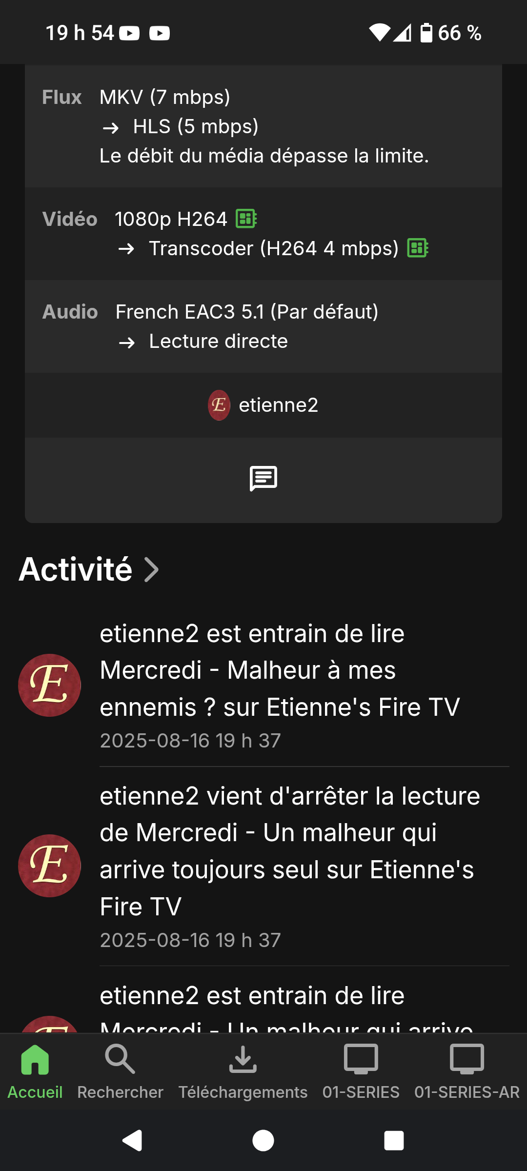

treeger8686 2 Posted August 16, 2025 Posted August 16, 2025 (edited) Hi the bug is come.back on fire tv. I have 4k file limited to 5mbits in transcoding and that use in 16 to 30 mbits. An another exemple 1080 h264 limitea du 5 mbits transcoding at 4 mbits but use 30mbits on upload only in this server emby. That arrive few day ago and i have only 50mbis that slow my job work beacause of this bugs. Nothing people have see that an no report on redddit or emby forum. Is major problem. That do 6 month amd more all.working good 5mbits limita and 5-7mbits was use before few day ago. On tv lg no problem and sony too. My sever is on window 4.8.11 Firestick v. 2.1.26a Edited August 16, 2025 by treeger8686 orthograph and add picture

treeger8686 2 Posted August 17, 2025 Author Posted August 17, 2025 i sendddd my report for fire tv at 8;15pm eastern canada quebec. with movie at 8h10pm 8h20 mercredie s01e01 on account tim2. i use to full max 36mbit upload. sorry fo my bad english im french canadian ffmpeg-transcode-312bd3c9-0478-4fa4-8bea-3ac03e91de4a_1.txt ffmpeg-transcode-a328db09-5489-4e9e-bfe6-c326cd57cea3_1.txt ffmpeg-transcode-3bdf6476-e7b1-4438-a4ef-d9660e505fbc_1.txt embyserver.txt

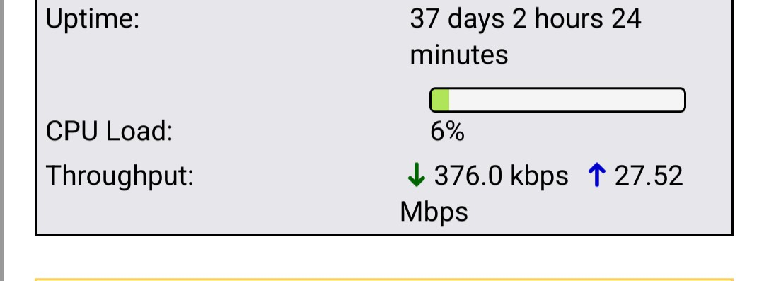

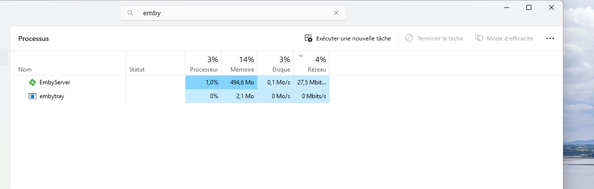

treeger8686 2 Posted August 17, 2025 Author Posted August 17, 2025 here data in real time all limit is sett to 5mbits but 27 to 36mbits use in upload only for that

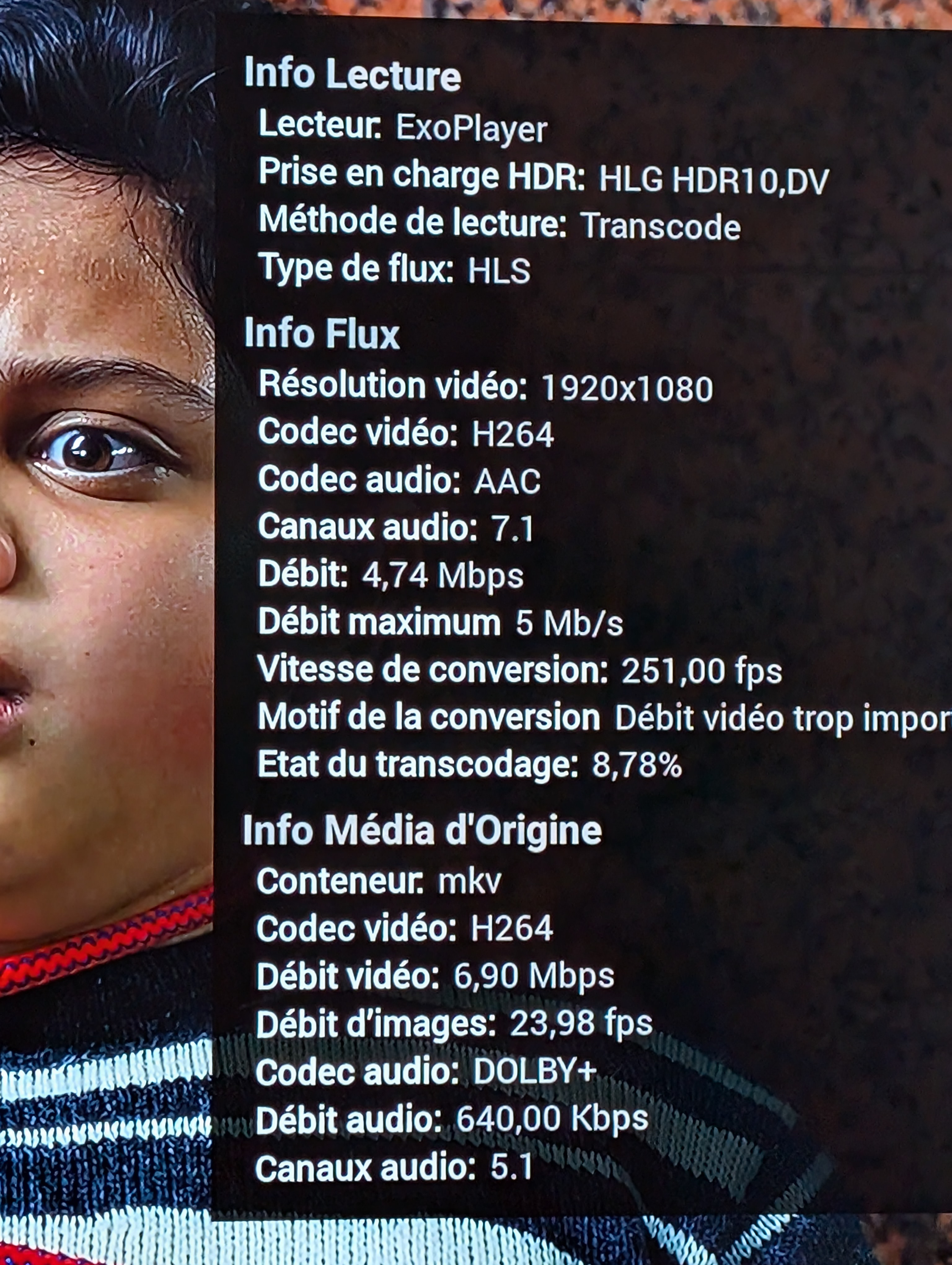

treeger8686 2 Posted August 17, 2025 Author Posted August 17, 2025 i joint other log i try on my lg tv and hisense tv on google os. for lg tv tha lmite at 3-7.79mbits thats ok for the two stream in parrallell is on 7-30mbits. a little to much up. i hope you can find problem. embyserver-63891016671.txt hardware_detection-63891016991.txt hardware_detection-63891017314.txt ffmpeg-transcode-94e02403-ca0b-491a-b85d-8981af32c853_1.txt ffmpeg-transcode-29bc2219-abe1-45ef-976c-13e5a39f55d9_1.txt ffmpeg-transcode-08c0c365-b6c9-468a-b9ed-9e8419ca0b05_1.txt embyserver.txt

treeger8686 2 Posted August 17, 2025 Author Posted August 17, 2025 (edited) No i use one pc on windows with p4000 quatro and proxy reverse on gnix on proxmox vm fedora all working good few day ago a i dont update my servers I do.a video explain on tv not on fire tv work good example in lg tv upload is.normal. First video with lg second on firestick 2.1.26a. Thats completely weird. Edited August 17, 2025 by treeger8686

treeger8686 2 Posted August 17, 2025 Author Posted August 17, 2025 Thats as been test with only one client and router show the exact only upload for emby and picture of windoww show emby at 27 mbits for one user. And like have explain that touch only fire tv not lg tv not samsung tv. Is a real bug.
