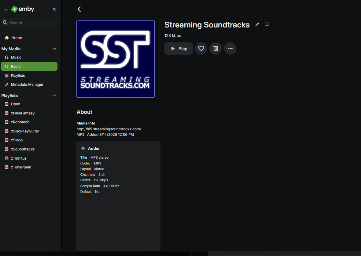

Guest Posted August 14, 2025 Posted August 14, 2025 I am new to emby and I am trying to find out if this will work as an audio streaming locally for me. I am able to connect to our Sonos speakers through the plug in. One does not show up because I suspect it is in use. I used this forum thread to create an Internet Radio library using STRM files. I have got a stream that works for all my radio stations except for one (Streamingsoundtracks.com), which I have used elsewhere for years. I am using I keep getting the following error message, but nothing in the log. "No compatible streams are currently available. Please try again later or contact your system administrator for details." I understand it might not be compatible but I would be interested to know why. It is one of our favorite stations. It is only http, but I have got in working on TuneIn. Thanks.

Guest Posted August 14, 2025 Posted August 14, 2025 I have tried all three entries I used in the past and they do work depending on the program. http://www.streamingsoundtracks.com/modules/Listen/MP3-hi.pls http://hi5.streamingsoundtracks.com http://hi.streamingsoundtracks.com The best has been http://hi5.streamingsoundtracks.com Tunein works with http://www.streamingsoundtracks.com/modules/Listen/MP3-hi.pls Foobar 2000 (Windows) & MPC-HC (Windows) works with http://hi5.streamingsoundtracks.com I checked and the site itself is working.
Guest Posted August 15, 2025 Posted August 15, 2025 Looked at the log closely and it appears to be this section. Quote 2025-08-15 16:57:02.196 Info Server: http/1.1 HEAD http://192.168.254.201:8096/emby/Audio/27808/universal?UserId=e36a1362f2904b96905e73866103f338&DeviceId=4009536c-14c2-4982-8937-120b5c4e764c&MaxStreamingBitrate=200000000&Container=opus,mp3|mp3,mp2,mp3|mp2,m4a|aac,mp4|aac,flac,webma,webm,wav|PCM_S16LE,wav|PCM_S24LE,ogg&TranscodingContainer=aac&TranscodingProtocol=hls&AudioCodec=aac&api_key=x_secret4_x&PlaySessionId=1755277004520&StartTimeTicks=0&EnableRedirection=true&EnableRemoteMedia=false. Source Ip: host1, Accept=*/*, Connection=keep-alive, Host=host2, User-Agent=Mozilla/5.0 (Windows NT 10.0; Win64; x64; rv:141.0) Gecko/20100101 Firefox/141.0, Accept-Encoding=gzip, deflate, Accept-Language=en-US,en;q=0.5, Referer=host4, Sec-GPC=1, Priority=u=4 2025-08-15 16:57:02.223 Info App: User policy for listen. EnableAudioPlaybackTranscoding: True 2025-08-15 16:57:02.224 Info HttpClient: GET http://hi5.streamingsoundtracks.com/ 2025-08-15 16:57:02.444 Error HttpClient: Error getting response from http://hi5.streamingsoundtracks.com/ *** Error Report *** Version: 4.8.11.0 Command line: /system/EmbyServer.dll -programdata /config -ffdetect /bin/ffdetect -ffmpeg /bin/ffmpeg -ffprobe /bin/ffprobe -restartexitcode 3 Operating system: Linux version 4.4.302+ (root@build6) (gcc version 12.2.0 (GCC) ) #72806 SMP Mon Jul 21 23:12:58 CST 2025 Framework: .NET 6.0.36 OS/Process: x64/x64 Runtime: system/System.Private.CoreLib.dll Processor count: 4 Data path: /config Application path: /system MediaBrowser.Model.Net.HttpException: MediaBrowser.Model.Net.HttpException: Received an invalid status line: 'ICY 200 OK'. ---> System.Net.Http.HttpRequestException: Received an invalid status line: 'ICY 200 OK'. at System.Net.Http.HttpConnection.ParseStatusLine(ReadOnlySpan`1 line, HttpResponseMessage response) at System.Net.Http.HttpConnection.SendAsyncCore(HttpRequestMessage request, Boolean async, CancellationToken cancellationToken) at System.Net.Http.HttpConnection.SendAsyncCore(HttpRequestMessage request, Boolean async, CancellationToken cancellationToken) at System.Net.Http.HttpConnectionPool.SendWithVersionDetectionAndRetryAsync(HttpRequestMessage request, Boolean async, Boolean doRequestAuth, CancellationToken cancellationToken) at System.Net.Http.DiagnosticsHandler.SendAsyncCore(HttpRequestMessage request, Boolean async, CancellationToken cancellationToken) at System.Net.Http.RedirectHandler.SendAsync(HttpRequestMessage request, Boolean async, CancellationToken cancellationToken) at System.Net.Http.DecompressionHandler.SendAsync(HttpRequestMessage request, Boolean async, CancellationToken cancellationToken) at System.Net.Http.HttpClient.<SendAsync>g__Core|83_0(HttpRequestMessage request, HttpCompletionOption completionOption, CancellationTokenSource cts, Boolean disposeCts, CancellationTokenSource pendingRequestsCts, CancellationToken originalCancellationToken) at Emby.Server.Implementations.HttpClientManager.CoreHttpClientManager.SendAsyncInternal(HttpRequestOptions options, String httpMethod) --- End of inner exception stack trace --- The ERROR is this line: Received an invalid status line: 'ICY 200 OK'. I found this reference. It is about 11 1/2 years ago but it appears to explain it. It is for android kit kat but it seems applicable. https://stackoverflow.com/questions/21812483/unexpected-status-line-icy-200-ok-for-url-openstream-method Quote According to changes for kitakt 4.4 there were some problems with playing shoutcast streams (those returning "ICY" instead of "HTTP/1.x" response). So I think your handler doesn't support this stream type. Unfortunate for me.
