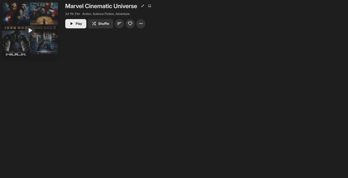

KandyMan 7 Posted August 14, 2025 Posted August 14, 2025 I'm not sure at what point this happened as I generally update to the latest beta quite frequently, but my playlists no longer display any items in them. I'm sure the data is still there as they still display how long the playlist is. This was definitely working earlier in the current beta cycle but appears to have broken since. Currently broken in 4.9.18 and was also broken in 4.9.17

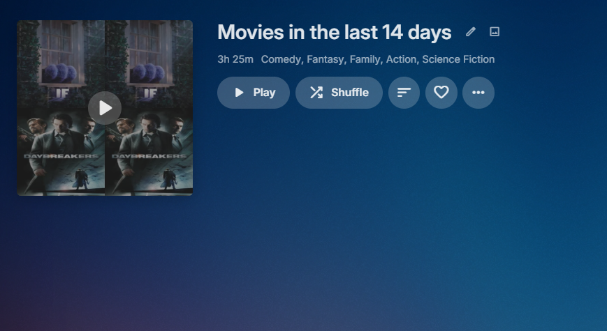

Happy2Play 9811 Posted August 25, 2025 Posted August 25, 2025 Do you by chance have any Access or Parental Controls enabled on the User? From a basic test as User has restricted access the playlist shows Empty.
KandyMan 7 Posted October 1, 2025 Author Posted October 1, 2025 Sorry for not replying sooner, it's been a busy time. The playlists were all created in emby yes. Any that were created within the last few months or so appear fine, but playlists that have been there for years show like in Happy2Play's screenshot above. I have no Access or Parental Controls on the user, this is the admin emby user. That screenshot is exactly what I see though. I wonder if when during one of the DSM updates when I had to move playlists around it could have revoked some permissions for the emby Synology user? I'm reaching a bit there though I think
Happy2Play 9811 Posted October 1, 2025 Posted October 1, 2025 But with Emby showing a duration for the playlist it would suggest something wonky with user access as it know the actual duration for all the content that should be listed.
Solution Luke 42239 Posted October 1, 2025 Solution Posted October 1, 2025 Hi ,have you updated to the latest build? if you refresh the metadata on one of these playlists, does that help? 1
KandyMan 7 Posted October 1, 2025 Author Posted October 1, 2025 1 hour ago, Luke said: Hi ,have you updated to the latest build? if you refresh the metadata on one of these playlists, does that help? I just updated to 4.9.1.80 a couple of hours ago, and yes refreshing the metadata on the playlists fixed every single one of them, thanks! 1 2
