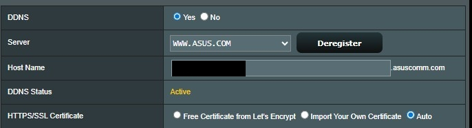

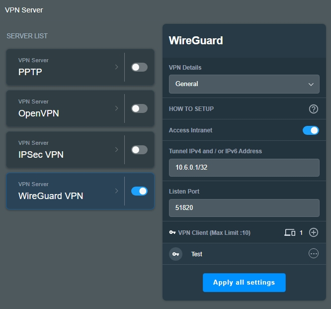

Bolongo 1 Posted August 13, 2025 Author Posted August 13, 2025 (edited) Yes, I tried to set it up. 1. First, I set up DDNS. 2. Then I set up VPN. I tried OpenVPN and WireGuard, but neither of them https://www.asus.com/support/faq/1011725/ works. https://www.asus.com/support/faq/1048280/ and https://www.youtube.com/watch?v=rSvHQw0KwvM Edited August 13, 2025 by Bolongo

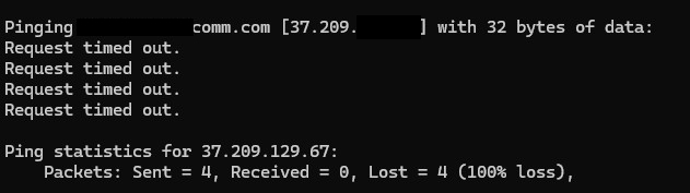

Q-Droid 1011 Posted August 13, 2025 Posted August 13, 2025 Did you try the VPN connection? If you have WAN ICMP (ping) disabled in your router you won't get a response but the connection to Wireguard should still work.
Bolongo 1 Posted August 13, 2025 Author Posted August 13, 2025 Yes, I tried. Both OpenVPN and WireGuard. They didn't connect to the router. I've read various forums and maybe the problem is on the ISP side, maybe I have CGNAT? I'll talk to the ISP helpdesk today.

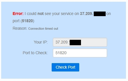

Q-Droid 1011 Posted August 13, 2025 Posted August 13, 2025 (edited) That should be easy enough to check. Compare your router WAN IP to what you get from https://canyouseeme.org/. You can also use that site to test your VPN port. Edited August 13, 2025 by Q-Droid

Q-Droid 1011 Posted August 13, 2025 Posted August 13, 2025 The WAN IP for your router, not the Emby server. You want to compare the router WAN interface because with CGNAT your detected public IP and assigned public IP would be different.
Solution Bolongo 1 Posted August 14, 2025 Author Solution Posted August 14, 2025 On 8/13/2025 at 2:23 PM, Q-Droid said: The WAN IP for your router, not the Emby server. You want to compare the router WAN interface because with CGNAT your detected public IP and assigned public IP would be different. I found out that my internet provider uses CGNAT. Everything became clear. I installed Tailscale on Synology. https://tailscale.com/kb/1131/synology Thank you all for your help :-) 1
