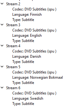

Guest Posted August 12, 2025 Posted August 12, 2025 Hello! Plain and simple problem... I get an error message when I try to play H265 codec movies. Do you need any other log than transcode log? This is the error message what i see: "Playback Error No compatible streams are currently available. Please try again later or contact your system administrator for detail" Movie codec information: Emby server run on Windows server 2022 (Emby premiere) and Emby run on HPE Microserver Gen 8 and Processor is Intel(R) Xeon(R) CPU E3-1265L V2 @ 2.50GHz, 2501 Mhz, 4 Core(s), 8 Logical Processor(s). I have also tested this on another computer which is H265 compatible in terms of processor, but it gives the same error. Also tested latest beta version without success. I have also tried adjusting various settings without any result. If any essential information was missing, I will fill it in accordingly. ffmpeg-transcode-b9289f5d-a5f2-47e2-a20e-90f26a775ee8_1.txt

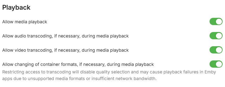

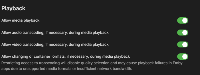

Neminem 1630 Posted August 12, 2025 Posted August 12, 2025 Is your transcoding dir on your NAS ? 09:52:49.667 Output #0, segment, to '\\192.168.10.12\Media\Transcoding_temporary_path\transcoding-temp\472517\472517_%d.ts': 09:52:49.667 Output file #0 does not contain any stream How have you configured your user ?
Guest Posted August 12, 2025 Posted August 12, 2025 (edited) Yes, transcoding dir located on my NAS like all my media files. It was on my HPE before, but i changed it for testing purpose. My user config is like yours. This "user" User what you can see in the log file is my admin account. Everything should be allowed by default i think... Edited August 12, 2025 by s2mpyLLy
Neminem 1630 Posted August 12, 2025 Posted August 12, 2025 (edited) Hmm ok is it only this file or all h265 files ? I don't like this error in your logs Emby.Server.MediaEncoding.Unified.Ffmpeg.FfRunException: Emby.Server.MediaEncoding.Unified.Ffmpeg.FfRunException: Error starting ffmpeg -loglevel +timing -y -print_graphs_file "C:\Users\administrator.KOTI\AppData\Roaming\Emby-Server\programdata\logs\ffmpeg-transcode-3669cdbd-2ec9-4126-989d-df68e4174431_1graph.txt" -copyts -start_at_zero -f matroska,webm -i "\\192.168.10.12\Media\Elokuvat\The Thomas Crown Affair\The Thomas Crown Affair.mkv" -vn -an -sn -max_delay 5000000 -avoid_negative_ts disabled -f segment -map_metadata -1 -map_chapters -1 -segment_format mpegts -segment_list "\\192.168.10.12\Media\Transcoding_temporary_path\transcoding-temp\A20DF0\A20DF0.m3u8" -segment_list_type m3u8 -segment_time 00:00:03.000 -segment_list_entry_prefix hls/A20DF0/ -segment_start_number 0 -individual_header_trailer 0 -write_header_trailer 0 -segment_write_temp 1 "\\192.168.10.12\Media\Transcoding_temporary_path\transcoding-temp\A20DF0\A20DF0_%d.ts" And then exited with this error. Output file #0 does not contain any stream As if Emby can't read the file when trying to transcode it. Can you try remuxing the file. Edited August 12, 2025 by Neminem

Guest Posted August 12, 2025 Posted August 12, 2025 (edited) Yes, file is on a MKV format and no, subtiles not working anymore after conversion. Don't know much about these things, but sometimes the file has separate subtitles (srt file), but they don't work anymore after conversion either. This movie you see in the log file has burned subtitles. Here i get out using VLC. EDIT: Yes, yout test sampe did work. So, this might be subtiles related, even subtiles are burned? Edited August 12, 2025 by s2mpyLLy
Neminem 1630 Posted August 12, 2025 Posted August 12, 2025 Can you try the MKV file I posted in your system and see if that plays. It does not contain DVD_Subtitles.

Neminem 1630 Posted August 12, 2025 Posted August 12, 2025 (edited) Do you still have a copy from when the source file had subs ? Try again without removing the subs, just remux the file, and see if that works. If it does not work then its the subs. Edited August 12, 2025 by Neminem
Guest Posted August 12, 2025 Posted August 12, 2025 Not too familiar with the mkvtoolnix, but i run the movie throught it and subtiles was enabled. Movie did not work
Neminem 1630 Posted August 12, 2025 Posted August 12, 2025 (edited) Ok then it will be that subs + remux. I always only use .srt subs, they are so much lighter that PGS, DVD and other picture based subs. Text based subs are best for streaming use like Emby. Edited August 12, 2025 by Neminem 1
