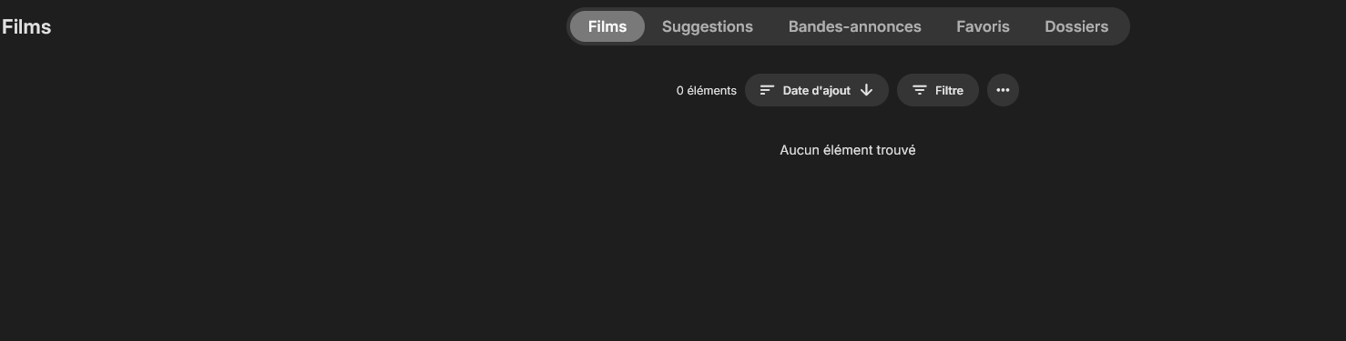

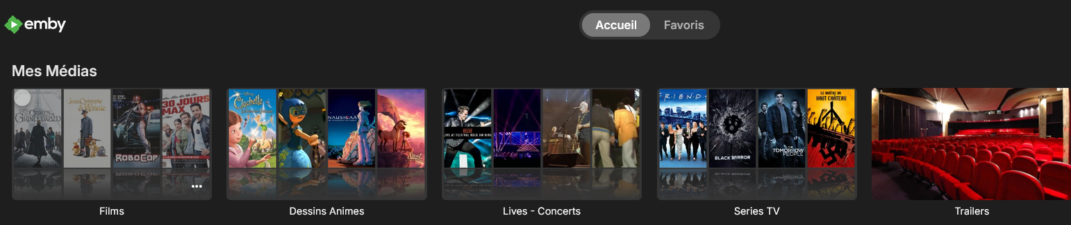

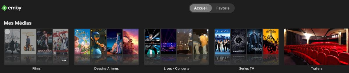

capricorne 2 Posted August 10, 2025 Posted August 10, 2025 Hi, I m using Emby (premiere) since few months now on a Synology DS1819+ running Emby Version 4.8.11.0 Emby is accessing several repository on my NAS part of the media Library: TV shows, Anims, concerts, and movies. Every night, the repositories are scanned to check is anything new is present (planned task). Everything is stable except the movies. All my movies where there yesterday, and today, it"s empty until the next scan. And when the next scan will be performed, the few fixes I did on some misrecognized movies will be lost. All repositories are in the same Drive on the NAS, accesses granted are perfectly fine. This NAS is not running anything else. Logs: embyserver-63890425532.txt Screens: Seems ok (Films = Movies) But, nothing inside: Any ideas of the issue is welcomes, I m a bit bored by this random issue.
