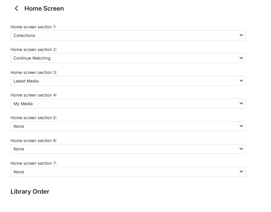

Luke 42239 Posted August 9, 2025 Posted August 9, 2025 Hi, did you check your Emby user Home Screen settings? Did you check what libraries the user has access to?
sdxbe 0 Posted August 12, 2025 Author Posted August 12, 2025 (edited) Hi Luke, the answer is yes both times. I have full access to all libraries and the home screen settings are default. I installed Emby server on my desktop PC and that runs just fine. So I'm not sure what's wrong with my settings on my Synology. Edited August 12, 2025 by sdxbe

Luke 42239 Posted August 12, 2025 Posted August 12, 2025 4 hours ago, sdxbe said: Hi Luke, the answer is yes both times. I have full access to all libraries and the home screen settings are default. I installed Emby server on my desktop PC and that runs just fine. So I'm not sure what's wrong with my settings on my Synology. What do you mean by default? What sections are configured to show?

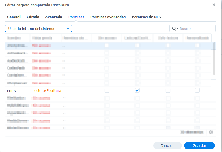

sinsen83 2 Posted September 12, 2025 Posted September 12, 2025 (edited) Buenas. Instaló el Emby en una Sinología 423+. Creo que el problema es tema de permisos. Dentro de la Sinología dale permisos a la alfombra al servicio Emby como Lectura/Escritura y ya lo tienes solucionado. Una vez des permisos, no solo vas a seleccionar dentro de Emby la unidad, sino también las alfombras que hay dentro. Es ahi cuando te aparecen todas . Cuando tengas los permisos, entras otra vez a esa unidad y ya puedes poner "Peliculas" , "Series" , etc. Eso me paso a mi, pero he tenido Plex con anterioridad y aprendiz de eso. Un saludo Edited September 12, 2025 by sinsen83 1

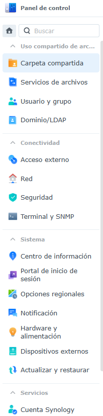

sinsen83 2 Posted September 12, 2025 Posted September 12, 2025 Panel de control > Carpeta cmpartida > Permisos > Selecionas usuario interno del sistema > nombre "emby" y selecionas lectura/escritura Espero que sea eso. Un saludo 1
