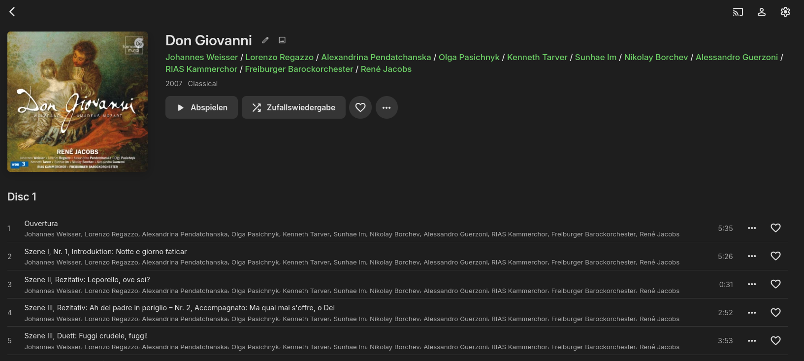

goblin2k3 6 Posted August 9, 2025 Posted August 9, 2025 Hello, first thing: I really like that emby generally supports the composer tag. The implementation seems a little bit bare bones IMO and should be expanded. It should be possible to edit the composer tag with the metadata editor. This would also allow adding composers to music videos which is not the case at the moment. Emby should read out a tag containing the Musicbrainz ID of a composer so the romantic composer "Peter Cornelius" is not mixed up with the Schlager singer of the same name. How about "musicbrainz_composerid"? It should be possible to set an "album composer" so a complete recording of Bach's Brandenburg Concertos is not treated the same way as some Christmas CD containing a two minutes chorale setting by him. Reading out tags named "albumcomposer" and "musicbrainz_albumcomposerid" would make sense. Thanks for reading. 1

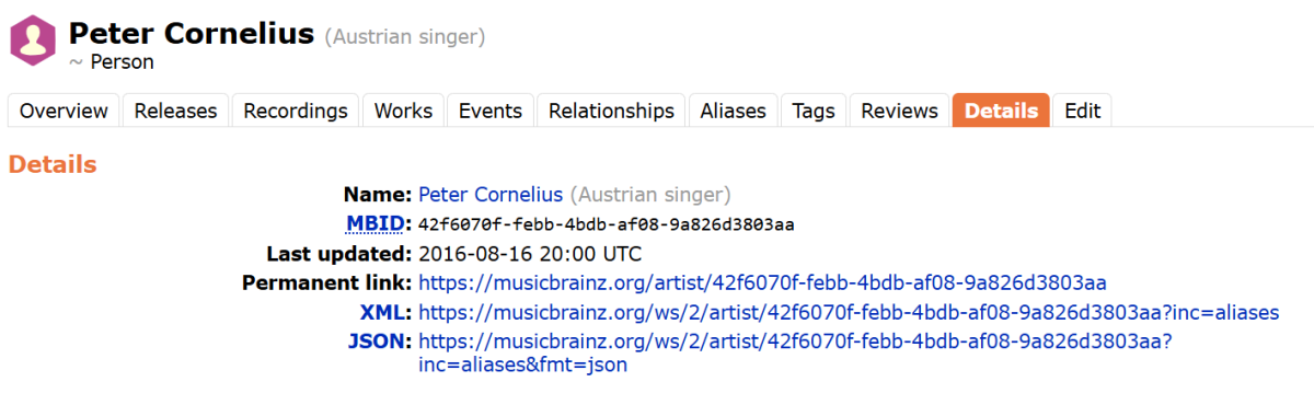

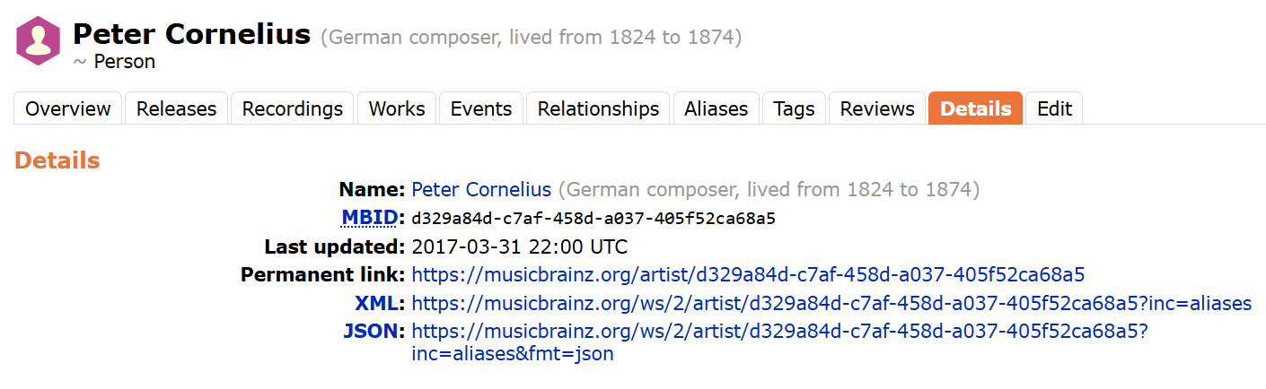

user24 352 Posted August 9, 2025 Posted August 9, 2025 (edited) Hi, here's some thoughts (may or may not be helpful?)... 2 hours ago, goblin2k3 said: It should be possible to edit the composer tag with the metadata editor. This would also allow adding composers to music videos which is not the case at the moment. Have you looked at: Edit Metadata > People > Name + Type (Composer) for adding Composers to Music Videos? I don't know how well this may or may not coincide with Composers in music libraries - but perhaps worth a look to see what is possible? 2 hours ago, goblin2k3 said: Emby should read out a tag containing the Musicbrainz ID of a composer so the romantic composer "Peter Cornelius" is not mixed up with the Schlager singer of the same name. How about "musicbrainz_composerid"? These two people already have different MBIDs in MusicBrainz so you should be able to separate them as needed: https://musicbrainz.org/artist/d329a84d-c7af-458d-a037-405f52ca68a5/details https://musicbrainz.org/artist/42f6070f-febb-4bdb-af08-9a826d3803aa/details If you didn't have this info in your embedded tags when importing into Emby, then Emby may have 'guessed' and assigned the wrong ID? Also (AFAIK) there is no such tag as a musicbrainz_composerid. I think MBIDs are the same format for all artists, whether they’re composers or performers. (but more Artist and Composer separation is definitely worthwhile - however it is done) 2 hours ago, goblin2k3 said: It should be possible to set an "album composer" so a complete recording of Bach's Brandenburg Concertos is not treated the same way as some Christmas CD containing a two minutes chorale setting by him. Reading out tags named "albumcomposer" and "musicbrainz_albumcomposerid" would make sense. This sorta makes sense, but I don't think an "albumcomposer" type of tag actually exists as any standard anywhere??? What you could do is experiment with the Album Artist tags and come up with a system that works for you. This is a multi-field in Emby so you can assign more than one Album Artist to an individual album (e.g. a performer Album Artist and a composer Album Artist), if you want to. So you are essentially making your own Album Composer assignment which should then appear under "Albums" on the Composer detail page. Assigning more than one Album Artist is a really good way of cross-referencing your music library. There's possibly other things you could try with Tags and Collections if any of the above doesn't help. Good luck with getting it all sorted out. Cheers! Edited August 9, 2025 by user24
