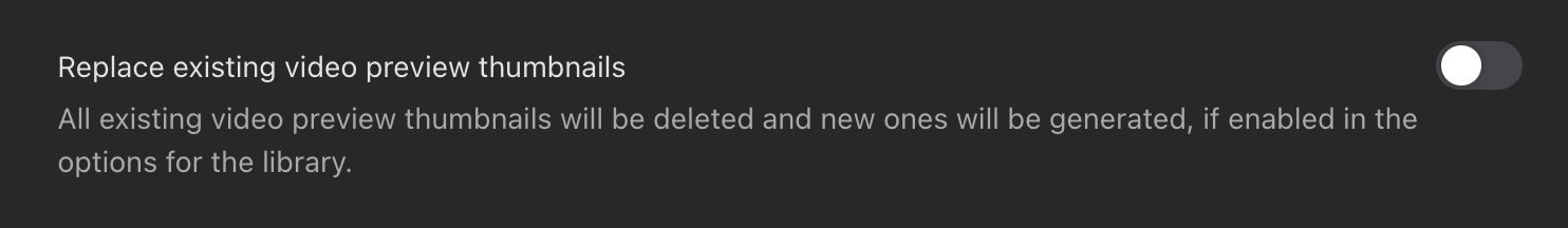

also i hit a bug/gap regarding scrub images - I deleted them all thinking it would be easy to have the server regenerate them and that doesn't appear to be the case. While this option "works"
it always goes over the entire library and for a large one that would take days (1000s of shows)  you can not add or scan anything else, less then ideal. The scheduled task doesn't seem to pick up that they are missing. And there didn't seem to be any other way to trigger a recreation of them for only the ones that are missing?
Edited by katbyte
If you delete files manually, the scheduled task will figure that out.

It appears that one has to fully reboot the server first (or crash it in my case here) for it to start working as i tried it multiple times in a row and it would run for a couple seconds with clearly broken chapter/scub images, or adding them to new media - and not restart in settings, that didn't do it.
scheduled task is now doing its thing after a fresh start, thanks!
  • Thanks 1
You shouldn't have to restart the server.

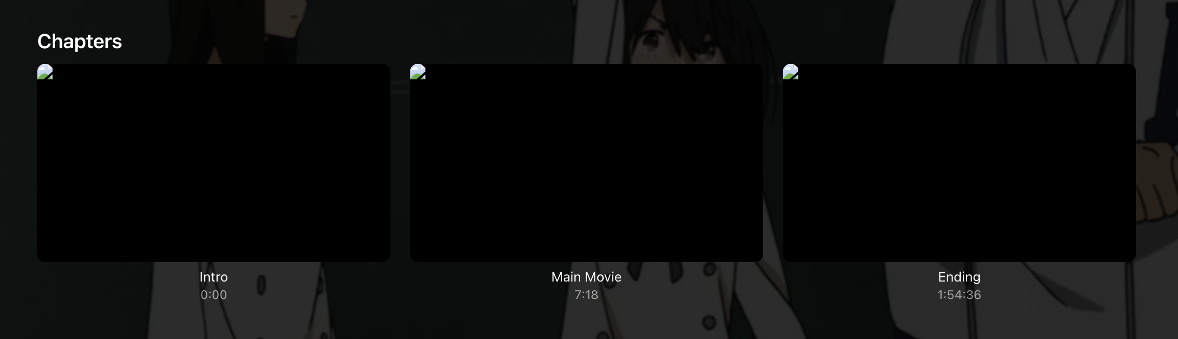

Seems i was wrong, the Video preview thumbnail extraction task is not creating BIF files for the missing BIF files anymore:
just ran the task and it finished quickly

and you can see there are missing BIF files
2026-10-20 11:54:39.879 Info ImageService-0HNPEH25895K8:0000000A: http/1.1 Response 404 to x.x.x.x. Time: 10ms. GET http://x.x.x.x/emby/Items/2036162/Images/Chapter/0?maxWidth=724&tag=59a2fa024a443a87bbc280c4705259dd_0&mediaSourceId=mediasource_2036163&quality=90.
2026-10-20 11:54:39.879 Info ImageService-0HNPEH25895K6:00000002: http/1.1 Response 404 to x.x.x.x. Time: 9ms. GET http://x.x.x.x/emby/Items/2036162/Images/Chapter/2?maxWidth=724&tag=59a2fa024a443a87bbc280c4705259dd_0&mediaSourceId=mediasource_2036163&quality=90.
2026-10-20 11:54:39.879 Error ImageService-0HNPEH25895K8:0000000A: Error processing request

and basically everything has broken ones like
embyserver.txt
don't worry about digging into it, rather then try and figure out what wasn't working/wait for a fix i just asked AI to write something quick that would just create them https://github.com/katbyte/emby-bif-builder
scans the library and figures out what files are missing BIFs, or have corrupted BIFS (1 image or to many there were many) and then can just create them from the file or copy them from JF trickplay folder as it happily has been chugging along creating them for weeks now - bonus it's 640x images work just fine and look noticeably sharper on all my devices
