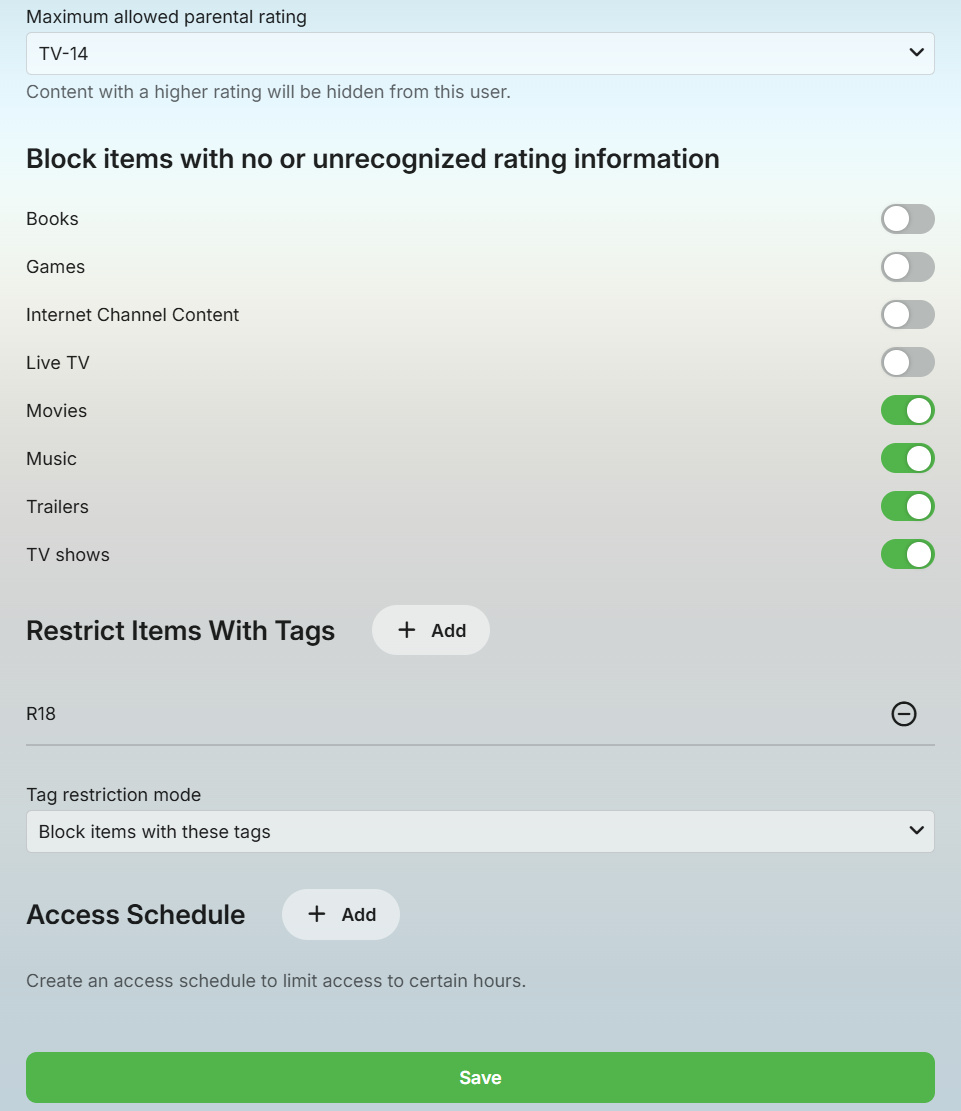

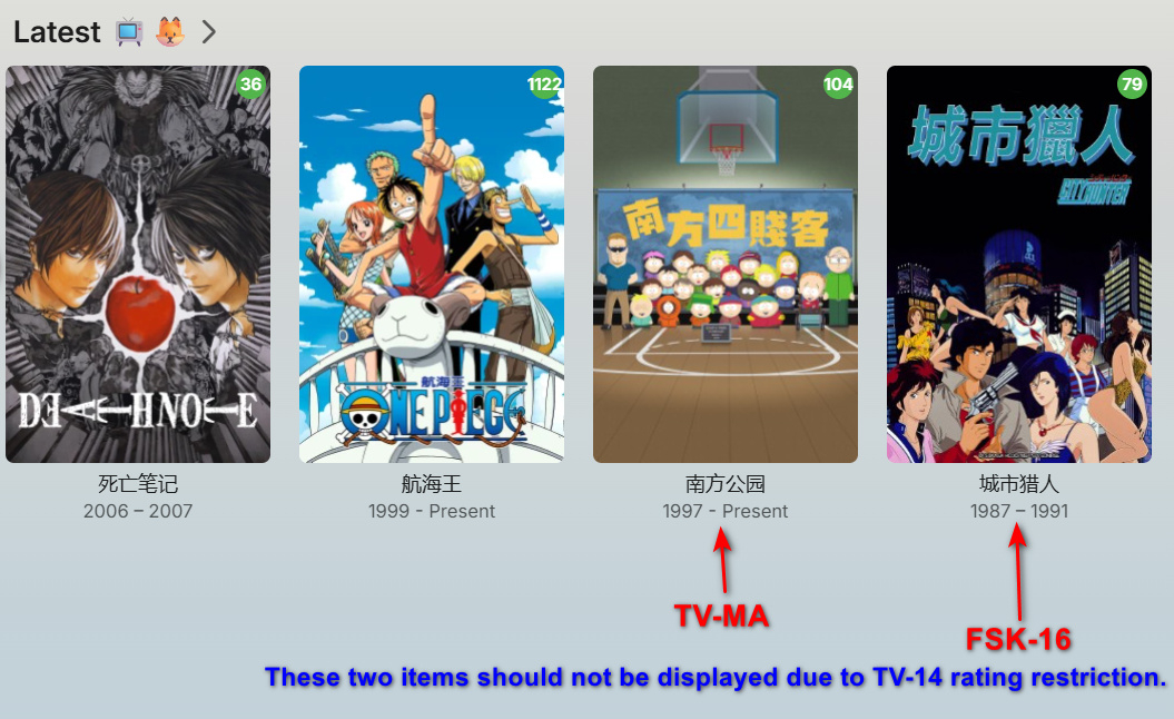

syvcxm 23 Posted August 8, 2025 Posted August 8, 2025 (edited) Assuming that one series is rated TV-MA and the user access restriction is TV-14, this series is not visible in the library view. However, some episodes in this series are rated TV-14, so due to these compliant episodes, it appears in the latest section? This seems unreasonable because if a series is restricted, it should be completely invisible, including the ‘Latest’ section on the home page. server version: 4.9.1.17 beta releated: Edited August 8, 2025 by syvcxm

syvcxm 23 Posted August 8, 2025 Author Posted August 8, 2025 30 minutes ago, Luke said: Hi, did you check the metadata editor for the episodes? They might be overriding the series rating with something different. Another issue related to my feedback: Series entries that are not displayed in the user's library view due to rating control appear on the ‘Latest’ section, and can be opened by clicking on them.

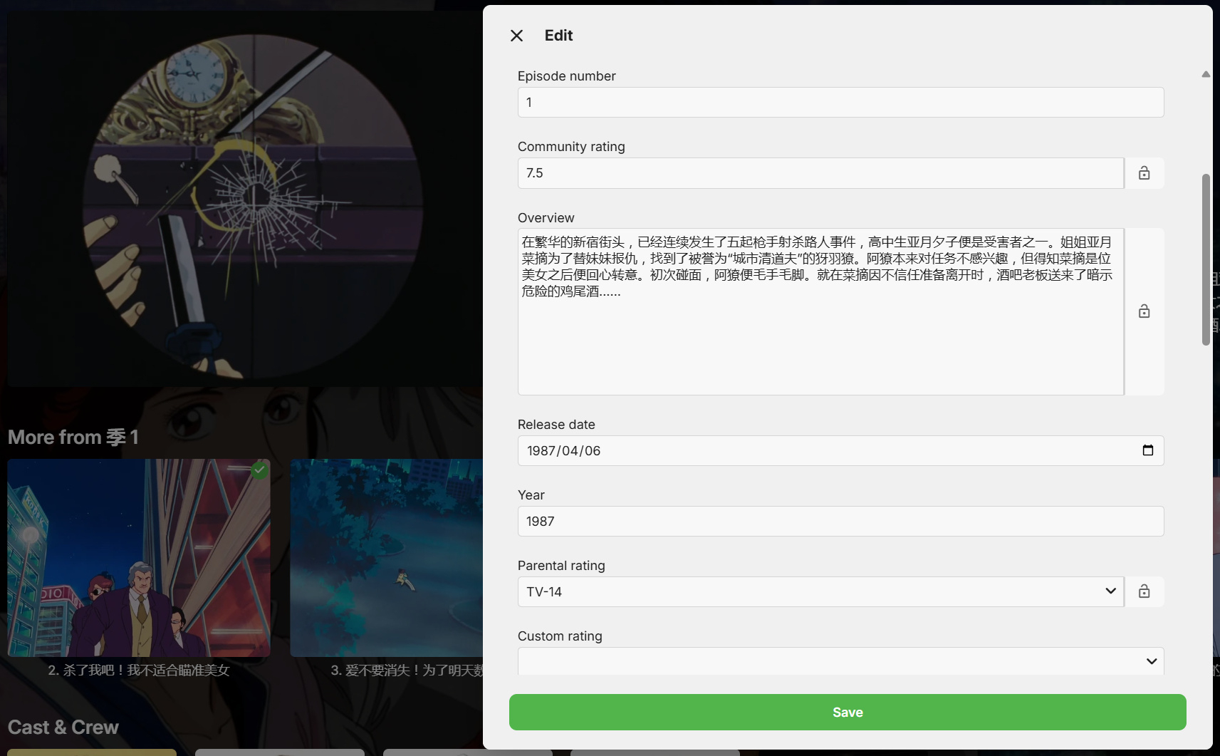

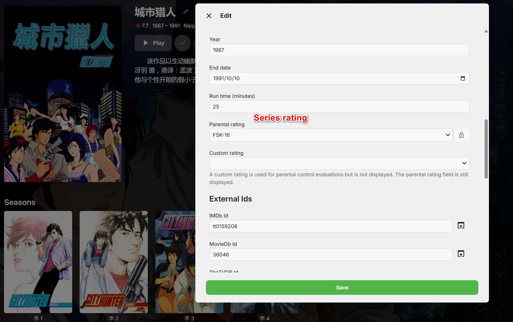

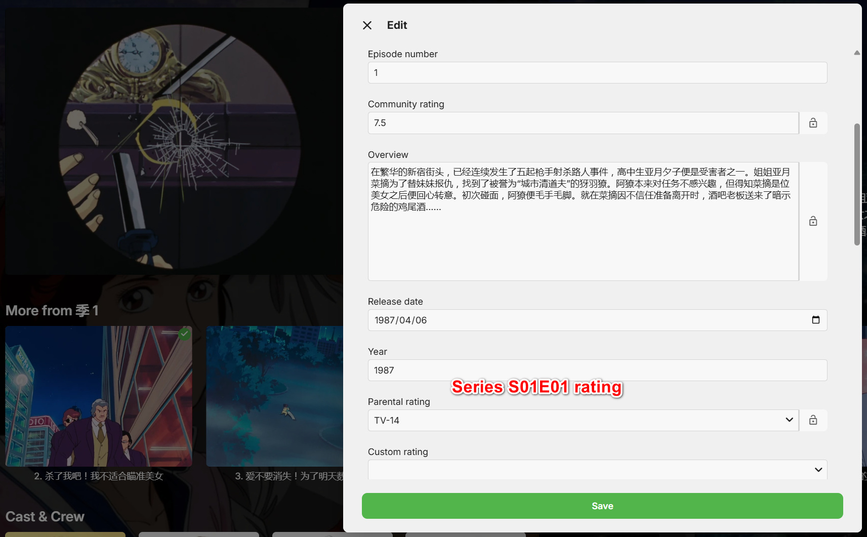

Luke 42290 Posted August 8, 2025 Posted August 8, 2025 27 minutes ago, syvcxm said: No, the series and episodes does not have any custom rating or tag restrictions. Hi, are you sure? I see two different ratings in these screenshots.
syvcxm 23 Posted August 8, 2025 Author Posted August 8, 2025 (edited) 10 minutes ago, Luke said: Hi, are you sure? I see two different ratings in these screenshots. The image1 is the ratings for the series. The image2 is the ratings for the S01E01 of the series. None of them have set custom ratings or restricted tags. The problem now is that this series is not displayed in the library view, but appears on the home page's ‘Latest’ Section and can be opened by clicking on it. Edited August 8, 2025 by syvcxm
