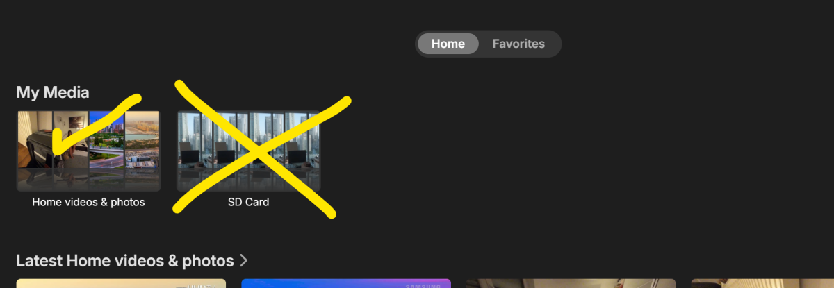

danergo 40 Posted November 7, 2025 Author Posted November 7, 2025 Okay, retested with latest available BETA. Still not working they way IMHO it should: Quote When a library gets unavailable, just hide it I added the SD card's path, then did a rescan. It contained 1 video file. It appeared immediately. Then I've ejected the SD card and did another rescan. See my screenshot. "SD Card" shall be hidden when all of its library paths are invalid: 2025-11-07 13:46:49.677 Info App: ValidatePhysicalRoots start validating 17 DCIM /media/OsmoPocket3/DCIM 2025-11-07 13:46:49.684 Error App: Error in validateChildren for 17 /media/OsmoPocket3/DCIM *** Error Report *** Version: 4.9.2.6 Command line: /opt/emby-server/system/EmbyServer.dll -programdata /var/lib/emby -ffdetect /opt/emby-server/bin/ffdetect -ffmpeg /opt/emby-server/bin/ffmpeg -ffprobe /opt/emby-server/bin/ffprobe -restartexitcode 3 -updatepackage emby-server-deb_{version}_arm64.deb Operating system: Linux version 6.1.99 (fa@jensen) (aarch64-linux-gcc (ctng-1.26.0-129g-FA) 14.2.0, GNU ld (GNU Binutils) 2.43.1) #33 SMP Tue Jan 21 11:32:39 CST 2025 OS/Process: arm64/arm64 Framework: .NET 8.0.11 Runtime: opt/emby-server/system/System.Private.CoreLib.dll Processor count: 4 Data path: /var/lib/emby Application path: /opt/emby-server/system System.IO.DirectoryNotFoundException: System.IO.DirectoryNotFoundException: Could not find a part of the path '/media/OsmoPocket3/DCIM'. at System.IO.Enumeration.FileSystemEnumerator`1.Init() at System.IO.DirectoryInfo.InternalEnumerateInfos(String path, String searchPattern, SearchTarget searchTarget, EnumerationOptions options) at Emby.Server.Implementations.IO.ManagedFileSystem.EnumerateFileSystemInfos(DirectoryInfo dir, Boolean recursive) at Emby.Server.Implementations.IO.ManagedFileSystem.GetFileSystemEntries(String path, Boolean recursive, FileSystemCredentials credentials) at MediaBrowser.Controller.Providers.DirectoryService.GetFileSystemEntriesInternal(String path) at System.Collections.Concurrent.ConcurrentDictionary`2.GetOrAdd(TKey key, Func`2 valueFactory) at MediaBrowser.Controller.Entities.BaseItem.GetFileSystemChildren(IDirectoryService directoryService) at MediaBrowser.Controller.Entities.Folder.GetNonCachedChildren(IDirectoryService directoryService, BaseItem[] collectionFolders, LibraryOptions libraryOptions) at MediaBrowser.Controller.Entities.BaseItem.ValidateChildrenInternal(IProgress`1 progress, CancellationToken cancellationToken, Boolean recursive, Boolean refreshChildMetadata, BaseItem[] collectionFolders, LibraryOptions libraryOptions, Dictionary`2 newItemIds, MetadataRefreshOptions refreshOptions, IDirectoryService directoryService) at Emby.Server.Implementations.Library.LibraryManager.ValidatePhysicalRoots(IProgress`1 progress, IDirectoryService directoryService, CancellationToken cancellationToken) Source: System.Private.CoreLib TargetSite: Void Init() As you can see here, we get a massive and pretty simply-solvable error here. I wish: `validateChildren` to return FALSE when folder is not found. I.e. don't crash to error, just return FALSE. `ValidatePhysicalRoots` to return FALSE, when all `validateChildren` return FALSE. I.e `ValidatePhysicalRoots` shall return TRUE if there is ANY valid child. On "Home" screen, display only libraries having `ValidatePhysicalRoots` as TRUE by default (or adding a new item to library setting: hide is invalid) The problem now is, that old files remain in unavaliable media items as cache, and doesn't gets cleared - maybe because of this error. I'm also attaching the logfile, but it doesn't contain much more valuable info. embyserver (11).txt
Luke 42242 Posted November 13, 2025 Posted November 13, 2025 @danergothe library does not get hidden/removed unless you remove it from Emby library setup. Does that answer your question?
danergo 40 Posted November 13, 2025 Author Posted November 13, 2025 3 hours ago, Luke said: @danergothe library does not get hidden/removed unless you remove it from Emby library setup. Does that answer your question? Hi, @Luke, Yes it answers; however I wish it to be auto-hide as per my previous post. It would be extremely useful, and very easy to solve in beta. I can also write it as a PR.

danergo 40 Posted November 13, 2025 Author Posted November 13, 2025 1 minute ago, GrimReaper said: I would imagine that to be a troubleshooting nightmare, with libraries popping on and off of their own volition and users jumping on forums "My library has disappeared!" My proposition was included: A new option for libraries: "hide if invalid". That could be disabled by default, i.e. NOT hide even if its invalid. So it will not cause any "troubleshooting nightmare" IMHO. (We just have to add a line to log: library X is not showing because all items are invalid). For me it seems much worse to have a library full of invalid thumbnails and folder structures from which none can be opened.
GrimReaper 4896 Posted November 13, 2025 Posted November 13, 2025 10 minutes ago, danergo said: For me it seems much worse to have a library full of invalid thumbnails and folder structures from which none can be opened. My assumption (not necessarily correct one, by any means) is that 99% of users prefer it that way as it'd indicate issue(s) with their mount points/network drives, which is way more common setup that SD cards inserting/removing. But that is completely up to the Devs, you are always welcome to open a Feature Request topic in the respective forum section, as an option it surely cannot hurt, it might get some traction, time will tell. 1
