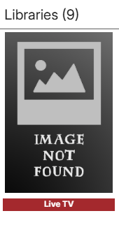

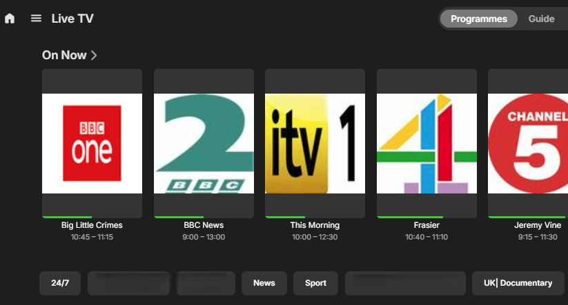

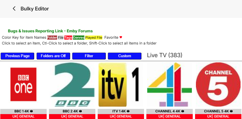

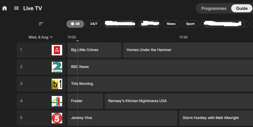

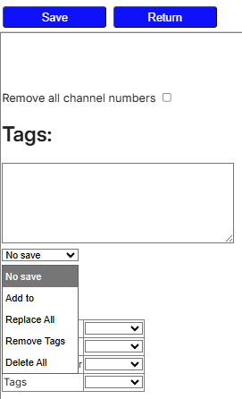

Apotropaic 58 Posted August 6, 2025 Posted August 6, 2025 (edited) For my second use case, my M3U provider includes some set tags which emby will show, but they are not always consistent or match correctly. This is where I use Bulky to remove the ones I don't want and add tags to channels I have selected. When you open the Bulky plugin you should see all your emby libraries. Select the Live TV one. This should then show you all your channels. The text in red shows you the current tag/s already associated with the channel. You can now use shift/control click to select the channels you want to manipulate, select as many as you want here. Then select 'Bulk Edit'. Next you can add a new tag into the Tags box, then using that drop down you can choose to add that new tag to any existing ones, or to replace a tag, remove the tag or to delete them all. Next select the blue 'Save' button and the plugin will make the changes. If you've done the correctly, then when you view your Live TV library the tags will be visible in the 'Programmes and Guide' views. If you select a tag the view will filter to show just those tagged channels. Edited August 6, 2025 by Apotropaic
