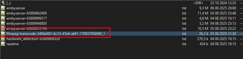

Neminem 1623 Posted August 6, 2025 Posted August 6, 2025 The Transcoding logs should be in the logs folder, if Emby did transcode. Are there any there ? If it did not transcode then its a client issue.
