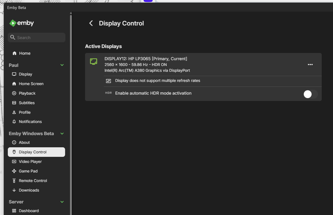

pwhodges 2033 Posted August 5, 2025 Posted August 5, 2025 Click the cog and you'll see: The three-dot menu will bring up various options according to your display (mine's very limited). Paul

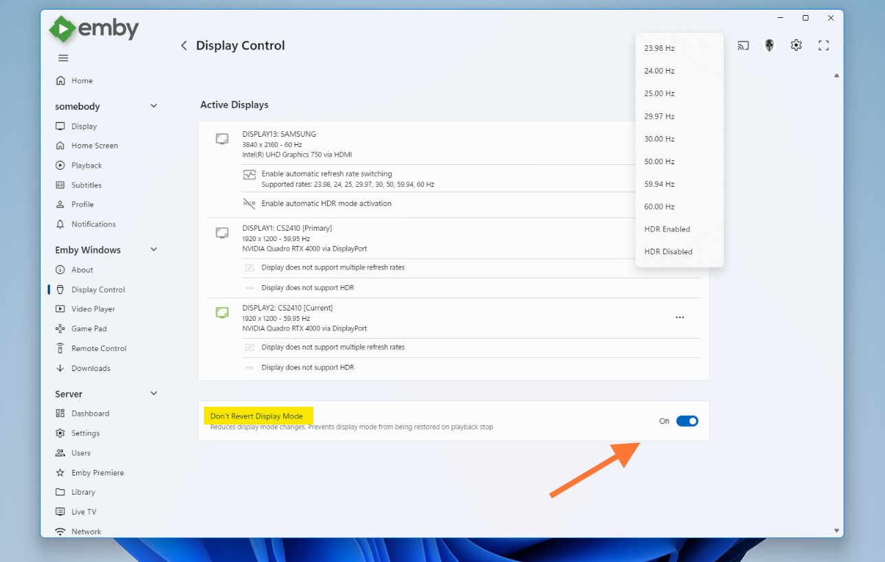

softworkz 5133 Posted August 6, 2025 Posted August 6, 2025 9 hours ago, ALLSTAR1986 said: ok i found it, thanks but after the movie emby stays in 24p and HDR, so emby doesn't turn it off again. There's an option right below.

Solution softworkz 5133 Posted August 6, 2025 Solution Posted August 6, 2025 27 minutes ago, softworkz said: There's an option right below.

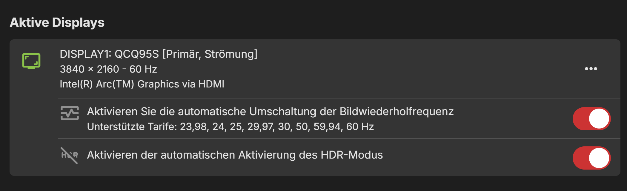

softworkz 5133 Posted August 16, 2025 Posted August 16, 2025 Hm, yea, tat's the latest. Do you have TV mode enabled? Could you please post a screenshot of the whole window (showing the Display Control options)? Can you also please post or PM a log (after visiting this settings page)? You find the logs under About >> Logs Thanks
ALLSTAR1986 15 Posted August 17, 2025 Author Posted August 17, 2025 @softworkzHey, I had the “Do not reset display mode” checkbox selected, but I disabled it to test it out, and now everything is working as it should.
