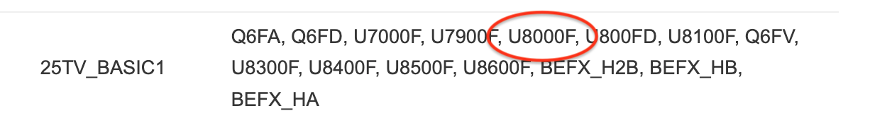

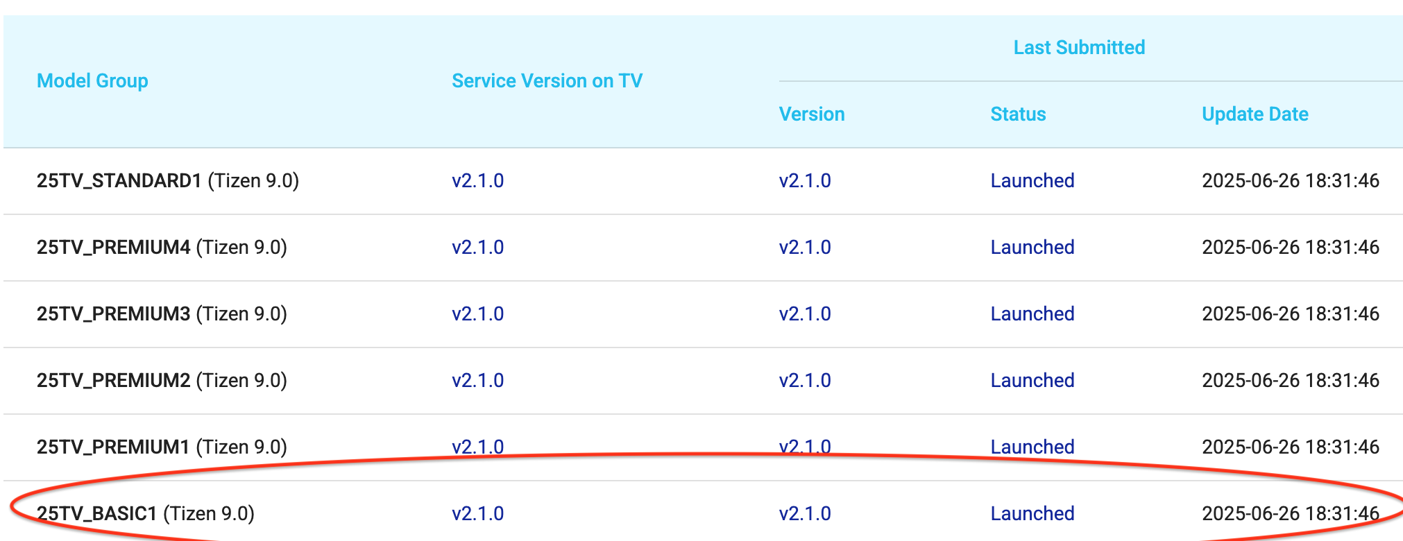

SamES 1084 Posted August 4, 2025 Posted August 4, 2025 3 hours ago, StarFox31 said: Just spoke with Samsung support on this as well. They replied that it is on the "App Developer" and is not an issue on their end. That's a pretty standard answer from them, and not really helpful. It's also not correct, as for new models each year, the initial release is handled by Samsung. Your model is in the 25TV_BASIC1 model group And v2.1.0 has been launched since end of June If you are in the US then I expect you should definitely be seeing it in the app store. Where did you check the region? Are you using a VPN or reverse proxy?
