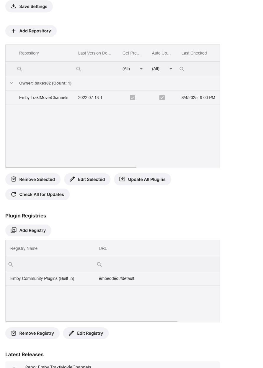

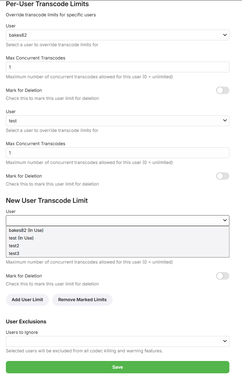

bakes82 167 Posted August 3, 2025 Posted August 3, 2025 On 8/2/2025 at 5:52 PM, yocker said: Love to hear it working! That's an oversight on my part, i will look into making it so the time limit can be changed. Sadly it's not possible to make it so it can be edited on a phone unless you use a browser. The Emby apps are hardcoded with all the buttons and options they have so impossible to change that via a plugin unless the Emby team specifically adds the plugin to the apps. you need to stop using the old html/js way and use the new C# only way and they dictate the layout for the screens, which should make it more mobile friendly.
yocker 1426 Posted August 5, 2025 Author Posted August 5, 2025 On 8/4/2025 at 1:48 AM, bakes82 said: you need to stop using the old html/js way and use the new C# only way and they dictate the layout for the screens, which should make it more mobile friendly. If you mean Embys SimpleUI then that won't fit the plugin.
bakes82 167 Posted August 5, 2025 Posted August 5, 2025 (edited) 1 hour ago, yocker said: If you mean Embys SimpleUI then that won't fit the plugin. Why wont it fit the plugin? Youre not doing anything special that I can see, I do the same things in my codec killer. I find it 10000% easier to manage everything with c# instead of the mix match of js/cs. Plus then if you want to use claude code it seems to handle it better since everything is c# and server side. Its just a little harder to setup since you need to write your own save/load json functions, or just pull their demo app and use that as starting point. You can store stuff in grids too and then use modals if you want to keep things cleaner, i might do that for the user transcodes above but I just want to test the concept first. Edited August 5, 2025 by bakes82

bakes82 167 Posted August 5, 2025 Posted August 5, 2025 10 hours ago, yocker said: I was too fast on the keyboard. What i meant was that it wouldn't make the settings work in the Emby app anyway AFAIK. Also i might be wrong but the live time remaining and loggin might not be possible, i haven't used looked into SimpleUI much so might be wrong. Maybe i will use SimpleUI in the future. I think you’re confusing their one example called “simple” which handles all the saving and etc for you. But the framework itself does more once you go beyond that. The simple is more for quick schedule task configs. My GitHub updater has references for you. https://github.com/bakes82/Emby.GitHubRepoPluginInstall/tree/master/Emby.GitHubRepoPluginInstall You also seem to publish dlls as releases so people could use it to auto update, I added a repo concept so they could point to one json on your repo and it will add the plugins as drop down choices.
