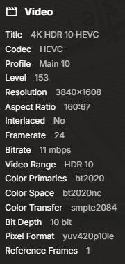

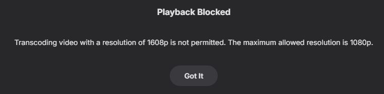

Lessaj 477 Posted November 15, 2025 Posted November 15, 2025 (edited) Hi, I did a quick search of the thread and I didn't see any mention of this particular use case so apologies if I've missed it. I'm using the web client and testing the transcoding resolution blocking with a multi version movie and it seems like it's picking up the details of the 4K version and blocking it, even though I selected the 1080p file for playback. I had my playback setting at 720p 4 Mbps to force a transcode otherwise I end up direct playing the 1080p file. The 4K version can also be direct played in my browser as long as I don't limit the bitrate. Edited November 15, 2025 by Lessaj 1
yocker 1351 Posted November 15, 2025 Author Posted November 15, 2025 1 hour ago, Lessaj said: Hi, I did a quick search of the thread and I didn't see any mention of this particular use case so apologies if I've missed it. I'm using the web client and testing the transcoding resolution blocking with a multi version movie and it seems like it's picking up the details of the 4K version and blocking it, even though I selected the 1080p file for playback. I had my playback setting at 720p 4 Mbps to force a transcode otherwise I end up direct playing the 1080p file. The 4K version can also be direct played in my browser as long as I don't limit the bitrate. That is an oversight from my side. I added changed how it checks the video playing, that should fix the problem. WatchingEye.dll 1
Lessaj 477 Posted November 15, 2025 Posted November 15, 2025 16 hours ago, yocker said: That is an oversight from my side. I added changed how it checks the video playing, that should fix the problem. WatchingEye.dll 437 kB · 0 downloads I've retested with 1.4.8.0 but unfortunately it's still coming up with the same error. Is there anything I can provide to you that might help? Quote 2025-11-15 14:04:35.571 Info App: Loading WatchingEye, Version=1.4.8.0, Culture=neutral, PublicKeyToken=null from /var/lib/emby/plugins/WatchingEye.dll 2025-11-15 14:05:43.790 Info Plugin: [TranscodeMonitor] Blocking transcode for user 'testplay' on client 'Emby Web'. Source resolution '1608p' is over the limit of '1080p'.
yocker 1351 Posted November 15, 2025 Author Posted November 15, 2025 (edited) 4 hours ago, Lessaj said: I've retested with 1.4.8.0 but unfortunately it's still coming up with the same error. Is there anything I can provide to you that might help? This should fix it so that with for example a maximum of 1080p set a multi version video with both 4k and 1080p can't transcode the 4k one but the 1080p one works. It is not made to completely block playback of videos not being transcoded so the 4K movie will still be able to be played if not transcoding. If you don't want users to have access to your 4K content you will have to make a different library for those and limit access. WatchingEye.dll Edited November 15, 2025 by yocker 1
Lessaj 477 Posted November 16, 2025 Posted November 16, 2025 3 hours ago, yocker said: This should fix it so that with for example a maximum of 1080p set a multi version video with both 4k and 1080p can't transcode the 4k one but the 1080p one works. It is not made to completely block playback of videos not being transcoded so the 4K movie will still be able to be played if not transcoding. If you don't want users to have access to your 4K content you will have to make a different library for those and limit access. WatchingEye.dll 436.5 kB · 0 downloads I have retested with 1.4.9.0 and it's working as expected! With playback set to 720p 4 Mbps the 1080p version is now able to be played with transcoding and the 4k is stopped as it should, and with it on auto or max both direct play. Thanks! 1
yocker 1351 Posted November 16, 2025 Author Posted November 16, 2025 2 minutes ago, Lessaj said: I have retested with 1.4.9.0 and it's working as expected! With playback set to 720p 4 Mbps the 1080p version is now able to be played with transcoding and the 4k is stopped as it should, and with it on auto or max both direct play. Thanks! Great to hear and thank you for reporting the issue! 1
