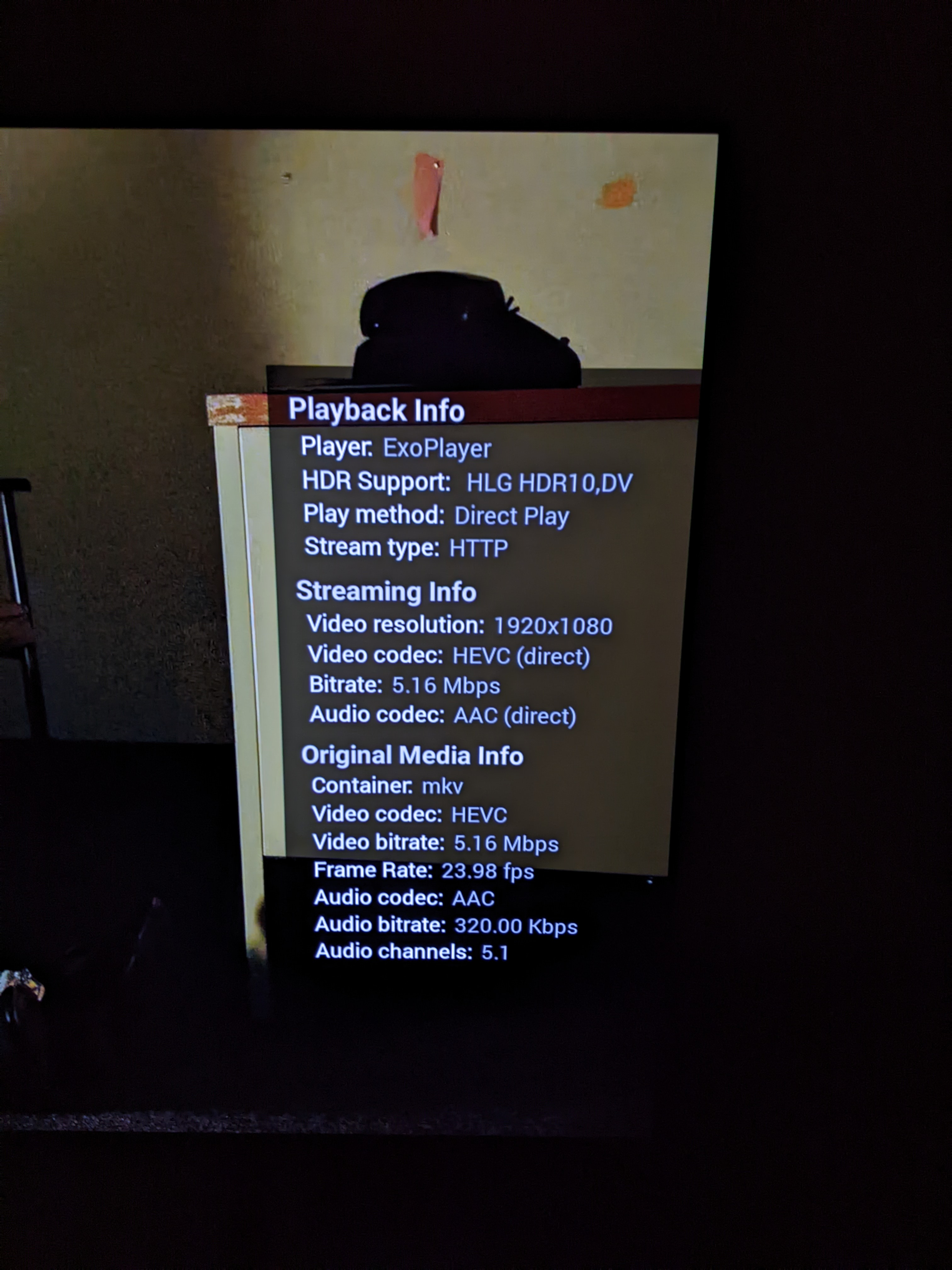

musicmafia 38 Posted July 29, 2025 Posted July 29, 2025 (edited) This may not be an Emby issue, but I would appreciate any help in troubleshooting. This 1080 TV file plays fine on VLC and also plays fine on Emby on my PC browser. On TV (using both Emby and Emby Android TV apps), in certain sections of the files, I get flashing and dim semi-transparent horizontal lines. Again, problem exists in both apps. I am not having a similar flashing/lines issue with any other files. Most content plays fine via the TV apps. I have a strong connection via ethernet and plenty of strength and speed to play 1080 and 4K files. I'm stumped. Here's the stats from TV. Thanks! Edited July 29, 2025 by musicmafia

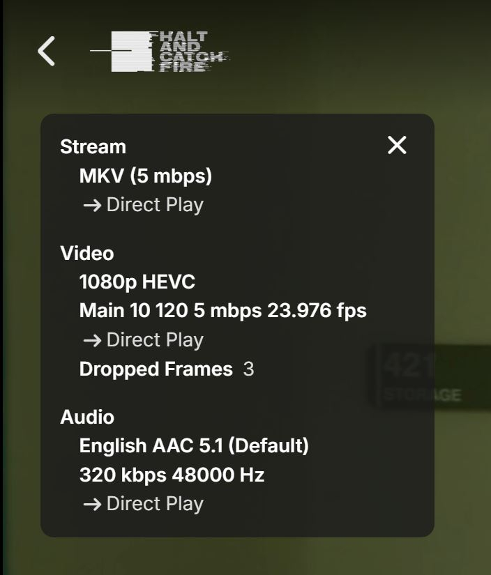

musicmafia 38 Posted July 29, 2025 Author Posted July 29, 2025 Playback is fine on PC via browser. here is the stats from browser same file:
musicmafia 38 Posted July 29, 2025 Author Posted July 29, 2025 3 minutes ago, Luke said: Hi, what exactly is flashing? It's hard to describe. Not the whole screen. It's just flashing in the sections where these thick horizontal bands (not vertical as I first wrote) appear. The bands (which are dim and semi-transparent) and the flashing happen at the same time and only in certain sections of these files. I would think if it was a TV issue, it would do this with other content but it does not. I would also think if it was a TV issue, it would be random, but if I play back the content, the flashing and lines will appear in the same sections of the content. I assumed it was a file issue, but it plays perfectly on PC/browser. It's a mystery to me!
