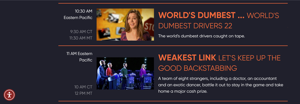

sa2000 695 Posted September 24, 2025 Posted September 24, 2025 (edited) Gracenote have given up on the channel - they have closed it with the note: Quote Unfortunately, we have not received any schedule updates from the channel, and they have been unresponsive. Most recent directions are to log this with a 3 hour offset. I will try with them again. I have set my PC to UTC-7 timezone and with a US vpn IP address, I have accessed https://watchroar.com/schedule/ They show their schedule in "Eastern Pacific" timezone. eg today it shows Are these times correct for Phoenix Arizona ? I tried web timezone conversion tools and I got same time for Eastern Pacific and Phoenix time. The gracenote schedule shows these 10:30 amd 11:00 am airings as being 07:30 am and 08:00 am phoenix time Update: Ah ... The screen also has MT Timezone - so are the MT times correct for Phoenix for today's channel airings? Edited September 24, 2025 by sa2000
Furmantation 6 Posted September 24, 2025 Author Posted September 24, 2025 Thank you. Apologies, I am just getting to this now. If you'd like to send me a couple for later today or tomorrow, I can check the schedule - but from what I see in the screenshot, I have no idea what Eastern Pacific is!?!? We are currently the same time as Pacific (think California) and 3 hours behind Eastern (think New York). The CT / MT times appear correct as we are 2 hours behind Central time currently. (All of this changes when Daylight Saving Time change occurs. We don't change in Arizona, so at that point we are one hour ahead of Pacific and two hours behind Eastern).

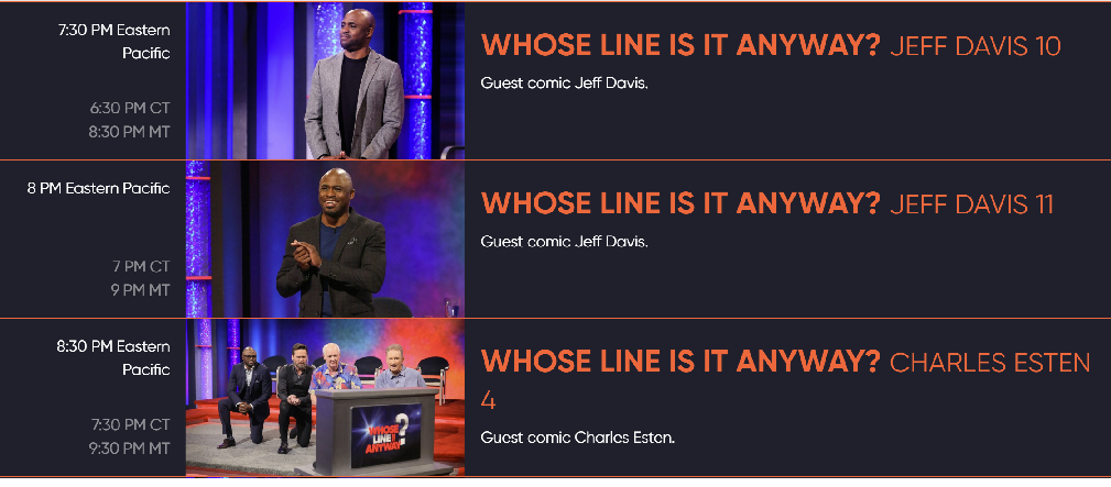

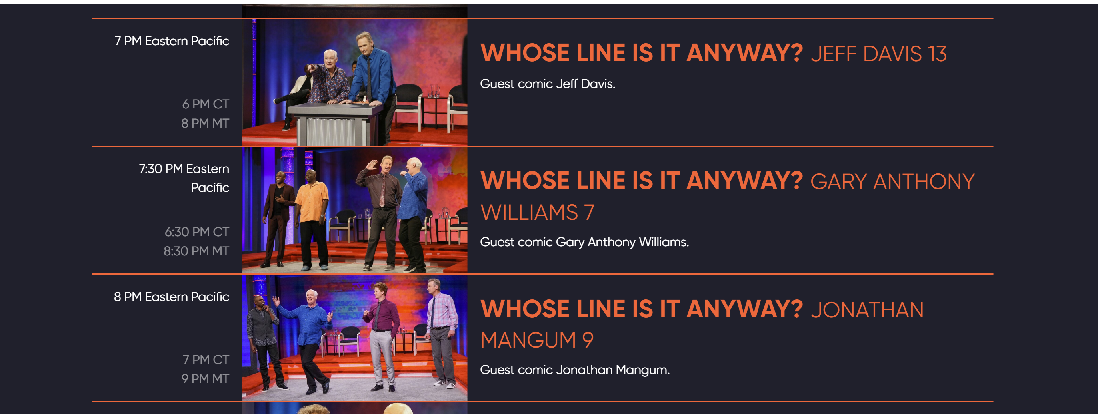

sa2000 695 Posted September 24, 2025 Posted September 24, 2025 12 minutes ago, Furmantation said: The CT / MT times appear correct as we are 2 hours behind Central time currently. (All of this changes when Daylight Saving Time change occurs. We don't change in Arizona, so at that point we are one hour ahead of Pacific and two hours behind Eastern). OK just tell me if the MT airing times showing in the schedule for https://watchroar.com/schedule/ are correct for Phoenix Arizona Here are 3 for today MT 20:30 Jeff Davis 10 MT 21:00 Jeff Davis 11 MT 21:30 Charles Esten 4 and for 25 September MT 20:00 Whose Line is it anyway - Jeff Davis 13 MT 20:30 Gary Anthony Williams 7 MT 21:00 Jonathan Magnum 9 If you are on MT time and the airings in the https://watchroar.com/schedule/ for MT match what is being aired then i can give gracenote examples of what is wrong

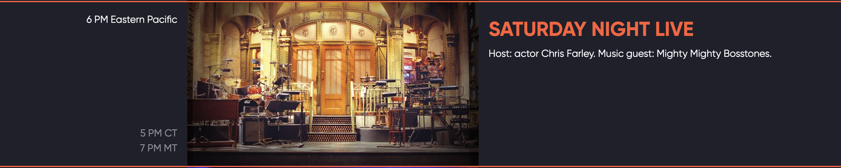

Furmantation 6 Posted September 25, 2025 Author Posted September 25, 2025 There is both MST and MDT. Most of Arizona (including Phoenix) is on MST and does not follow daylight saving time (there is a small portion of Arizona that does Daylight Saving in the Navajo nation and it is currently on MDT). In MST, where I am, the current time is 18:22. MDT is currently at 19:22. I believe those screenshots are correct for the timezone they refer to as Eastern Pacific. I currently have Saturday Night Live with Chris Farley on the TV, which matches the 6PM Eastern Pacific time. 1
sa2000 695 Posted September 25, 2025 Posted September 25, 2025 8 hours ago, Furmantation said: here is both MST and MDT. Most of Arizona (including Phoenix) is on MST and does not follow daylight saving time (there is a small portion of Arizona that does Daylight Saving in the Navajo nation and it is currently on MDT). In MST, where I am, the current time is 18:22. MDT is currently at 19:22. I believe those screenshots are correct for the timezone they refer to as Eastern Pacific. I currently have Saturday Night Live with Chris Farley on the TV, which matches the 6PM Eastern Pacific time. Thank You I have re-opened the gracenote issue with more examples
