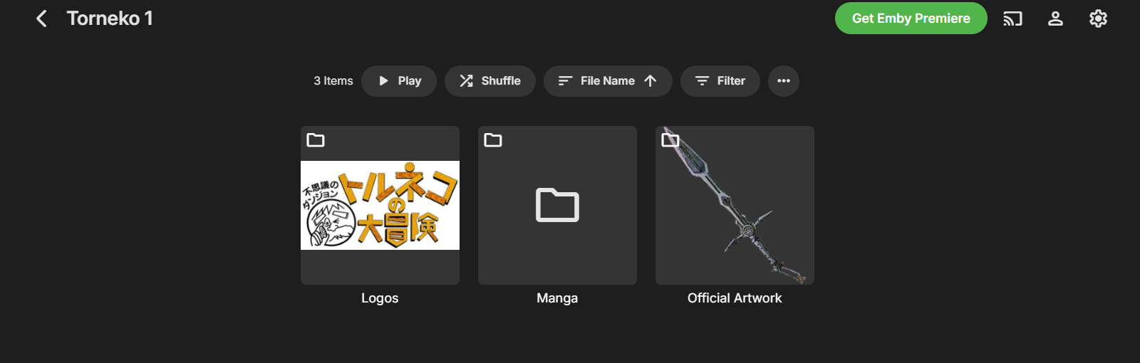

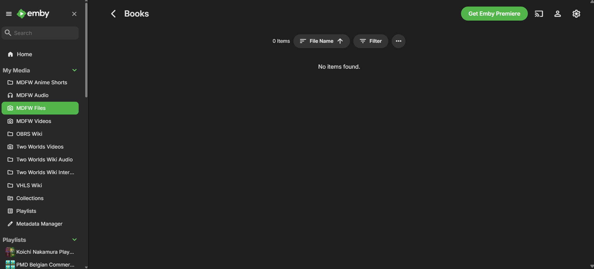

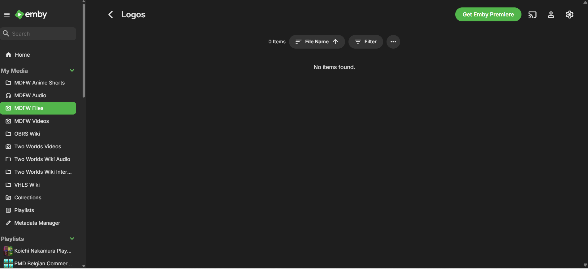

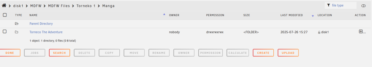

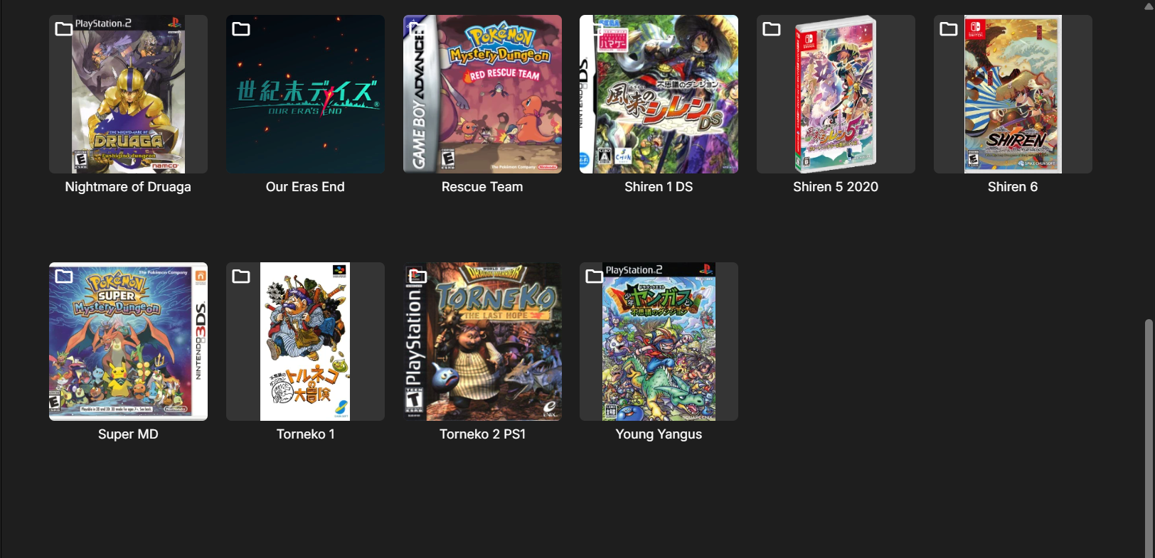

MDFWJubilee 1 Posted July 26, 2025 Posted July 26, 2025 As the title implies. I upload files, and they will randomly not show up. Real time monitoring is enabled. They work for other folders. I've experienced this with PNG files, and video files. For the videos, uploading them a second time seemed to do the trick, after which, I was able to delete the original, and rename the file in-app. Deleting the original file and renaming it didn't solve the issue. Here's a video showing the setup, how it arbitrarily works for some files, and not for others.

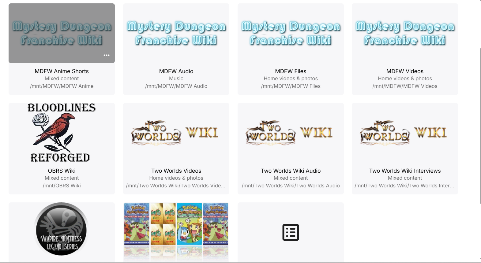

Luke 42243 Posted July 26, 2025 Posted July 26, 2025 OK. What folder paths are added to each library? The most likely cause is the same folders being re-used in different libraries with different content types.

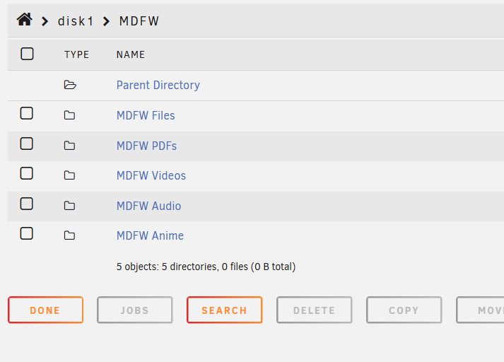

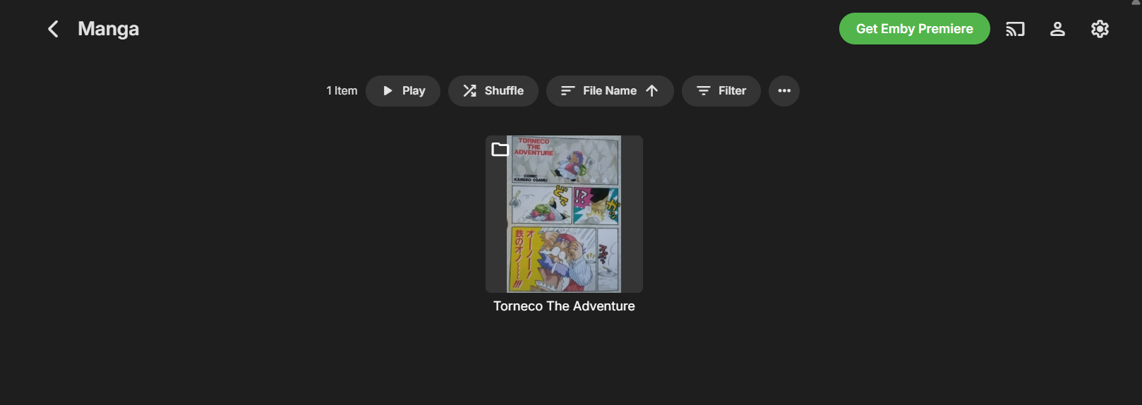

MDFWJubilee 1 Posted July 26, 2025 Author Posted July 26, 2025 (edited) That's not the case, I looked into it earlier, when I was testing image support, and found out the PDFs weren't showing up. So I searched for a solution and found a comment by you, on these forums, that stated PDFs can't share folders for some reason. So everything has its own folder structure. I haven't created the PDFs folder yet. (In the emby setup, it exists in the server files, but remains unused.) MDFW Files has its own folder, set to the "home media" content type. Each game has its own sub folder under "MDFW Files", and in one case, a manga has its own sub-folder for the game, and it works fine. Edited July 26, 2025 by MDFWJubilee

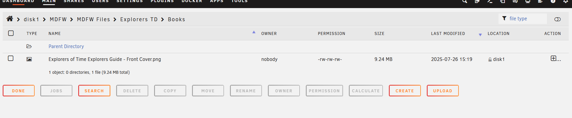

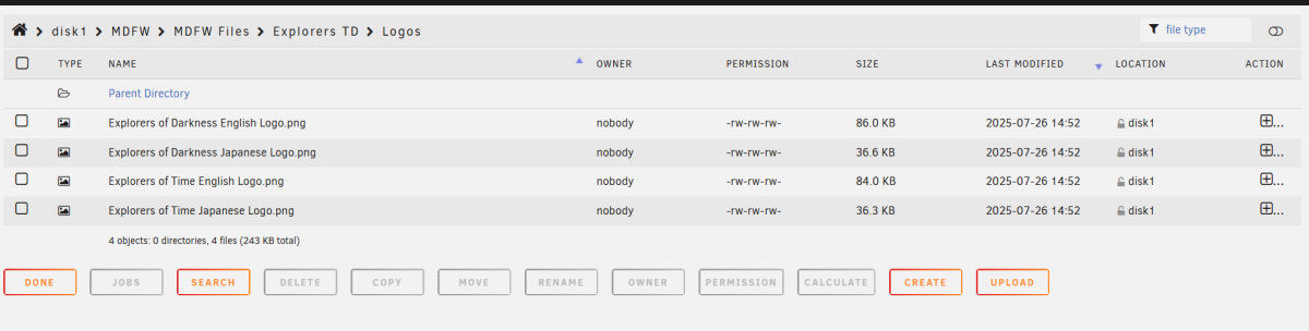

rafinha 8 Posted July 27, 2025 Posted July 27, 2025 The permissions seem to be ok qbittorrent writes using: -rw-rw-r-- 1 nobody users nzb writes using: -rwxrw-rw- 1 nobody users I tried to chmod 755 -R the movie/MovieName/ and scan again, but it does not show in the movies library.
