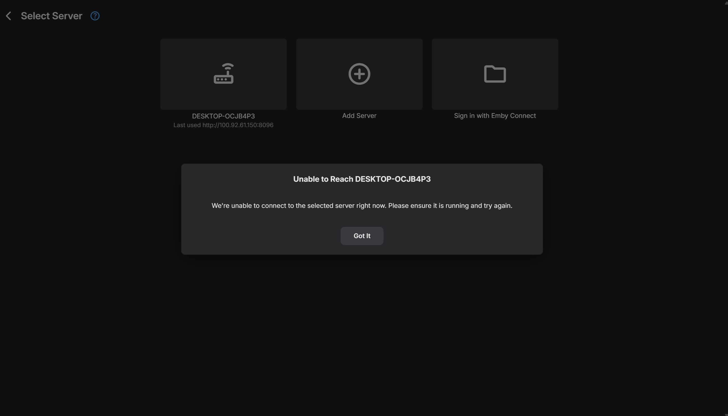

globaltarheel8 0 Posted July 28, 2025 Author Posted July 28, 2025 Logs attached. Here I have NordVPN Meshnet enabled. I am outside of my home network. When I do not have NordVPN Meshnet enabled, I cannot even access the server and receiver error. screenshot attached. ffmpeg-transcode-69f443e5-a205-47d0-ad91-34337a59d09d_1.txt embyserver.txt ffmpeg-transcode-87175201-cf1e-4d87-ae06-3968ba9ad1ac_1.txt

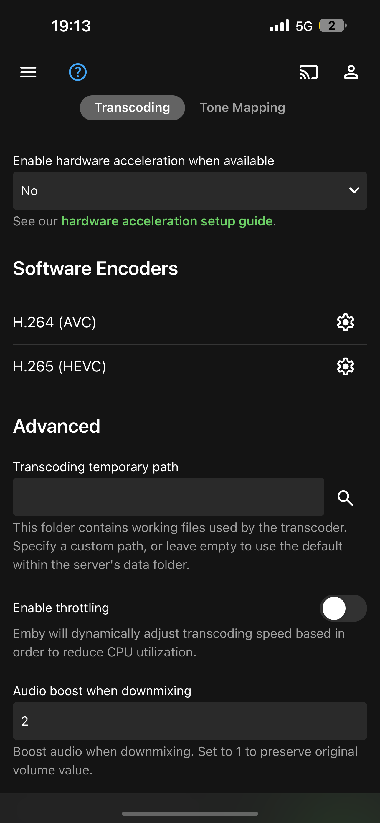

Luke 42287 Posted August 1, 2025 Posted August 1, 2025 On 7/28/2025 at 5:05 PM, globaltarheel8 said: Ok but what about when vpn is enabled and it still gives issues 99% of the time? As a test, if you disable hardware transcoding in server transcoding settings, how does that compare?

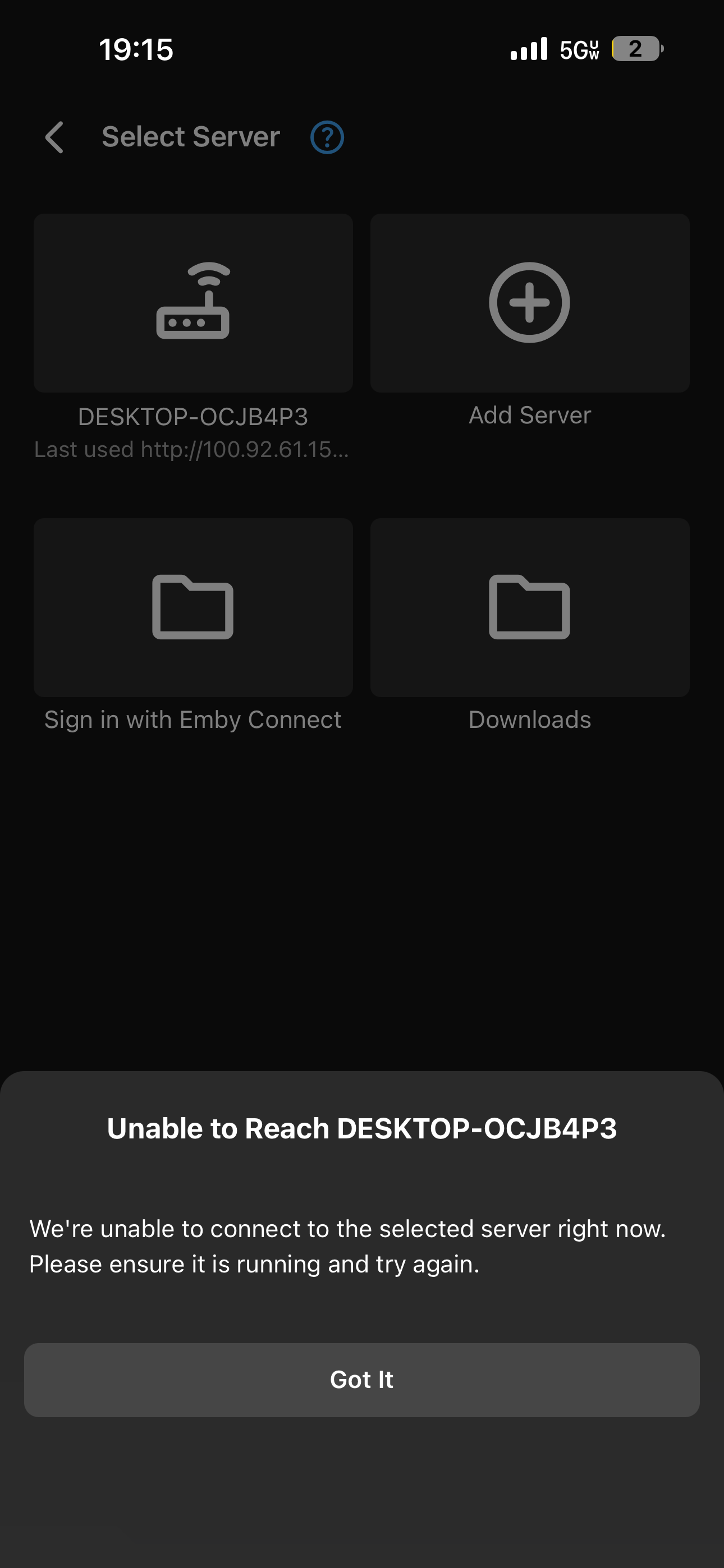

globaltarheel8 0 Posted August 1, 2025 Author Posted August 1, 2025 Thanks. Are you referring to this? I’ve set it to no. It doesn’t seem to have made a difference. Also, the only way I can get access outside of my home network is when using nordvpn mesh net. When mesh net is off, I get the attached error.
Luke 42287 Posted August 14, 2025 Posted August 14, 2025 @globaltarheel8 OK we are looking into it. Thanks,. Quote When mesh net is off, I get the attached error. I would imagine that when the VPN is off you would connect using a different remote address than when it is on, right?

Nathanael 7 Posted November 9, 2025 Posted November 9, 2025 The IP 100.92.x.x is your WAN IP? Are you behind a CGNAT? If so, you need a third party to route the connection.
pwhodges 2039 Posted November 9, 2025 Posted November 9, 2025 100.92.x.x is specifically in the cgNAT range. Tailscale is often suggested to get around this. Paul 1
