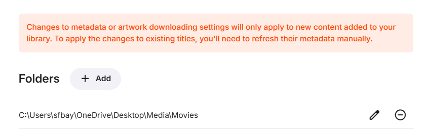

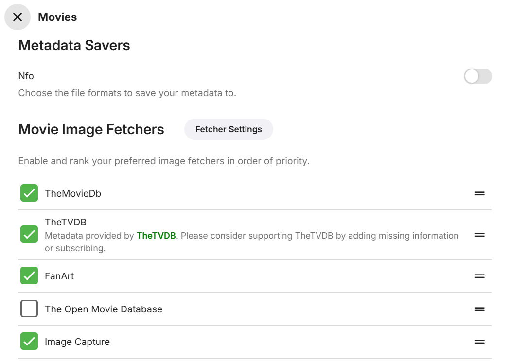

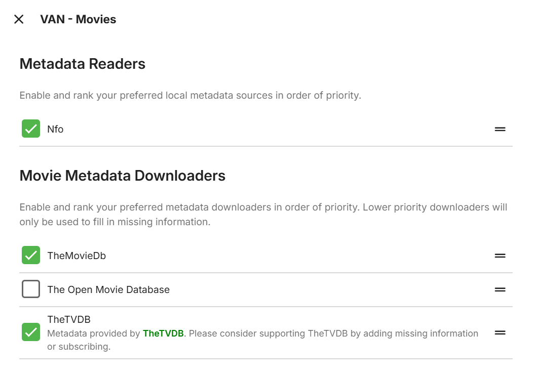

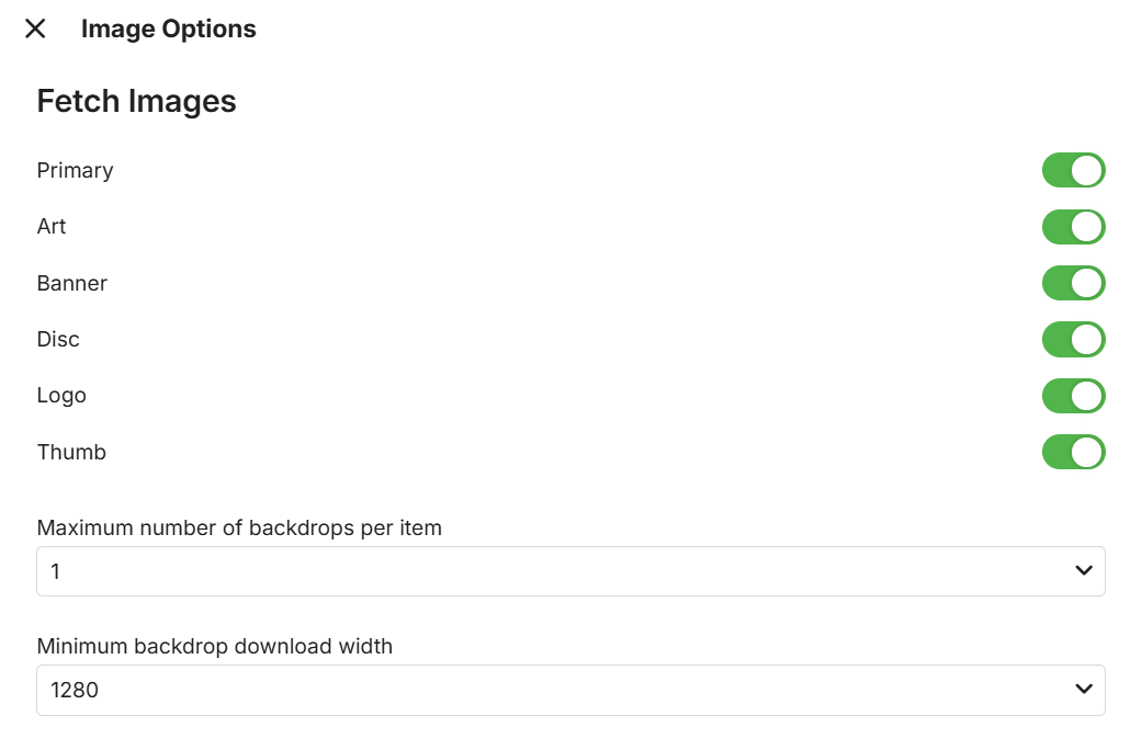

spincycle999 12 Posted July 22, 2025 Posted July 22, 2025 I added a new movie library, no metadata found. I tried to manually identify, no results found. I've tried removing and re-adding the library and refreshing metadata, no luck. Attached please find screenshots of setup, as well as latest log. Direction would be greatly appreciated. Thank you in advance! FYI, I also added a TV show library, data was returned. embyserver.txt

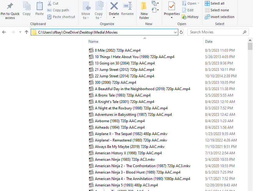

pwhodges 2033 Posted July 22, 2025 Posted July 22, 2025 Let us see the folder structure and file names for the library - also the name of the folder which you specified in the Emby library setup. Paul
pwhodges 2033 Posted July 22, 2025 Posted July 22, 2025 Emby expects each movie to be in a folder with the movie's name (and preferably date); the folder name is then what is looked up in the metadata databases (not generally the file name). Paul 1
Luke 42233 Posted July 23, 2025 Posted July 23, 2025 Your naming is mostly OK. The real issue is that all outgoing requests to MovieDb are timing out and failing. Could you have something blocking those outgoing requests?
