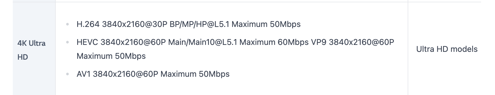

SamES 1084 Posted July 22, 2025 Posted July 22, 2025 You've got a bitrate limit set somewhere, so the server should be transcoding the video, but you've disabled video transcoding so it's just copying all the streams to a new container and trying to DirectStream (and ignoring the bitrate limit) which is all a bit pointless and probably causing issues. First, please try and find where the bitrate limit is being set and remove it if possible. Then, I would try enabling transcoding for video playback in the user profile so that the server can work the way it should be. With it turned off, you will introduce other issues and it will make it hard for us to troubleshoot. Is the server remote, or is it on the same local network as the TV? Keep in mind that you are trying to play a >60Mb/s file, and the TV's network port only supports 100Mb/s. There is overhead in the network transmission process, so you a probably getting close to the limits. A good WiFi signal will actually support higher rates than ethernet. Finally, you are trying to play files that exceed the TV's specifications. That doesn't mean that it won't work, but you need to be aware of the limitations. https://webostv.developer.lge.com/develop/specifications/video-audio-220
