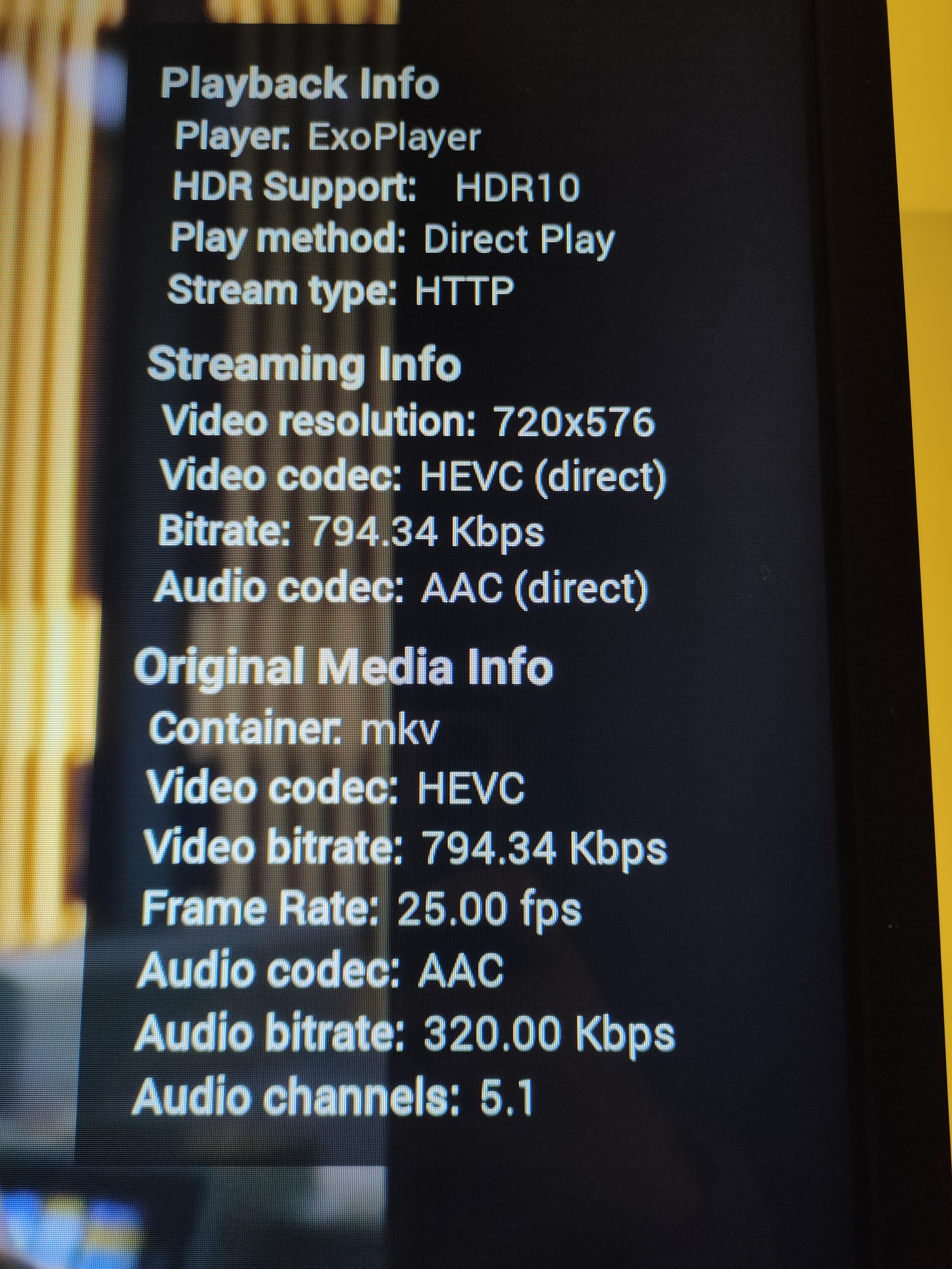

bastionntb 20 Posted July 17, 2025 Posted July 17, 2025 (edited) So long story, about a couple months ago, some devices were experiencing a stuttering/laggy/choppy playback. This was mainly noticeable on the Android app, this was not present on Android TV app. Thing is, you could easily fix it, simply change the bitrate to another one. Any other bitrate would work. Even if it was higher than what it started on. The last was experienced on DirectPlay. I've seen a few threads about it here, but no answers were resulted in the posts. Fast forward, I'm setting up a new server, but now the problems are worse. New server, new storage, etc. I've tried switching the quality back and forward like I mentioned, and it works sometimes. But it's needing me to do it like 3/4 times for stable playback. I have log debug log files and DirectPlay log file as well attached. Additionally, I did a speed test of the storage. From the server that is hosting Emby, to the mounted storage that is hosting the files, I'm getting 367MiB/s read speed. Which I think should be sufficient enough for playback of a 2Mbps encoded video. This is now being seen across all devices, which makes me think it's a combination of the previous issue, and something new. The server is Arch Linux, using Docker compose for the Emby server, on the latest version. So any help would be appreciated. Here are the rotated log files. Edit: Should also mention that the host has 1GB up and down, so I doubt that is also the issue. ffmpeg-directstream-e25f0db8-302f-4f1a-a35d-13aec1ae0af3_1.txt embyserver.txt Edited July 17, 2025 by bastionntb

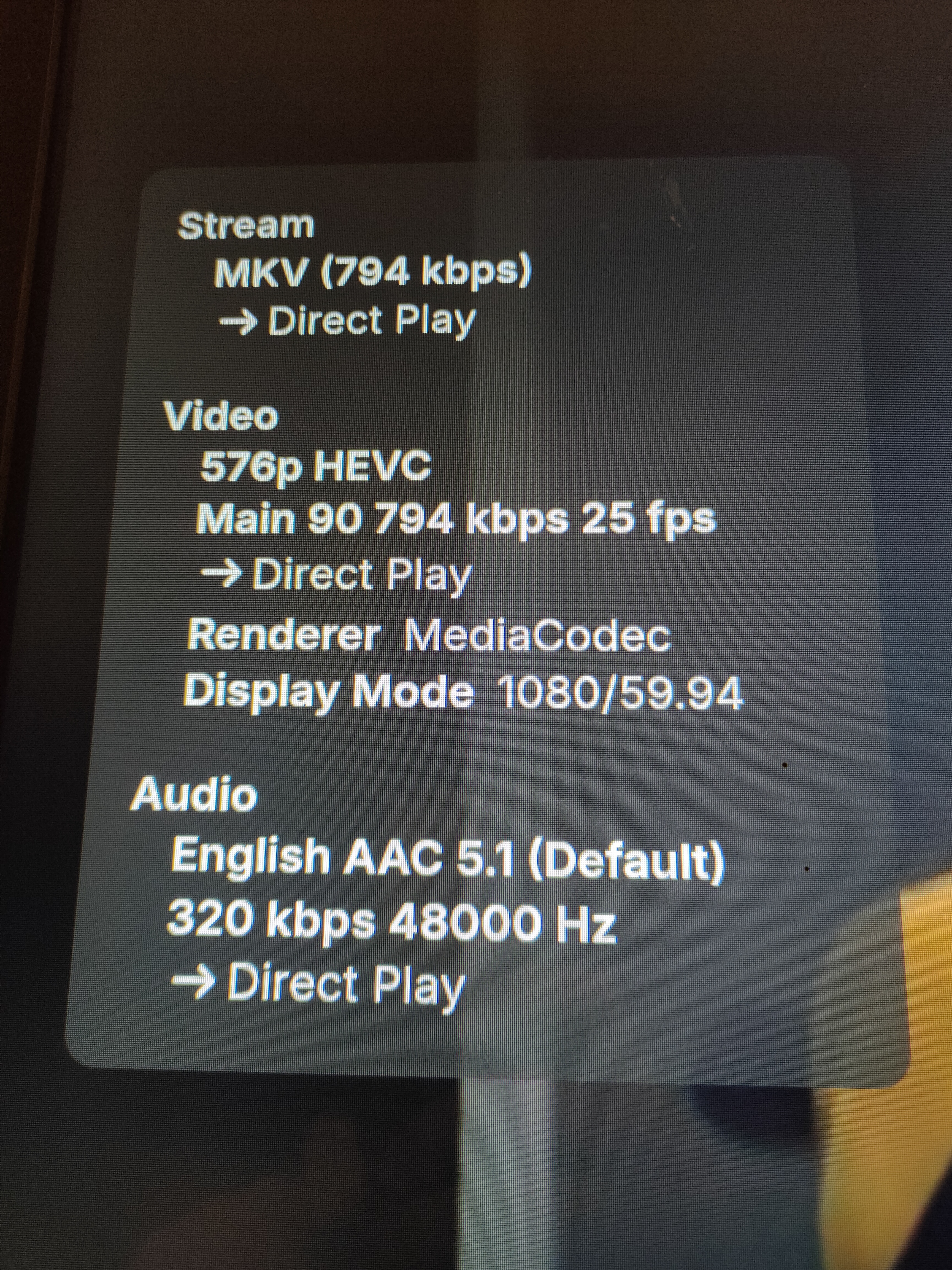

ebr 16334 Posted October 6, 2025 Posted October 6, 2025 Hi. Is what you are seeing actually frame-judder? I'm noticing that the content is 25p and the display is at 59.94.
TTLucian 6 Posted October 6, 2025 Posted October 6, 2025 Switching to 50Hz makes absolutely no difference. Tested on 3 TVs Sony, LG and Samsung. Exactly the same problem on all TVs and devices enumerated above. Emby for TV works fine, Emby for Android doesn't. 1
