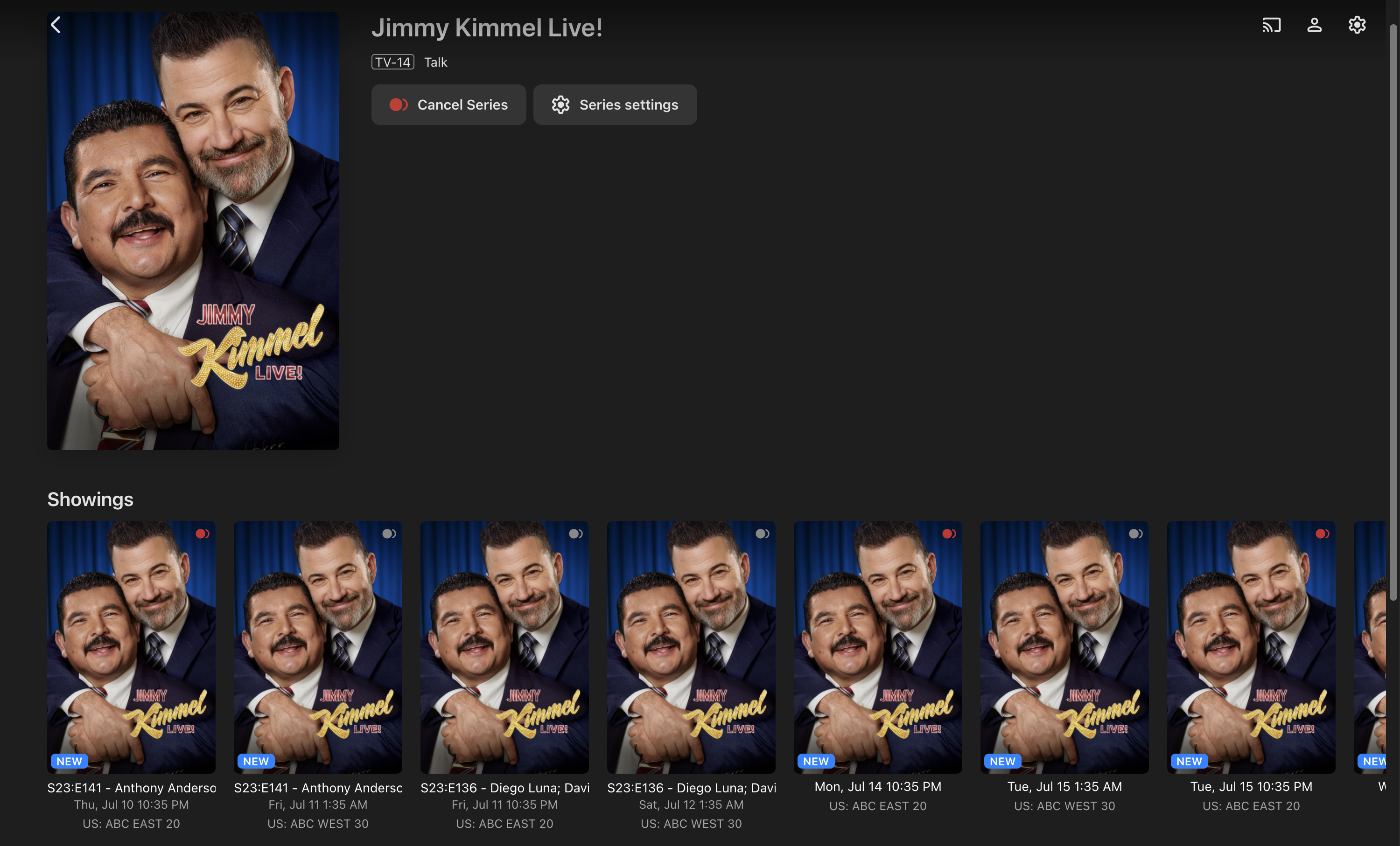

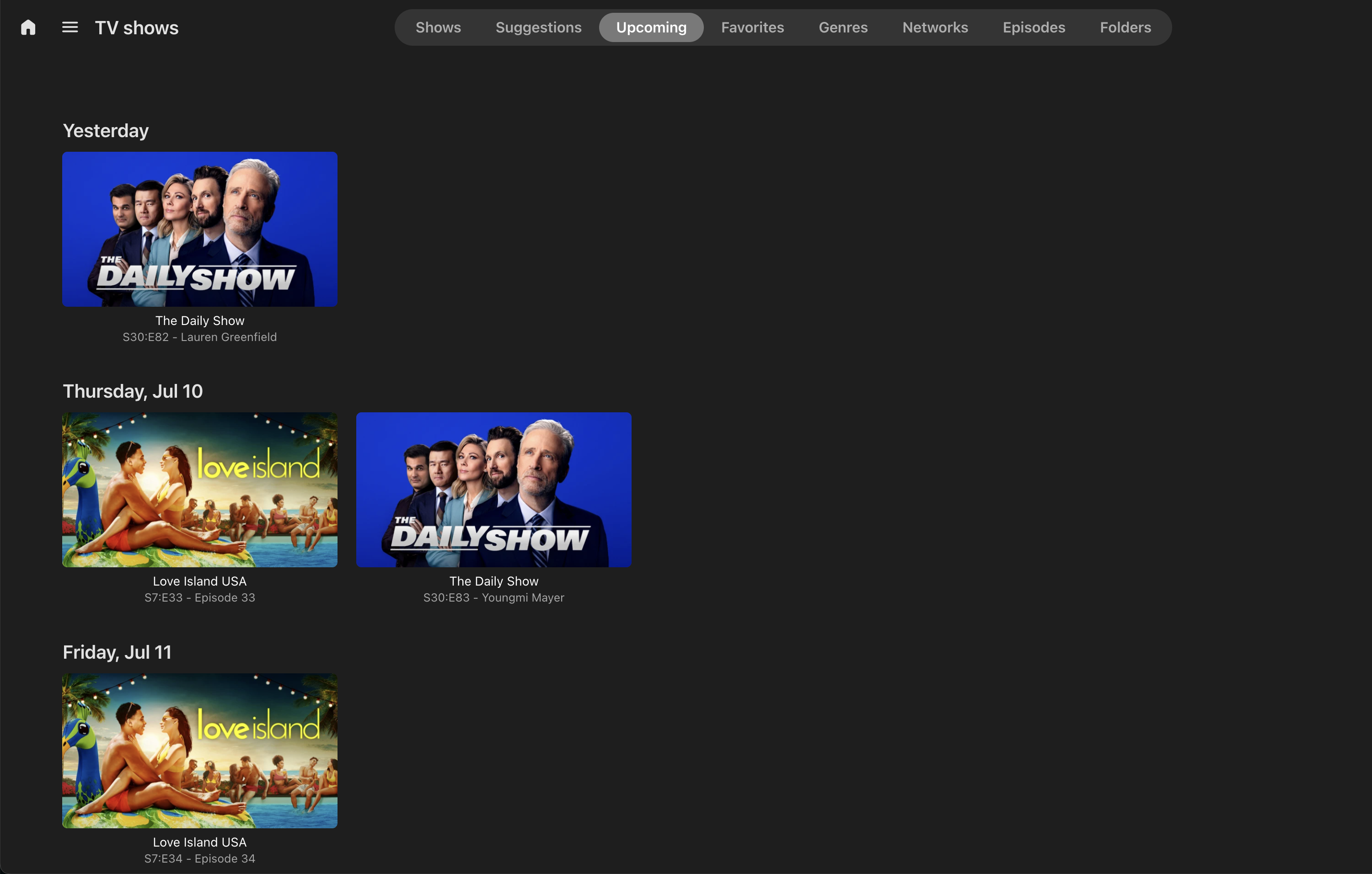

arooni 2 Posted July 11, 2025 Posted July 11, 2025 background: i deleted all my existing libraries and recreated them being careful not to have overlapping folders. Use case: record new episodes of jimmy kimmel live, set it up with new recordings. looking below it looks like it should record tonight (thursday), but doesn't plan on doing that tomorrow. yet when we look in upcoming, it doesn't seem like emby is planning on recording either the thursday/friday showing, in fact, none of the jimmy kimmel live at all. why not? attached is the log embyserver (4).txt

Luke 42237 Posted July 11, 2025 Posted July 11, 2025 1 hour ago, arooni said: embyserver (4).txt 2.42 MB · 0 downloads OK this upcoming section is just a listing of what's airing soon according to TVDB. It's not in any way connected to your dvr. To see your recording schedule, I would use the Live TV section.
