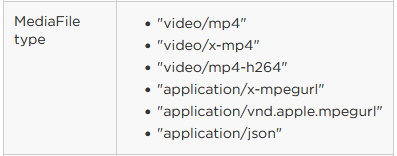

speechles 2062 Posted July 10, 2025 Posted July 10, 2025 TranscodeReasons=ContainerBitrateExceedsLimit TranscodeReasons=ContainerBitrateExceedsLimit,DirectPlayError&allowVideoStreamCopy=false TranscodeReasons=ContainerBitrateExceedsLimit,DirectPlayError&allowVideoStreamCopy=false TranscodeReasons=ContainerBitrateExceedsLimit,DirectPlayError TranscodeReasons=ContainerBitrateExceedsLimit,DirectPlayError&allowVideoStreamCopy=false TranscodeReasons=ContainerBitrateExceedsLimit,DirectPlayError&allowVideoStreamCopy=false The allowVideoStreamCopy being added to the end would only happen if there was an actual error or you used Playback Correction. The ffmpeg logs only get created when transcoding happens. Direct play logs aren't created. header("Content-Type: application/vnd.apple.mpegurl"); The Roku doesn't understand the application type. Are these headers you are creating? header("Content-Type: application/x-mpegURL"); It might work if instead you sent the content type as this.

Luke 42241 Posted July 10, 2025 Posted July 10, 2025 4 minutes ago, speechles said: The part with "Headers: Content-Type=application/vnd.apple.mpegurl" at the end there. Roku cannot play this type of content-type. Thats why I was asking how are these headers being generated? Can you correct them? Where are you seeing that?
speechles 2062 Posted July 11, 2025 Posted July 11, 2025 (edited) 27 minutes ago, Luke said: Where are you seeing that? Quote 2025-07-10 08:42:12.875 Info DynamicHlsService-0HNDU6BCRQMUO:00000001: http/1.1 Response 200 to 0.0.0.0. Time: 2ms. GET /emby/videos/1737367/live.m3u8?DeviceId=9a0a5c1b-60f1-5bda-8ba0-4e130dc3b5ea&MediaSourceId=c510a109b483718d5df50c55b41602ca&PlaySessionId=c20baf9d15c74b6a88fab0e51a75f448&api_key=16280f4e38f64e1dbbfa4401820a63cb&LiveStreamId=06044cf0e6f93cdae5f285c9ecfaaeb4_01413a525b3a9622ce6fdf19f7dde354_c510a109b483718d5df50c55b41602ca&VideoCodec=h264,hevc,mpeg2video&AudioCodec=ac3,aac,mp2,mp3,eac3,flac,vorbis,lpcm&VideoBitrate=34872074&AudioBitrate=127926&MaxWidth=3840&MaxHeight=2160&AudioStreamIndex=1&TranscodingMaxAudioChannels=8&SegmentContainer=ts&SegmentLength=3&MinSegments=1&AllowInterlacedVideoStreamCopy=True&BreakOnNonKeyFrames=True&SubtitleStreamIndexes=-1&ManifestSubtitles=vtt&h264-maxrefframes=16&h264-videobitdepth=8&h264-maxframerate=30&h264-profile=high,main,baseline,constrainedbaseline&h264-deinterlace=true&h264-level=41&h264-videorotation=0&mpeg2video-videorotation=0&mpeg2video-maxframerate=30&mpeg2video-deinterlace=true&hevc-videorotation=0&hevc-maxframerate=30&hevc-codectag=hvc1,hev1,hevc,hdmv,dvh1,dvhe&aac-audiochannels=6&eac3-audiochannels=8&ac3-audiochannels=6&flac-audiochannels=6&lpcm-audiochannels=6&mp3-audiochannels=2&mp2-audiochannels=2&vorbis-audiochannels=6&TranscodeReasons=ContainerNotSupported. Headers: Content-Type=application/vnd.apple.mpegurl, Date=Thu, 10 Jul 2025 12:42:12 GMT, Server=UPnP/1.0 DLNADOC/1.50, Cache-Control=no-cache, no-store, no-transform, must-revalidate, Content-Encoding=br, Expires=-1, Pragma=no-cache, no-store, no-transform, must-revalidate, Vary=Accept-Encoding, Content-Length=259, Cross-Origin-Resource-Policy=cross-origin, Private-Network-Access-Name=JellyMedia Server, Private-Network-Access-Id=f31029750f7d423d9853ffc34d483ba8 In his Emby Server logs. The Roku supports all these content-type and that is among them. His Roku is saying the container isn't supported when fed the m3u8. Then it starts to roll through playback correction and eventually fails altogether to play at all. It isn't because of the content-type like I thought. It has to do with something else. Edited July 11, 2025 by speechles
ebr 16334 Posted July 11, 2025 Posted July 11, 2025 The Roku player is reporting "malformed data" trying to interpret the stream so the headers could very well be the issue.
