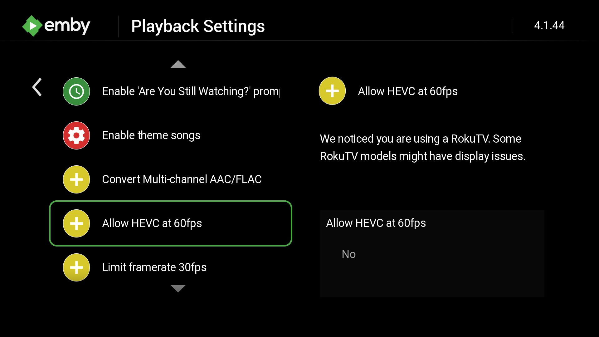

ebr 16332 Posted July 10, 2025 Posted July 10, 2025 Hi. The framerate of that particular video was not supported. It says it is 50 which is quite odd. Was it recorded from European TV? TranscodeReasons=VideoFramerateNotSupported
Happy2Play 9811 Posted July 10, 2025 Posted July 10, 2025 Should HEVC be limited here? @ebr@speechles &hevc-maxframerate=30

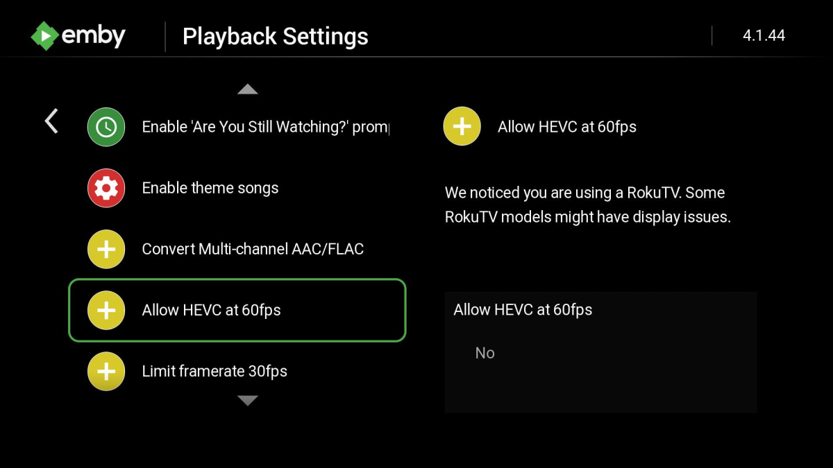

Solution speechles 2062 Posted July 10, 2025 Solution Posted July 10, 2025 We need to update the setting description since it says Roku TV. This setting applies to all Roku actually. Make sure you have this set to YES. Some Roku models claim to support HEVC @ 60fps but really are dropping frames left and right when doing so. So we allowed all Roku models to access this setting rather than just the Roku TV. We will update the setting description to remove that mention of Roku TV and that some Roku models are limited. 1 2
mark19721964 13 Posted July 10, 2025 Author Posted July 10, 2025 (edited) OK... I figured it out...My family member in the other room was watching the incredible hulk cartoon as I was watching Three's company.. Since it was happening at the same time I thought the issue was with what I was watching... but it was what THEY were watching. It was the Incredible hulk cartoon which is HEVC at 50 fps that was transcoding on their roku... because their roku settings weren't set to allow HEVC at 60fps but mine was set to yes... I was so confused. That setting change totally fixed it... thanks Oh... and the playback was immediate and smooth. I didn't see any dropping of frames at all... and I would have noticed because that absolutely drives me crazy. Edited July 10, 2025 by mark19721964 1
