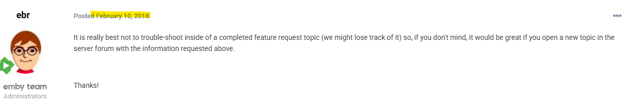

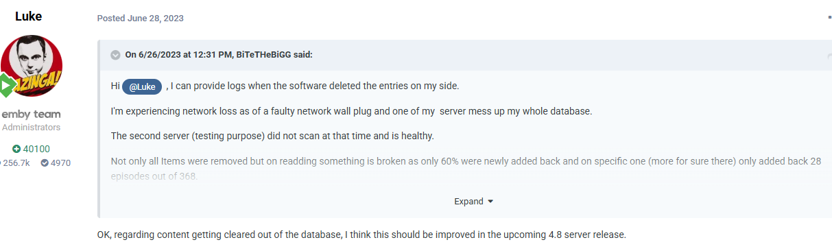

AlexisCaden 40 Posted July 9, 2025 Author Posted July 9, 2025 Thanks for this @ebr Although, it does lead to more questions... Your post: Seems to imply this has already been added to Emby. Luke's post implies it wasn't added yet: Yet the request is marked as completed, yet I am still experiencing the data wipe when the library was offline. Can you help clarify?
ebr 16337 Posted July 9, 2025 Posted July 9, 2025 Are you on 4.8.x? If so, let's look at an example. Please attach the information requested in How to Report a Problem Thanks!
