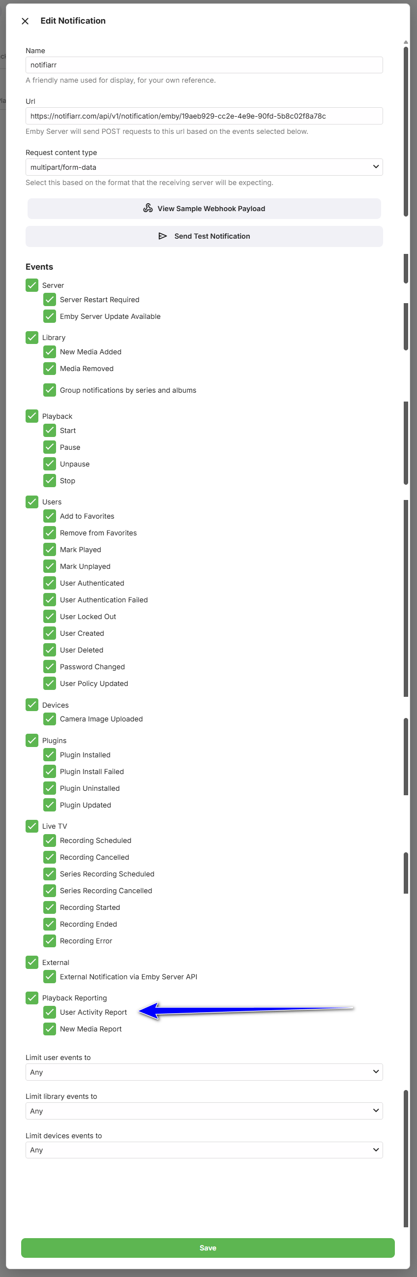

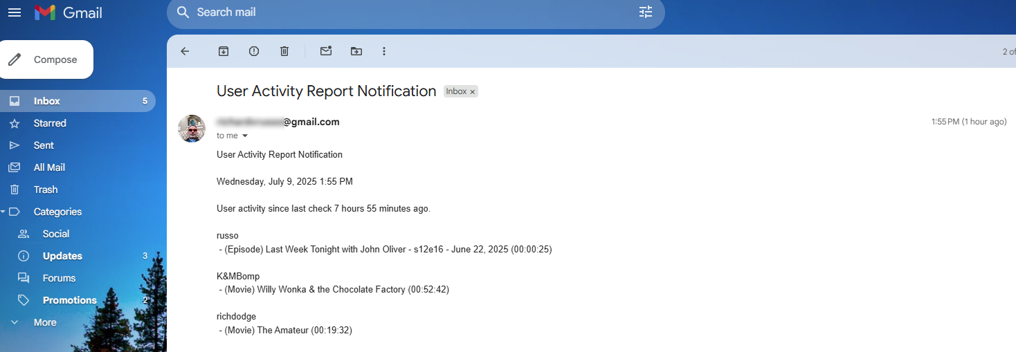

richardvrusso 13 Posted July 9, 2025 Author Posted July 9, 2025 Maybe something why it failed to send that one checkbox to the webhook? User Activity report is checked on this and the email notification. Second screenshot is the email I got but now webhook notify.
