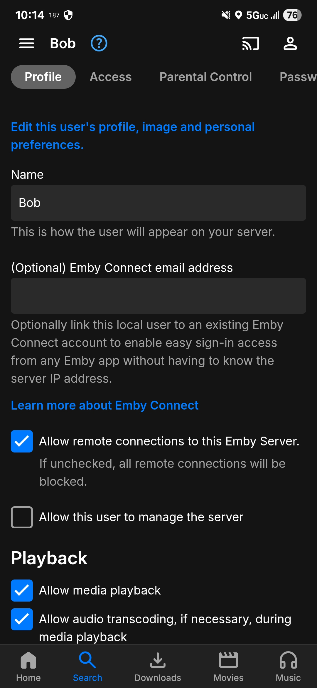

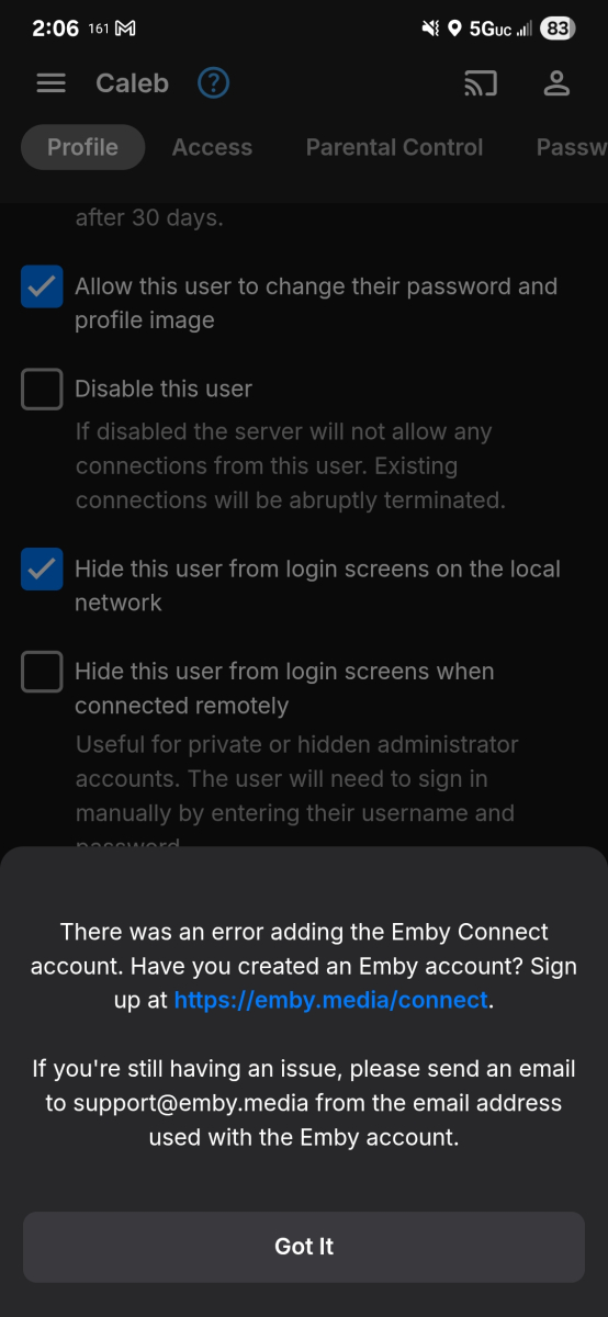

playingbball20 0 Posted July 8, 2025 Posted July 8, 2025 (edited) I was asked by my friend why he couldn't log into Emby, he only uses Emby Connect. He told me he logged in like he did with his other tv which worked fine. It has been a few months since he logged into his other tv. I went to look at the user and there was no Emby Connect email attached to the user. I added the email back and selected save. Then I received the error message: There was an error adding the Emby Connect account. Have you created an Emby account? Sign up at https://emby.media/connect. I was about to tell him to send an email however, I was told by another friend that he couldn't log in either. I checked all of my users and all of the Emby Connect emails are not there. I am not sure what to do?! Edited July 8, 2025 by playingbball20

sa2000 703 Posted July 9, 2025 Posted July 9, 2025 On 08/07/2025 at 04:18, playingbball20 said: I went to look at the user and there was no Emby Connect email attached to the user. I added the email back and selected save. Then I received the error message: There was an error adding the Emby Connect account. Have you created an Emby account? Sign up at https://emby.media/connect. There were issues in the past with backup and restore - these should now be resolved. Was there perhaps a restore from backup made at some point that may have resulted he loss of the link? The local user account Emby Connect link should only be removed now if a restore is done with the option to "Restore Server ID" unticked - which would be the case for restoring into a separate brand new server

Solution sa2000 703 Posted July 9, 2025 Solution Posted July 9, 2025 45 minutes ago, playingbball20 said: How do I fix the issues of everyone not having the Emby Connect emails able to be put back into their user account? Login with the emby connect account you are trying to fix and go to the select server screen - from change server. Delete all linked servers showing Then go back to the server settings user account and re-link

Luke 42288 Posted July 9, 2025 Posted July 9, 2025 12 minutes ago, playingbball20 said: I do not have their login information for that user. Can I do the delete the server info from my end since I am the admin? You're the admin of your server, but not their Emby Connect account. You can only remove your server from their Emby Connect account, but in this case you can't given the issue above. I would just send them a message and ask them to do it.
playingbball20 0 Posted July 9, 2025 Author Posted July 9, 2025 Ok, thank you. So once they remove the server, then I can just re add the Emby Connect email address to their user?
sa2000 703 Posted July 9, 2025 Posted July 9, 2025 2 minutes ago, playingbball20 said: So once they remove the server, then I can just re add the Emby Connect email address to their user? Yes 1

sa2000 703 Posted January 7 Posted January 7 17 minutes ago, playingbball20 said: I tried yesterday with my user and I could not get it to work. If you have a problem deleting servers from your own emby connect account, then we can have a look at that The steps were that you login with your emby connect account and then on the select server screen, click on the "..." and click on "Forget This Server" and then Confirm This can be done on the http://app.emby.media or https://app.emby.media page The server will disappar from the Select Server screen Then you login locally on the server using the local username and local password and select settings, users, edit the user account an remove the emby connect email address and save
