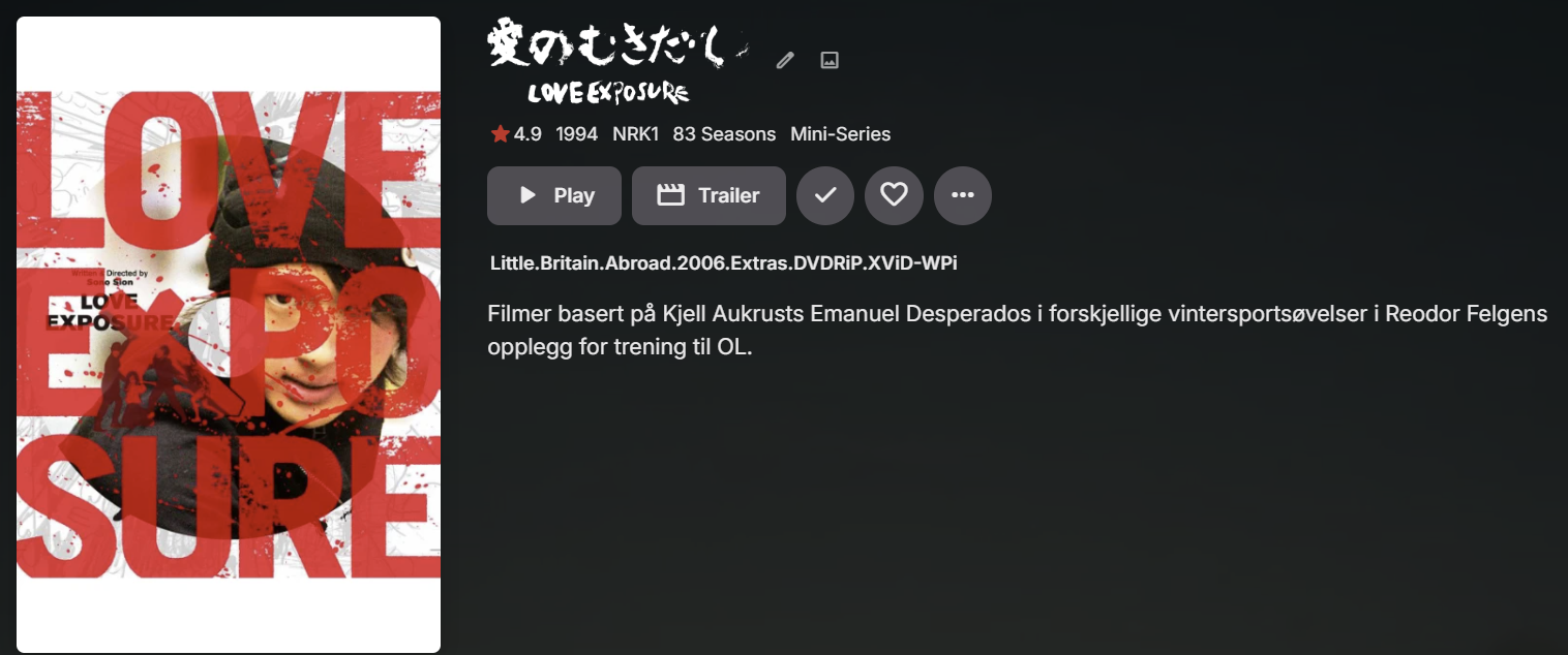

thelostswede 0 Posted July 7, 2025 Posted July 7, 2025 I know this is an old thread, but I'm having the same issue. This is apparently some Norwegian TV show, but everything in my TV show folder ends up as something from Flåklypa. Everything in that folder is in a sub folder, of which some have further subfolders. There are no files in the root TV Shows directory.

thelostswede 0 Posted July 7, 2025 Author Posted July 7, 2025 (edited) As I described, a root TV Shows directory with subdirectories with the various shows, some with just files, some with further subdirectories. The TV shows directory shows up as such and everything below gets the same show and picture. I just deleted and re-scanned all the metadata and it's exactly the same. The picture is clearly from som entirely different show. I run Emby through Docker on OMV if it makes any difference. Edited July 7, 2025 by thelostswede
Luke 42301 Posted July 7, 2025 Posted July 7, 2025 Quote a root TV Shows directory with subdirectories with the various shows, some with just files, some with further subdirectories. Can you show us exactly what it looks like? Thanks.
GrimReaper 4928 Posted July 7, 2025 Posted July 7, 2025 (edited) 24 minutes ago, thelostswede said: list.txt 1.5 MB · 1 download Please see attached. You have excessive number of season-only folders there - causing Emby to treat your TV shows root as a series folder. Quote drwxrwsrwx 2 root users 4096 Apr 27 2023 Baptiste-S01-Series.1--2019-BBC-720p-w.subs-x265-HEVC drwxrwsrwx 2 root users 4096 Apr 27 2023 Brave.New.World.S01.720p.x265-MeGusta drwxrwsrwx 2 root users 4096 Apr 27 2023 Fortitude S02 drwxrwsrwx 2 root users 4096 Apr 27 2023 Fringe S4 drwxrwsrwx 2 root users 4096 Apr 27 2023 Fringe S5 drwxrwsrwx 2 root users 4096 Apr 27 2023 From Dusk till Dawn S01 drwxrwsrwx 2 root users 4096 Apr 27 2023 Futurama S6 drwxrwsrwx 2 root users 4096 Apr 27 2023 Good Omens (2019) Season 1 S01 (1080p AMZN WEB-DL x265 HEVC 10bit EAC3 5.1 RZeroX) etc. Each TV show needs to have its own folder (season folders underneath that are not mandatory, but recommended). TV Naming Rename/restructure, rescan. Edited July 7, 2025 by GrimReaper
thelostswede 0 Posted July 7, 2025 Author Posted July 7, 2025 So because of that, Emby should identify them as something it's not, in fact, two different shows that have nothing related to each other? Sounds logical.
Luke 42301 Posted July 7, 2025 Posted July 7, 2025 We plan to be able to support more mish mash folder structures. We’re just not quite there yet.
thelostswede 0 Posted July 7, 2025 Author Posted July 7, 2025 Which is fine, but how come it decided not just for me, but at least for two other people, that the show in question was Flåklypa and at least in my case, mixed it up with something else? That makes no sense at all, especially as I don't know what either of those are.
Luke 42301 Posted July 7, 2025 Posted July 7, 2025 1 minute ago, thelostswede said: Which is fine, but how come it decided not just for me, but at least for two other people, that the show in question was Flåklypa and at least in my case, mixed it up with something else? That makes no sense at all, especially as I don't know what either of those are. We'd have to see the server log, but generally it takes the name of the folder that it thinks is the tv series and plugs that into tvdb/moviedb searches.
