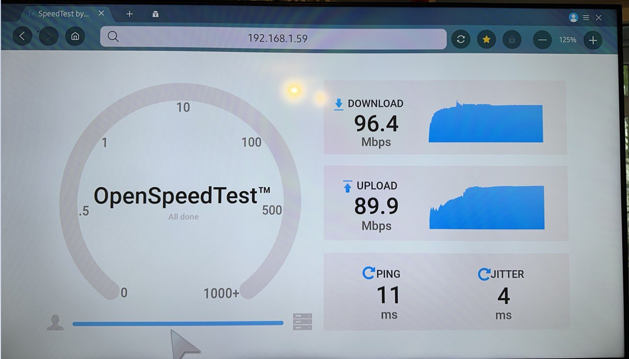

While I was waiting for Wi-Fi bridge delivery, I decided to take a look into something like HTTP-based speed test and found this one
https://openspeedtest.com/ -it's very easy to use HTML5-based on-premise speedtest which doesn't require own client like iperf.
so I started the server-side at my home server (Intel GE NIC) and used Samsung Browser at TV and got this:
this is TV's internal Wi-Fi.
Despite these results, it was impossible to watch Snatch in directplay mode with a 96Mbps bitrate - Emby regularly spun a blue circle for 2-3 seconds each.

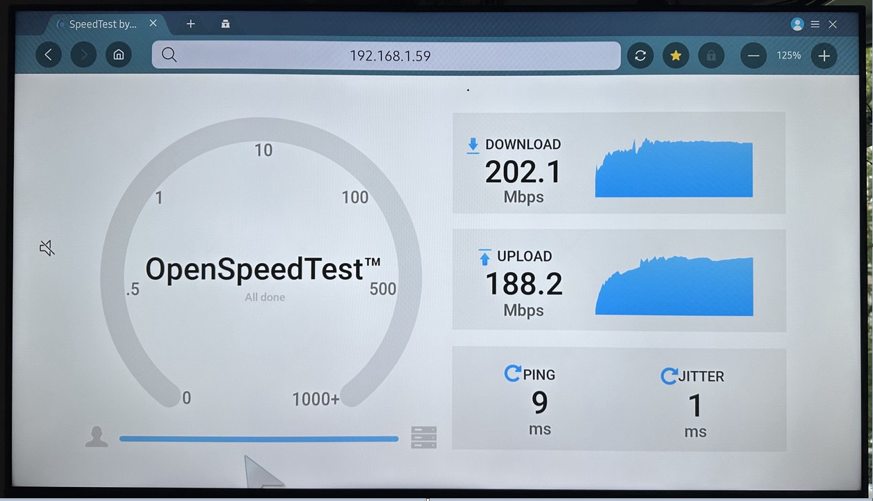

yesterday Buddy 6 SE was delivered.
well, I have to say, that my TV has only fastethernet port =(
this is test via Buddy
so the result was predictable.
but be that as it may, watching the Snatch has become much better and now it's not a blue circle, but just a half-second lag. Of course, it's still impossible to watch, but the experience was bought for only $100. now it's limit of FE port.
conclusion:
the problem most likely lies in the TV's Wi-Fi adapter buffer, its driver or the features of the Tizen OS.
