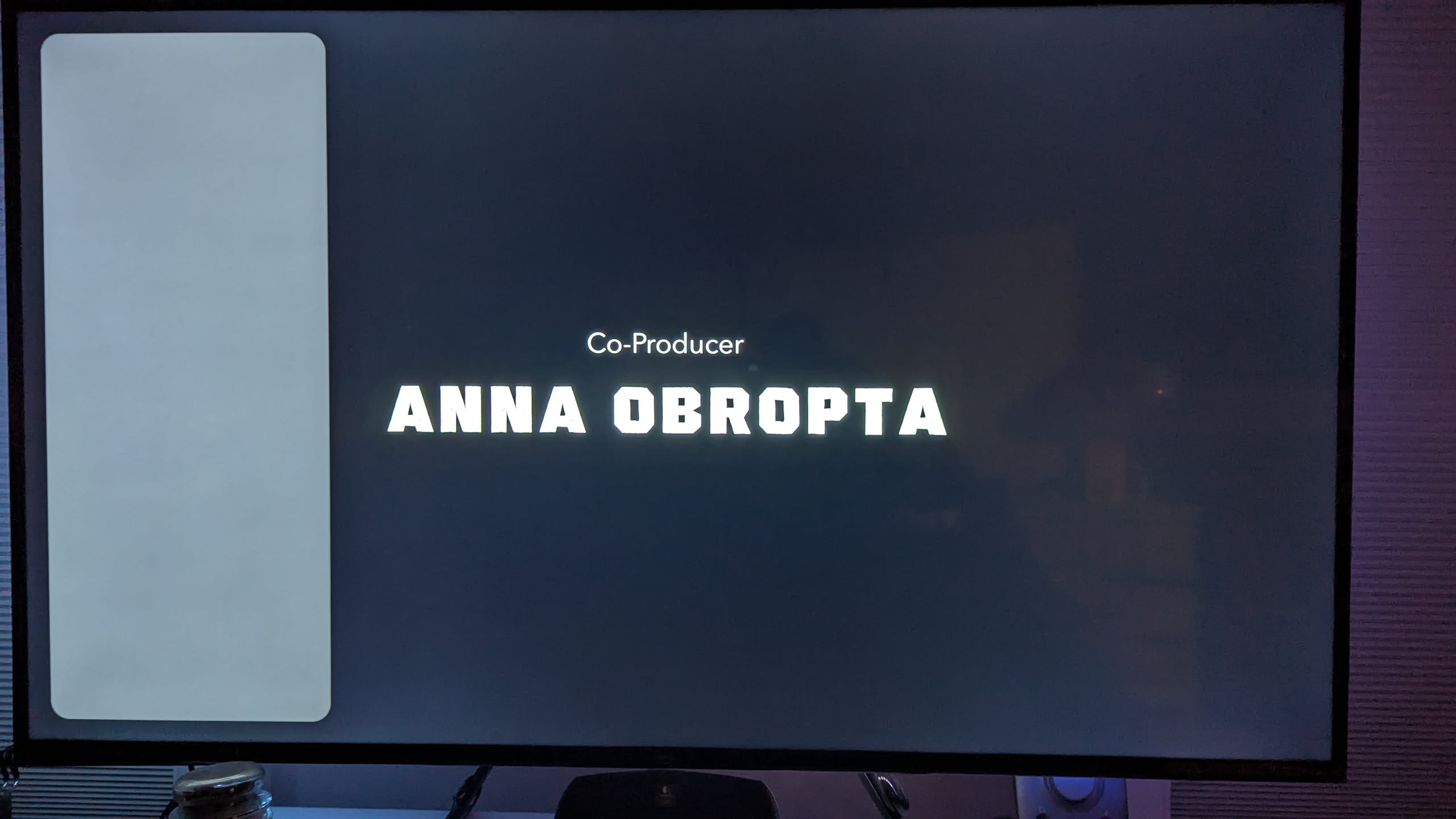

majorsl 23 Posted October 4, 2025 Posted October 4, 2025 This is what happens. Try to back button out and the tray slides out blank. It only happens when video is present. If the video finishes (and there isn't another "next up") it returns to normal. Something if you try the back button many times in a row it'll not only lock Emby but the whole device as I noted earlier.
seanbuff 1356 Posted October 4, 2025 Posted October 4, 2025 29 minutes ago, majorsl said: Try to back button out and the tray slides out blank. Hi @majorslwhat version of the Android app are you currently running? There was previously a whole thread about this issue, and it was resolved in a semi-recent app update.
Luke 42243 Posted October 4, 2025 Posted October 4, 2025 Hi, yes what version number of the app are you on now?
seanbuff 1356 Posted October 5, 2025 Posted October 5, 2025 5 hours ago, majorsl said: It appears to be 3.4.74 Jun 12th. There have been many updates since this version, the Play Store is quite a bit behind. If you need immediate relief, you can sideload the latest Android app from here: https://emby.media/emby-for-android.html

majorsl 23 Posted October 5, 2025 Posted October 5, 2025 Thanks gents, looks like the Amazon Store one is newer than what I have. Since it's a FireTV, I'll give that a shot first. If not, I'll side load. 1
