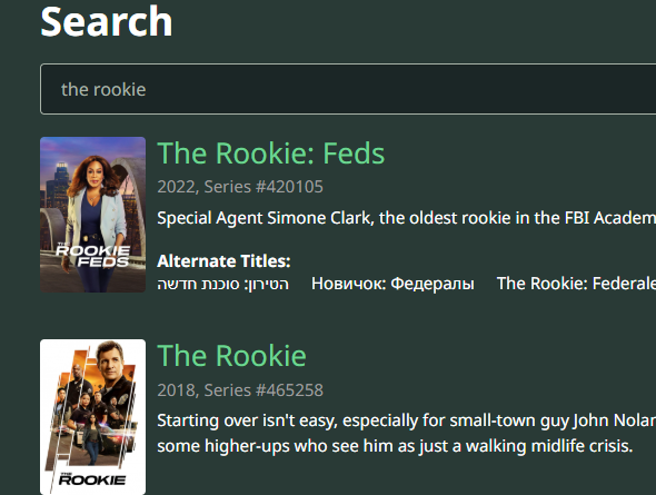

Solution Neminem 1985 Posted June 30, 2025 Solution Posted June 30, 2025 (edited) Try adding year and tvdbid to your folders The Rookie - Feds (2022) [TvdbId=420105] The Rookie (2018) [TvdbId=350665] The Rookie (2018) [TvdbId=465258] TV Naming Edited June 30, 2025 by Neminem
Happy2Play 9840 Posted June 30, 2025 Posted June 30, 2025 (edited) Currently no way to lock providerid. Requested several times as there are sometimes provider miss-matches. But you would need to go over a full example for your issue to include structure and naming scheme, as I have not has an issue with that show. But 99% of the time adding year to every series resolves most issues. The Rookie (2018) The Rookie {tvdbid=465258} The Rookie {tmdbid=79744} The Rookie {imdbid=tt7587890} Edited June 30, 2025 by Happy2Play
Happy2Play 9840 Posted June 30, 2025 Posted June 30, 2025 Follow up as doing a by name search will get the wrong first results as you have noticed. So adding year is critical here.
Happy2Play 9840 Posted June 30, 2025 Posted June 30, 2025 5 minutes ago, Neminem said: Try adding year and tvdbid to your folders The Rookie - Feds (2022) [TvdbId=420105] The Rookie (2018) [TvdbId=350665] TV Naming FYI I just notice they change the TVDB here as 350665 is no longer valid. 1

Happy2Play 9840 Posted June 30, 2025 Posted June 30, 2025 2 hours ago, TugboatBill said: Thanks for the heads up on using the year. I renamed the folder, deleted the entry in Emby, rescanned and the show came up properly. The manual entry of the IDs is definitely wonky. One can edit it, but Emby just overwrites. I can understand the logic on most of the metadata, you edit and it automatically turns on the lock for that data. The external ID should work the same way. Yes it would be nice but at the same time most of the info will come from the provider sites providing other sites externalids also. But yes occasionally they can be wrong or one site has a completely different order then the other. Primarily cartoons so individual locks on providerids can be useful. In your case Re-Identifying the Show should have don't what you needed also.
