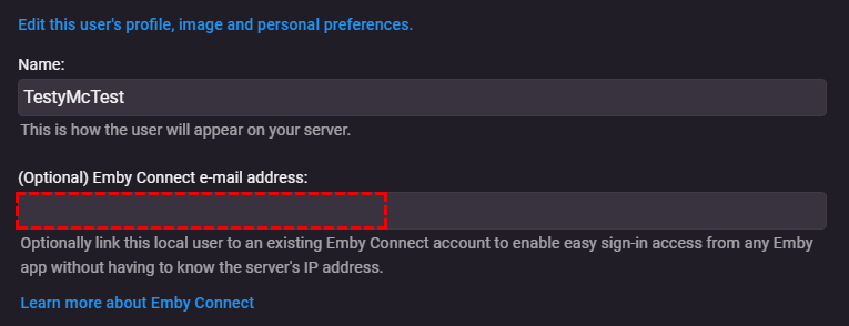

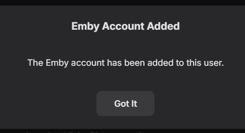

seanbuff 1360 Posted June 30, 2025 Posted June 30, 2025 If you believe she has a password issue, you can direct her to reset her Emby Connect password here: https://emby.media/community/index.php?/lostpassword/ If you would like to re-link her local user account with her Emby Connect email: Remove the email address, hit Save. Re-enter the email address, hit Save. You should see a popup indicating the account has been successfully linked. 1 hour ago, Talkworks said: Is Emby connect "smart" in the sense it knows if the user is "inside" and should connect via the LAN address or "outside" (remote) and knows it should connect via the WAN address? Your router should do this if it supports loopback connections.

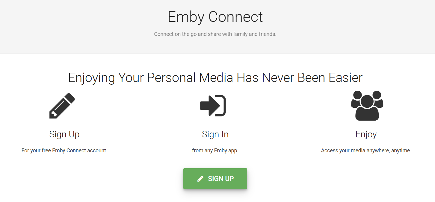

seanbuff 1360 Posted June 30, 2025 Posted June 30, 2025 10 minutes ago, Talkworks said: "If we were able to find an account for the email address supplied, an email will be sent with further instructions to recover your account. Check your email within the next few minutes, including any junk or spam folders. If you do not receive an email within the next few minutes, please verify the information supplied and try again." Obvious question, but did you initially get her to click the green button here to "SIGN UP" to Emby Connect in the first place? Link here: https://emby.media/community/index.php?/register/ This step is required in addition to you adding a local user for this person on your server and then linking the two with the email address used during registration.
