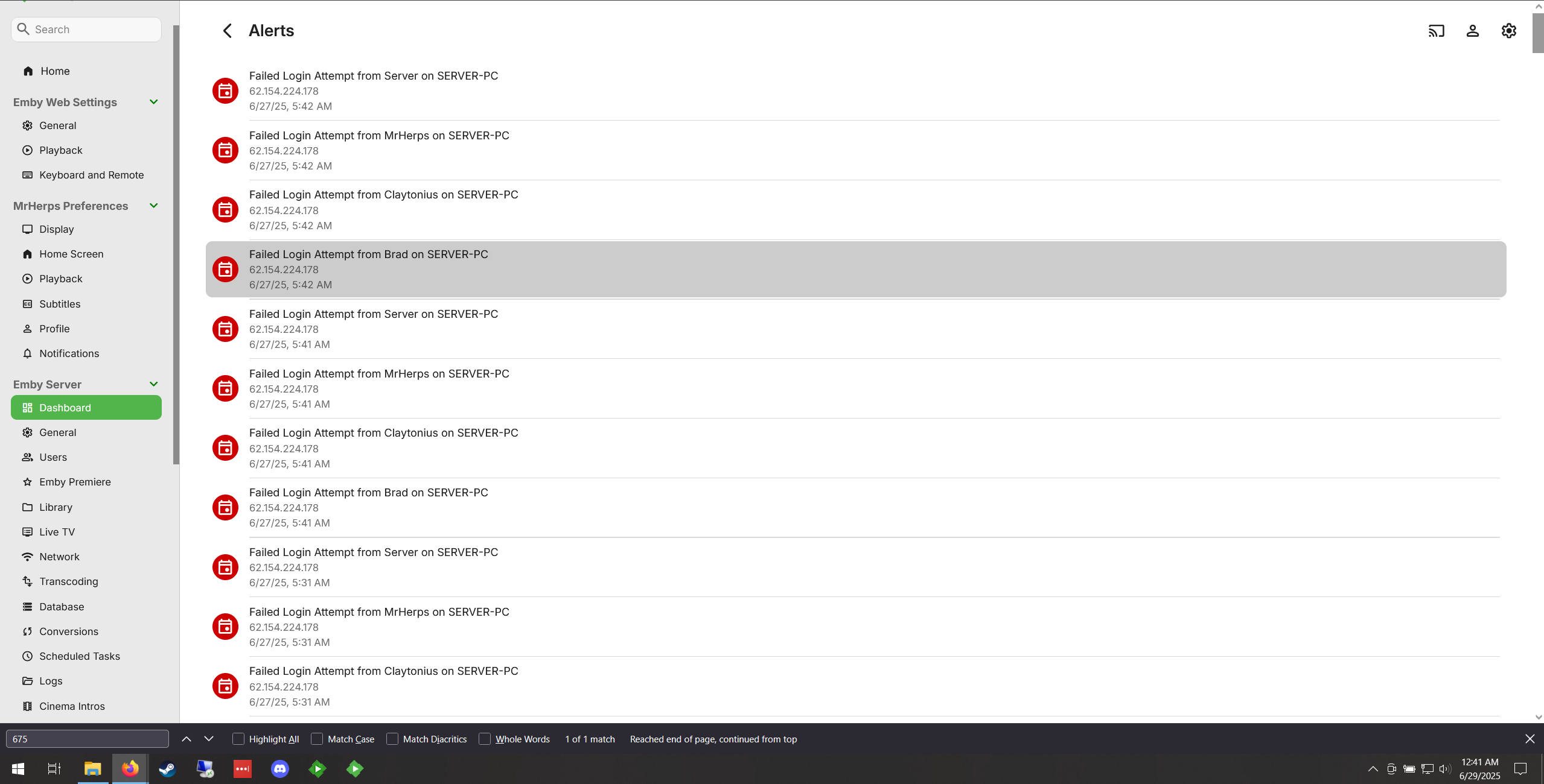

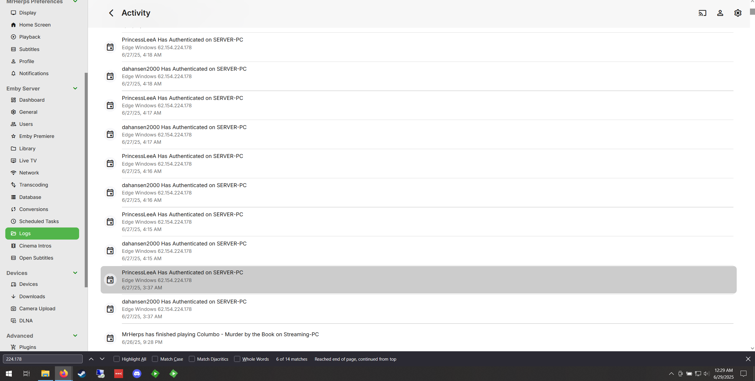

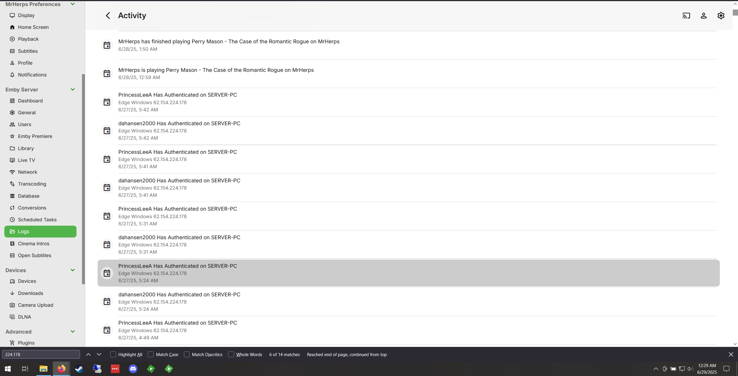

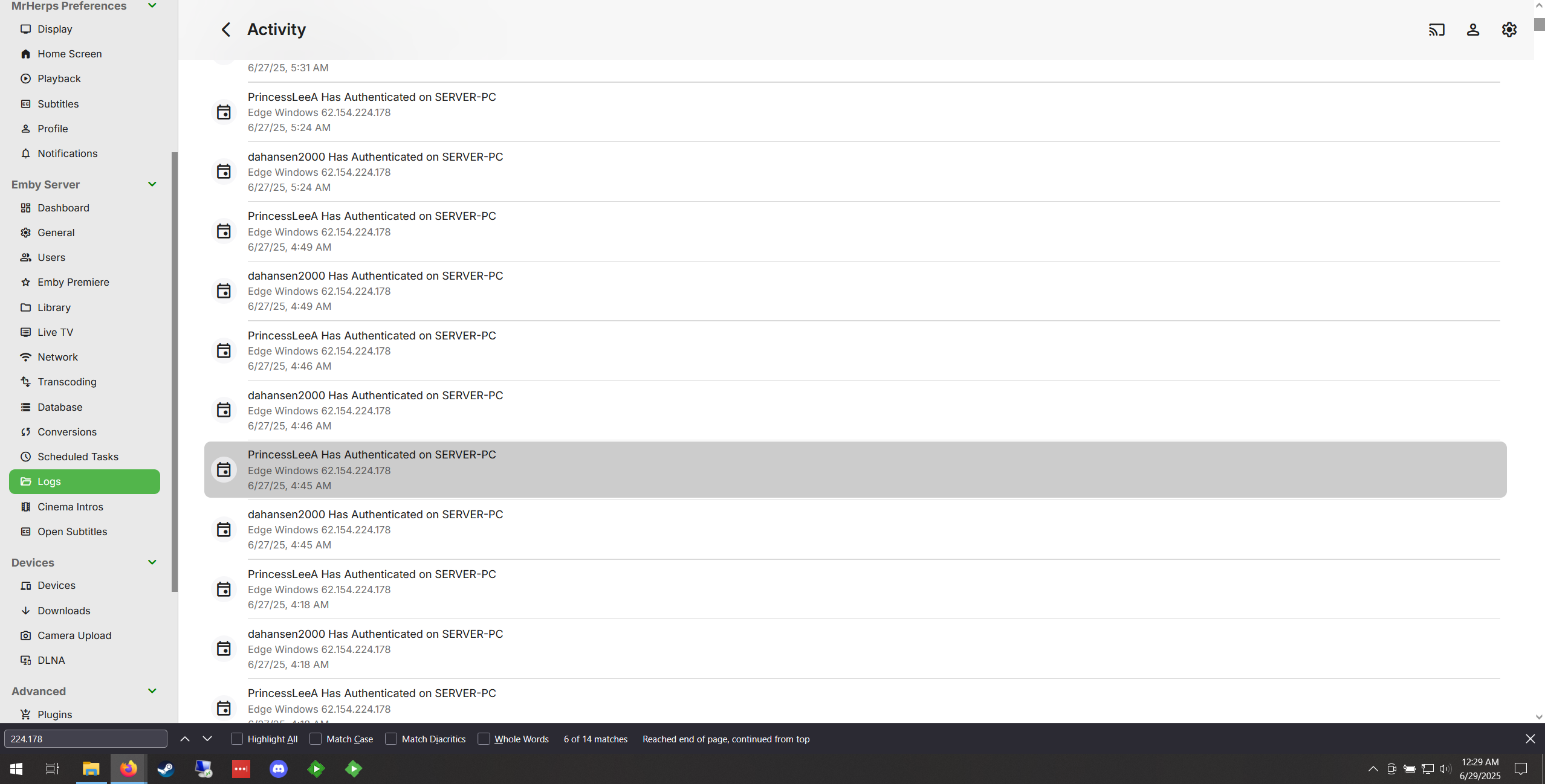

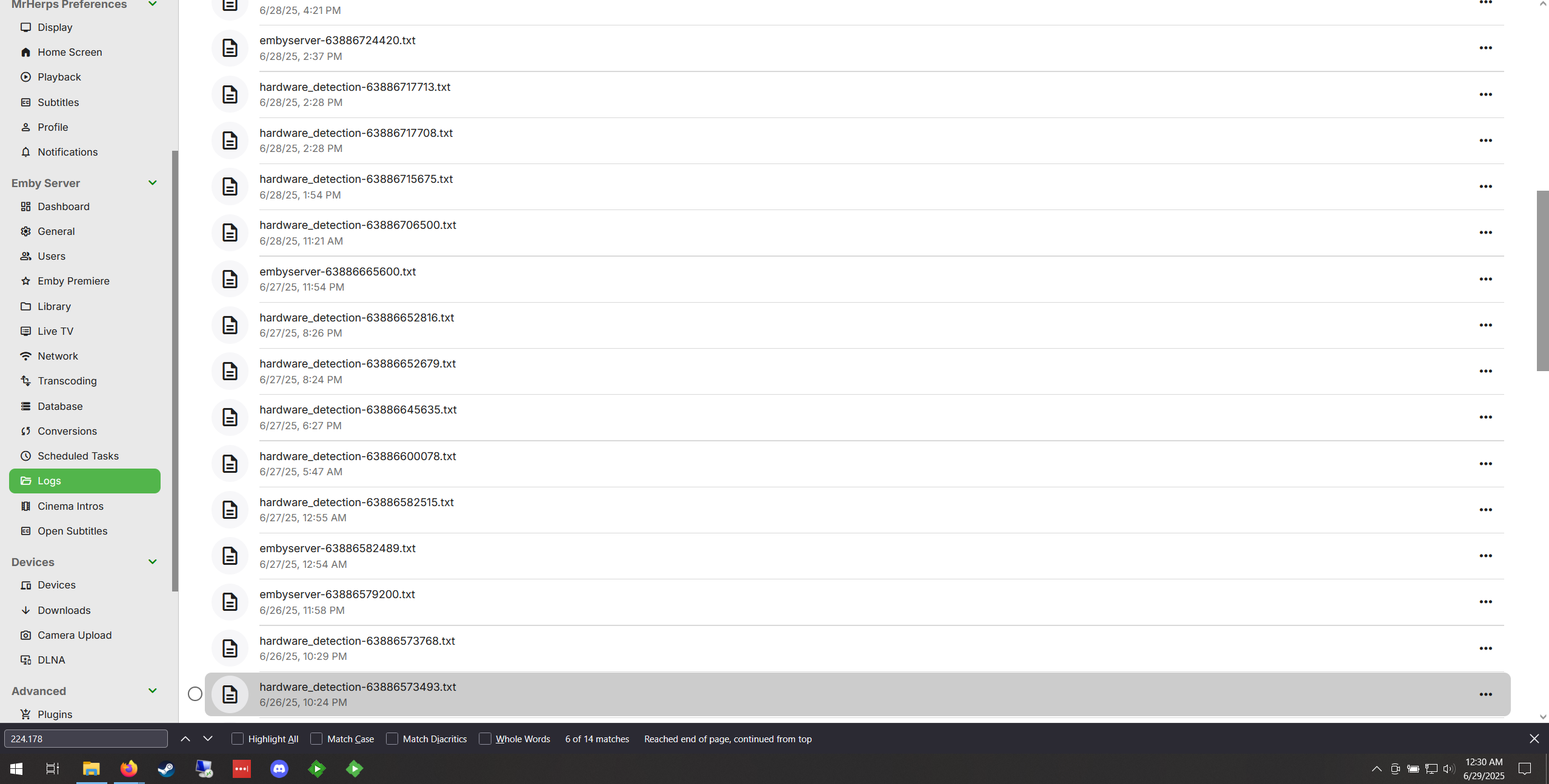

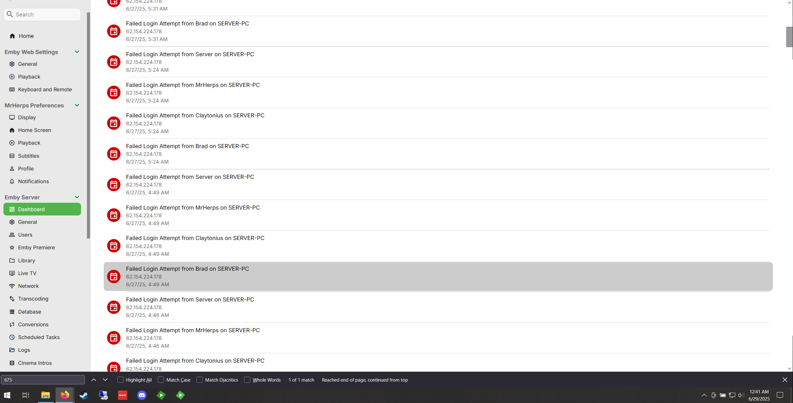

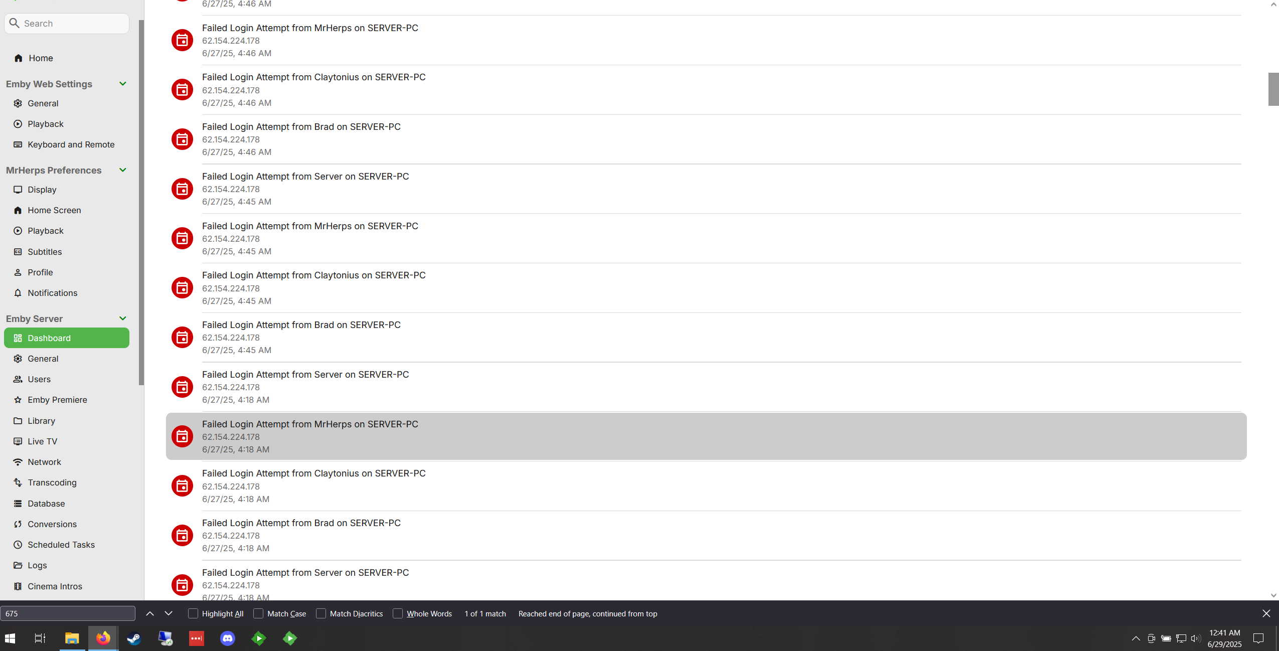

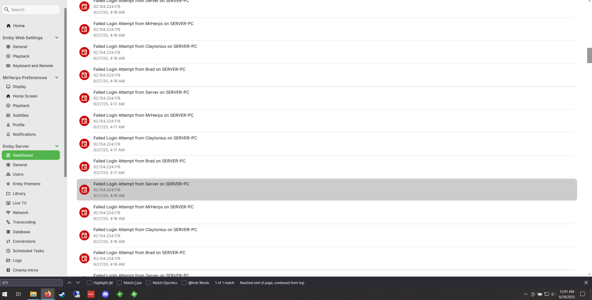

MrHerps 2 Posted June 29, 2025 Posted June 29, 2025 Hello, I hope this is right place for this, a couple days ago some appeared to brute force their way into my Emby server, there were numerous attempts from the same IP address, the ip address is coming from Germany, this person managed to get into 2 of the accounts that I have on my server luckily they were accounts that don’t have permissions to manage the server. I went through every user account with my password manager and created cryptic passwords for everyone. I notice that on the “Activity” page that the suspicious activity started on 6/27/2025 at 3:37 AM from the IP address ending in 178 and ends at 5:42 AM. I also noticed a whole bunch of failed attempts on the "Alerts" page According to the logs a whole bunch of activity starts at 6/26/2025 at 10:21 PM and continues on. I'm just not sure what this individuals intentions were or what got from getting into my server. I've attached relevant logs and screens shots. Thanks. hardware_detection-63886725110.txt hardware_detection-63886724465.txt embyserver-63886724420.txt hardware_detection-63886717713.txt hardware_detection-63886717708.txt hardware_detection-63886715675.txt hardware_detection-63886706500.txt hardware_detection-63886652679.txt hardware_detection-63886645635.txt hardware_detection-63886600078(1).txt hardware_detection-63886582515.txt embyserver-63886582489.txt hardware_detection-63886600078.txt hardware_detection-63886746599.txt hardware_detection-63886746249.txt hardware_detection-63886746244.txt hardware_detection-63886745160.txt hardware_detection-63886745155.txt hardware_detection-63886744992.txt hardware_detection-63886744786.txt hardware_detection-63886743634.txt hardware_detection-63886740291.txt

MrHerps 2 Posted June 29, 2025 Author Posted June 29, 2025 Hi thanks for the reply! I have tried setting up Emby to work using Nordvpn with a static IP but I could never get it to work remotely, I ended up canceling my subscription to Nordvpn for this and other reasons. I'm using a No-IP DNS Hostname for the server. I'm not sure how to use SSL, and what other port should I use? I did just go through and turned on the option "Hide this user account from login screens on devices they've never signed into" for all my users. Is this the reason this individual was able to get the usernames in the first place? I don't know how to interpret the logs is it possible to determine what this individuals intentions were? Thanks the help this has been really stressing me out, I ran an Malware bytes scan on my server and it didn't find anything, is there anything else I should check?
Luke 42310 Posted June 29, 2025 Posted June 29, 2025 Quote I did just go through and turned on the option "Hide this user account from login screens on devices they've never signed into" for all my users. Is this the reason this individual was able to get the usernames in the first place? Possibly, yes, but then there's the question of how they found your server in the first place. The most likely answer to that is with simple port scanning over lots of ip addresses where they're just sending out requests and seeing what they find. That's why using a different public racing port can help hide your emby server a little bit better than using the default. You'd have to first set a new public port number in emby server network settings, and then change the port forwarding rule in your router from 8096 to whatever the new port is that you decide on.
MrHerps 2 Posted June 29, 2025 Author Posted June 29, 2025 What port should I use instead of the Default?
Luke 42310 Posted June 29, 2025 Posted June 29, 2025 Anything your router and ISP allows. 9042, whatever you want. But simply entering it into emby server network settings by itself might not be enough. You can't skip the step about changing the port forwarding rule in your router.

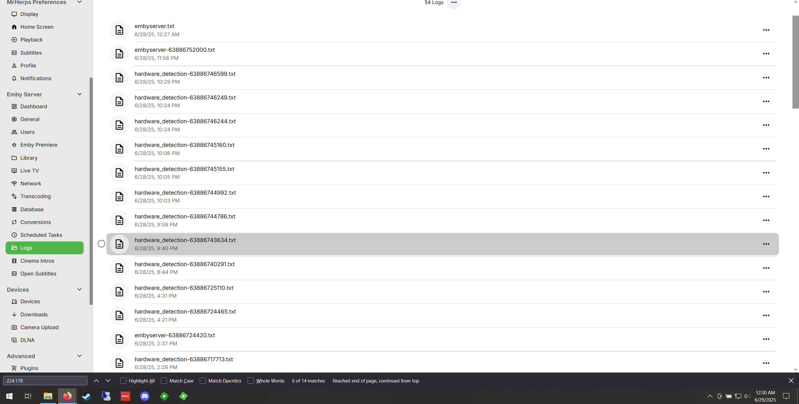

MrHerps 2 Posted July 3, 2025 Author Posted July 3, 2025 My final question is what are the "hardware detection" messages?
Luke 42310 Posted July 4, 2025 Posted July 4, 2025 11 hours ago, MrHerps said: My final question is what are the "hardware detection" messages? The server detects supported graphics cards for hardware transcoding features.
