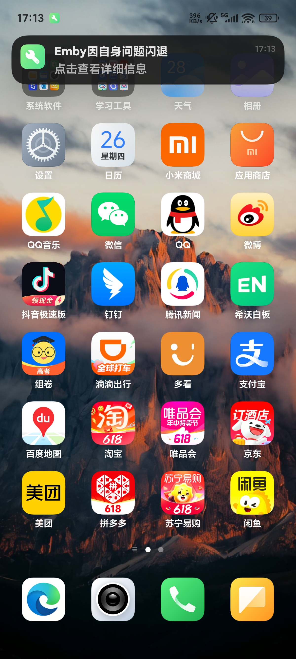

LeeTEMBY 0 Posted June 25, 2025 Posted June 25, 2025 When playing an STRM file with a broken/expired streaming link, the Emby Android app crashes immediately, exiting the program and returning to the phone's home screen. Users must then log back in to Emby. Could this be improved to avoid exiting the app and instead display a prompt indicating that the link may be invalid?

LeeTEMBY 0 Posted June 27, 2025 Author Posted June 27, 2025 12 hours ago, Luke said: Hi there, can you please supply the log files anyway? thanks. 应用名称:Emby 问题Trace: Redmi/turner/turner:15/AP3A.240905.015.A2/OS2.0.210.0.VAOCNXM:user/release-keys #00 pc 000000000003f74c /data/app/~~rlvMylnC_bB55TfpbMjAtQ==/com.mb.android-RJDJLlZSSZK8k96uO8zz2g==/lib/arm64/libavutil.so (av_strstart+8) #01 pc 00000000001dee2c /data/app/~~rlvMylnC_bB55TfpbMjAtQ==/com.mb.android-RJDJLlZSSZK8k96uO8zz2g==/lib/arm64/libavformat.so #02 pc 00000000000ff950 /data/app/~~rlvMylnC_bB55TfpbMjAtQ==/com.mb.android-RJDJLlZSSZK8k96uO8zz2g==/lib/arm64/libavformat.so (av_probe_input_format3+344) #03 pc 00000000000ffb28 /data/app/~~rlvMylnC_bB55TfpbMjAtQ==/com.mb.android-RJDJLlZSSZK8k96uO8zz2g==/lib/arm64/libavformat.so (av_probe_input_format+8) #04 pc 000000000001b3e4 /data/app/~~rlvMylnC_bB55TfpbMjAtQ==/com.mb.android-RJDJLlZSSZK8k96uO8zz2g==/lib/arm64/libffmpegJNI.so (Java_androidx_media3_decoder_ffmpeg_FfmpegExtractorJni_ffmpegGetInputFormat+188) (BuildId: 4d330039cbf8aec9c62b3bbfe4b2a57051620291) #05 pc 0000000000387170 /apex/com.android.art/lib64/libart.so (art_quick_generic_jni_trampoline+144) (BuildId: 82b2cb0df2c9391577f480d1e91d02af) #06 pc 000000000078de88 /apex/com.android.art/lib64/libart.so (nterp_helper+152) (BuildId: 82b2cb0df2c9391577f480d1e91d02af) #07 pc 00000000003d83c2 /data/app/~~rlvMylnC_bB55TfpbMjAtQ==/com.mb.android-RJDJLlZSSZK8k96uO8zz2g==/oat/arm64/base.vdex (androidx.media3.decoder.ffmpeg.FfmpegExtractor.sniff+94) #08 pc 000000000078fb64 /apex/com.android.art/lib64/libart.so (nterp_helper+7540) (BuildId: 82b2cb0df2c9391577f480d1e91d02af) #09 pc 0000000000430640 /data/app/~~rlvMylnC_bB55TfpbMjAtQ==/com.mb.android-RJDJLlZSSZK8k96uO8zz2g==/oat/arm64/base.vdex (androidx.media3.exoplayer.source.BundledExtractorsAdapter.init+88) #10 pc 0000000000790974 /apex/com.android.art/lib64/libart.so (nterp_helper+11140) (BuildId: 82b2cb0df2c9391577f480d1e91d02af) #11 pc 000000000043a672 /data/app/~~rlvMylnC_bB55TfpbMjAtQ==/com.mb.android-RJDJLlZSSZK8k96uO8zz2g==/oat/arm64/base.vdex (androidx.media3.exoplayer.source.ProgressiveMediaPeriod$ExtractingLoadable.load+314) #12 pc 000000000078fb64 /apex/com.android.art/lib64/libart.so (nterp_helper+7540) (BuildId: 82b2cb0df2c9391577f480d1e91d02af) #13 pc 000000000045b84c /data/app/~~rlvMylnC_bB55TfpbMjAtQ==/com.mb.android-RJDJLlZSSZK8k96uO8zz2g==/oat/arm64/base.vdex (androidx.media3.exoplayer.upstream.Loader$LoadTask.run+88) #14 pc 000000000029adcc /system/framework/arm64/boot.oat (java.util.concurrent.ThreadPoolExecutor.runWorker+796) (BuildId: 93e69b260721fc04b416fd493e0765c69c752bf6) #15 pc 0000000000298290 /system/framework/arm64/boot.oat (java.util.concurrent.ThreadPoolExecutor$Worker.run+64) (BuildId: 93e69b260721fc04b416fd493e0765c69c752bf6) #16 pc 0000000000160168 /system/framework/arm64/boot.oat (java.lang.Thread.run+72) (BuildId: 93e69b260721fc04b416fd493e0765c69c752bf6) #17 pc 0000000000370974 /apex/com.android.art/lib64/libart.so (art_quick_invoke_stub+612) (BuildId: 82b2cb0df2c9391577f480d1e91d02af) #18 pc 000000000035bfd4 /apex/com.android.art/lib64/libart.so (art::ArtMethod::Invoke(art::Thread*, unsigned int*, unsigned int, art::JValue*, char const*)+132) (BuildId: 82b2cb0df2c9391577f480d1e91d02af) #19 pc 000000000096aa4c /apex/com.android.art/lib64/libart.so (art::detail::ShortyTraits<(char)86>::Type art::ArtMethod::InvokeInstance<(char)86>(art::Thread*, art::ObjPtr<art::mirror::Object>, art::detail::ShortyTraits<>::Type...)+60) (BuildId: 82b2cb0df2c9391577f480d1e91d02af) #20 pc 000000000053bc3c /apex/com.android.art/lib64/libart.so (art::Thread::CreateCallback(void*)+1788) (BuildId: 82b2cb0df2c9391577f480d1e91d02af) #21 pc 00000000000706a8 /apex/com.android.runtime/lib64/bionic/libc.so (__pthread_start(void*)+200) (BuildId: 4f9662f2c4cc93880474c7b483cce276) #22 pc 0000000000061a40 /apex/com.android.runtime/lib64/bionic/libc.so (__start_thread+64) (BuildId: 4f9662f2c4cc93880474c7b483cce276)

LeeTEMBY 0 Posted June 28, 2025 Author Posted June 28, 2025 (edited) 5 hours ago, Luke said: When you say invalid, what exactly do you mean by that? Because it looks like it does point to a real video url, no? 为什么播放失效的链接,emby会崩溃?而且是100%的崩溃。 Edited June 28, 2025 by LeeTEMBY
