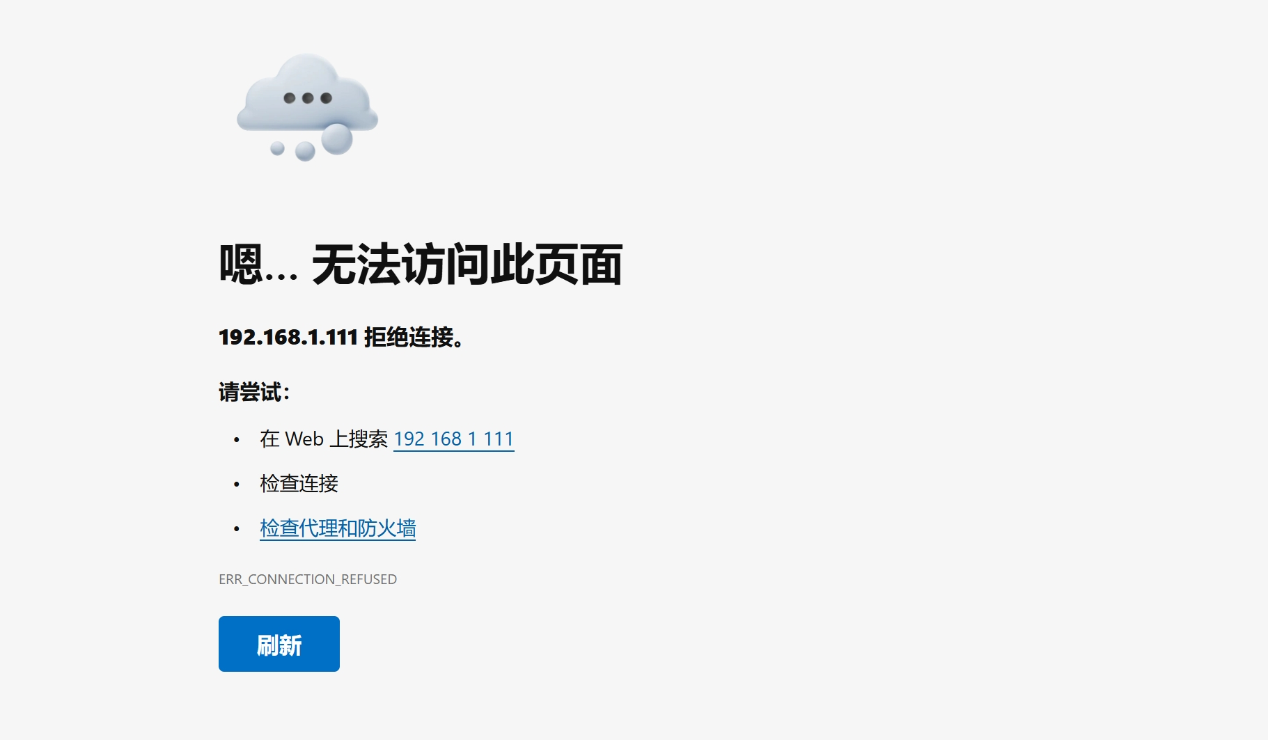

Rayoo 2 Posted June 25, 2025 Posted June 25, 2025 ASUSTOR 6704T ADM 5.0RIN1(Latest Version) EMBY 4.9.0.70(reinstall) Can‘t Open emby sever page,Connection refused!
Rayoo 2 Posted June 25, 2025 Author Posted June 25, 2025 2 minutes ago, Rayoo said: ASUSTOR 6704T ADM 5.0RIN1(Latest Version) EMBY 4.9.0.70(reinstall) Can‘t Open emby sever page,Connection refused! /Home have no Emby Server Data Folder

Rayoo 2 Posted June 26, 2025 Author Posted June 26, 2025 16 hours ago, Rayoo said: ASUSTOR 6704T ADM 5.0RIN1(Latest Version) EMBY 4.9.0.70(reinstall) Can‘t Open emby sever page,Connection refused! @Luke
Luke 42234 Posted June 26, 2025 Posted June 26, 2025 HI, is any Emby Server log file generated? Emby Server Data Folder
Rayoo 2 Posted June 26, 2025 Author Posted June 26, 2025 9 hours ago, Luke said: HI, is any Emby Server log file generated? Emby Server Data Folder no emby folder or files under /Home before I reinstall emby app everythings runs fine,I saw emby data folder under /Home
