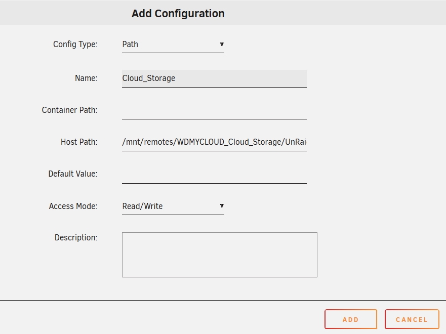

Embodiment 33 Posted June 28, 2025 Author Posted June 28, 2025 (edited) Tried too several times. Attached is my settings for the backup path. l path. Edited June 28, 2025 by Embodiment

Neminem 1630 Posted June 29, 2025 Posted June 29, 2025 @EmbodimentIt looks like you forgot to add the container path. And since its a remote path, set the Access Mode to RW - Slave. 1
Embodiment 33 Posted June 29, 2025 Author Posted June 29, 2025 Kudos! You were exactly correct. Working now. Mega thanks. Curious, what does this "Access Mode to RW - Slave" do differently than read write. What does the - Slave option do? 1
Neminem 1630 Posted June 29, 2025 Posted June 29, 2025 1 hour ago, Embodiment said: Curious, what does this "Access Mode to RW - Slave" do It should let Emby know its offline if it can't access it. Useful if you have media on a another nas, or you backup set to remote. 1
