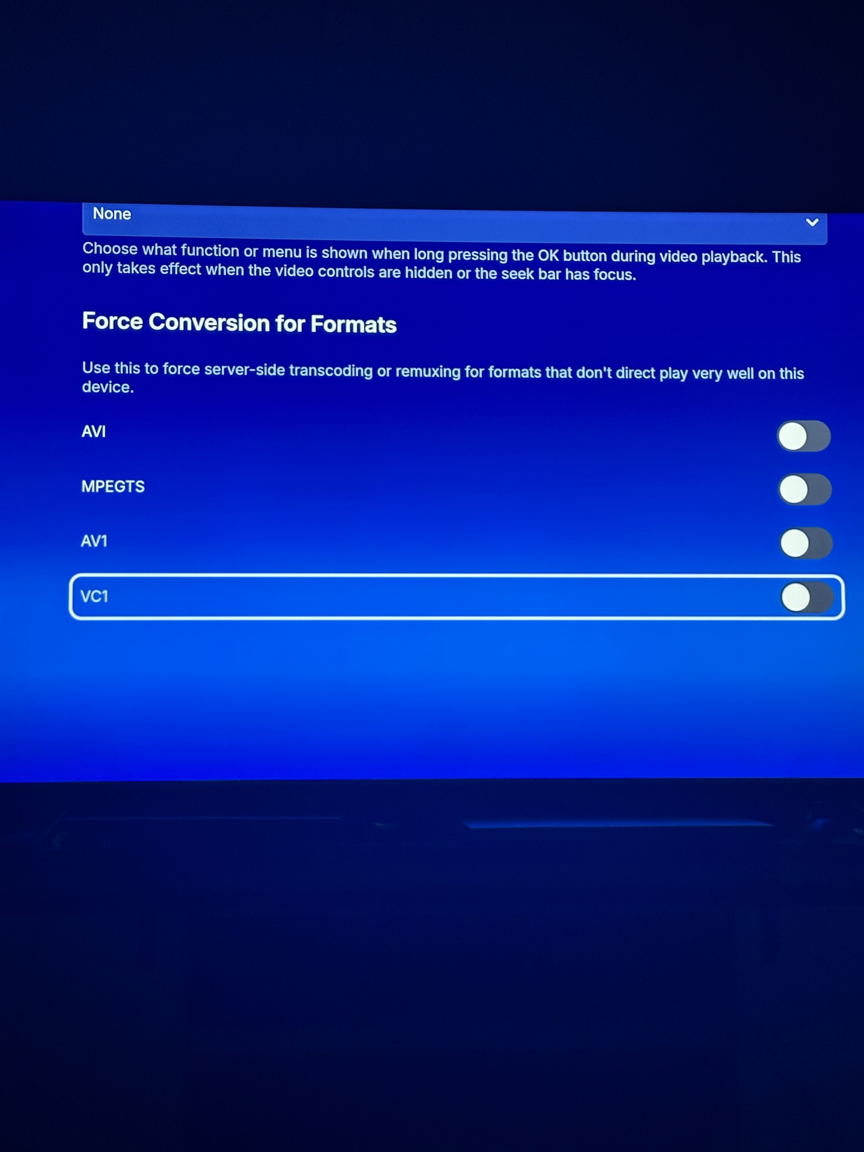

lstryhrn 8 Posted June 22, 2025 Posted June 22, 2025 I was having problems with VC1 videos trying to direct play on an unsupported device. Went to the play back settings and found this in the Emby Android app.(see below or attached picture). Why is this even a thing? Why not automatically have Emby transcode for unsupported formats on a device? Never had that issue with the Emby Android TV app. If something wasn’t supported Emby would pick up on it and transcode.
Luke 42310 Posted June 23, 2025 Posted June 23, 2025 Hi, it's not automatic because the app will play with software decoding when a hardware decoder isn't available. How well it will play just depends on how powerful the device is and it's hard to predict that.
lstryhrn 8 Posted June 23, 2025 Author Posted June 23, 2025 30 minutes ago, Luke said: Hi, it's not automatic because the app will play with software decoding when a hardware decoder isn't available. How well it will play just depends on how powerful the device is and it's hard to predict that. My Emby server is trying to direct playing or do you mean there some software /hardwarde decode happening on the device itself (firestick). The Emby Android TV app realizes that your device doesnt support the codec and then makes the server transcode it. Seems like the new Emby app is just trying force direct play everything .
Gilgamesh_48 1244 Posted June 23, 2025 Posted June 23, 2025 @lstryhrnWhen you run into this try pressing the down arrow on your remote and then scroll over to the star * and click on it and then, in the resulting dropdown, choose "Playback correction" and choose it and see what happens. I "think" that forces transcoding and I have found it is needed for a few videos. Also, there are two Emby apps in the Amazon Fire store and you might try the other one. On my Shield the Android for TV app has some minor playback issues but those clear up when using the "regular" app as it uses a different player. I do not really like the "regular" app and I use the playback correction on the few videos that have problems. But that is just me, it seems that a lot of people like the "regular" app. The app you want to use on the Fire devices is 3.4.74
lstryhrn 8 Posted June 24, 2025 Author Posted June 24, 2025 1 hour ago, Gilgamesh_48 said: @lstryhrnWhen you run into this try pressing the down arrow on your remote and then scroll over to the star * and click on it and then, in the resulting dropdown, choose "Playback correction" and choose it and see what happens. I "think" that forces transcoding and I have found it is needed for a few videos. Also, there are two Emby apps in the Amazon Fire store and you might try the other one. On my Shield the Android for TV app has some minor playback issues but those clear up when using the "regular" app as it uses a different player. I do not really like the "regular" app and I use the playback correction on the few videos that have problems. But that is just me, it seems that a lot of people like the "regular" app. The app you want to use on the Fire devices is 3.4.74 Thanks for the info. Correct The Emby Fire Tv one works but the new Emby Android that they are pushing doesnt. I have to force it to transcode. The Emby Android app tries to direct play everything. My Shield works just fine. The Shield is just a beast. Its the fire tv devices that is having issues. Most of my users have the fire tv. I think I might go back to the old app. Just wasnt for sure was the app going to stop working. What I am trying to prevent is having my family/friend call me everything time they play a video and I have to lead them through the process to fix it. If their device doesnt support a codec the server should be forced to transcode.
Luke 42310 Posted June 24, 2025 Posted June 24, 2025 I would just force it to transcode. The TV app is probably doing that but just not giving you a choice about it. 1
