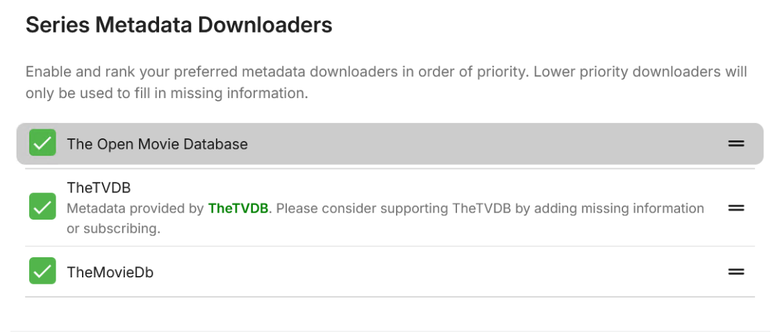

Luke 42288 Posted July 27, 2025 Posted July 27, 2025 1 hour ago, WingDog said: Do I understand the nuance being discussed correctly - no matter what fetcher the user chooses during the process of manually Identification, the internal algorithm will still follow the order of setting up the library? @Luke? At that point you are not choosing a fetcher. You are merely entering search criteria for your enabled fetchers. So to answer your question, yes you are correct.
WingDog 17 Posted July 27, 2025 Author Posted July 27, 2025 33 minutes ago, Luke said: At that point you are not choosing a fetcher. You are merely entering search criteria for your enabled fetchers. So to answer your question, yes you are correct. okay. so the next question is: On 7/25/2025 at 9:42 PM, WingDog said: or I must move those fetchers up and down constantly every Identify process?
WingDog 17 Posted July 27, 2025 Author Posted July 27, 2025 let's clarify: at this point I have a library with a clearly specified desired metadata (posters and all the other DATA) language, but during the identification process (it doesn't matter if it's manual or automatic) I get metadata in another language. What can I do?
Happy2Play 9814 Posted July 27, 2025 Posted July 27, 2025 8 hours ago, WingDog said: but during the identification process (it doesn't matter if it's manual or automatic) I get metadata in another language. What can I do? @Lukewon't having OMDB first cause issues for language specific fetching as they only have one language?
WingDog 17 Posted July 27, 2025 Author Posted July 27, 2025 21 minutes ago, Luke said: Yes it could. and the solution is......?
WingDog 17 Posted July 27, 2025 Author Posted July 27, 2025 18 minutes ago, Luke said: I would put Omdb last. it helped. thank you! 1
