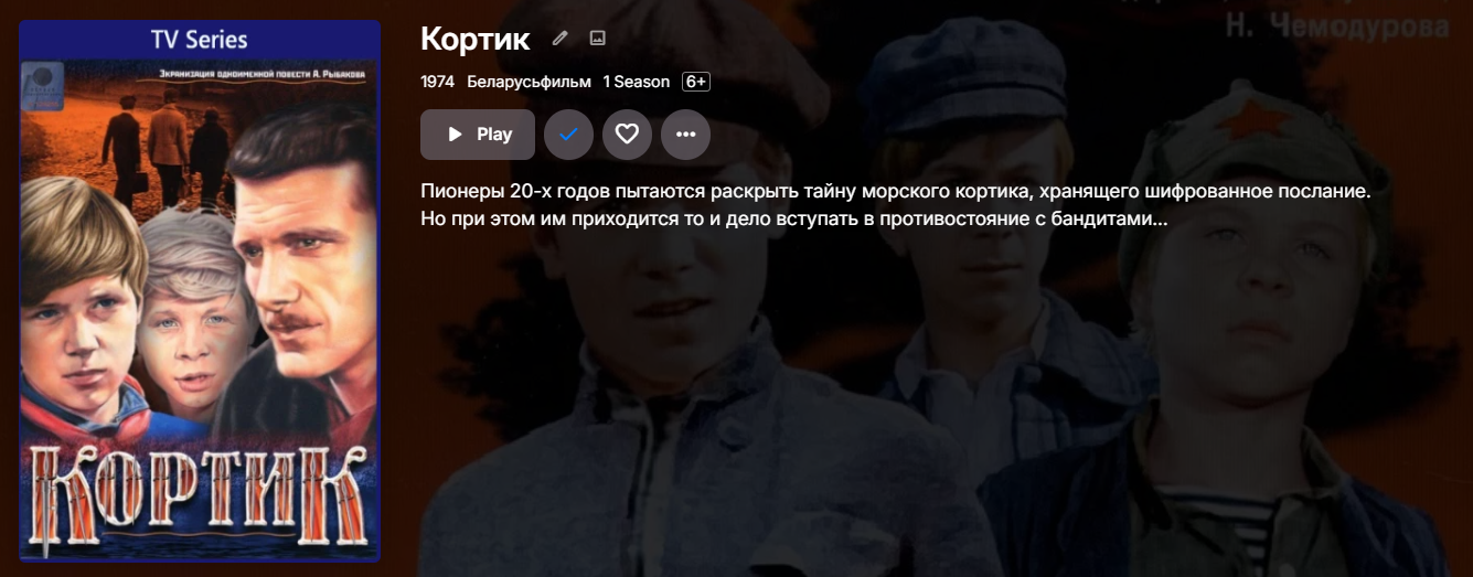

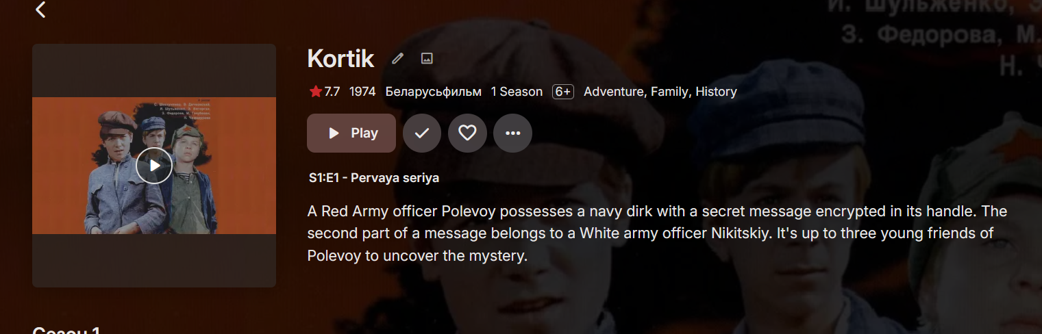

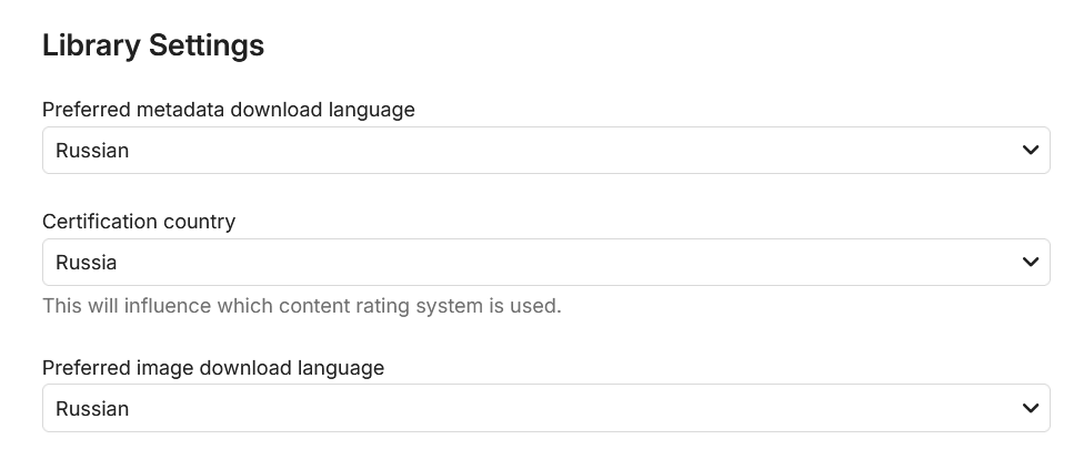

WingDog 17 Posted July 25, 2025 Author Posted July 25, 2025 (edited) Hello. It's me again. Library settings very old movie manual identification via https://www.thetvdb.com/series/285918-show why all is in English???? embyserver.txt Edited July 25, 2025 by WingDog log upload
Happy2Play 9814 Posted July 25, 2025 Posted July 25, 2025 1 hour ago, WingDog said: Hello. It's me again. Library settings very old movie manual identification via https://www.thetvdb.com/series/285918-show why all is in English???? embyserver.txt 665.22 kB · 0 downloads What is your metadata and image downloader order? But has no issue here with TVDB 2025-07-25 08:23:12.511 Debug App: Running TvdbSeriesImageProvider for E:\Media\TV Test Foreign language\Кортик 2025-07-25 08:23:12.515 Info HttpClient: GET https://artworks.thetvdb.com/banners/posters/285918-1.jpg 2025-07-25 08:23:12.680 Info HttpClient: Http response 200 from https://artworks.thetvdb.com/banners/posters/285918-1.jpg after 165ms 2025-07-25 08:23:12.712 Info ProviderManager: Saving image to E:\Media\TV Test Foreign language\Кортик\folder.jpg
WingDog 17 Posted July 25, 2025 Author Posted July 25, 2025 (edited) 3 hours ago, Happy2Play said: What is your metadata and image downloader order? what does it matter if i clearly stated fetcher and Movie ID? or I must move those fetchers up and down constantly every Identify process? there are already more than enough actions there! Edited July 25, 2025 by WingDog

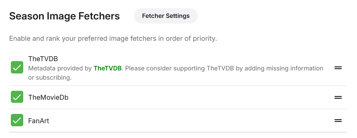

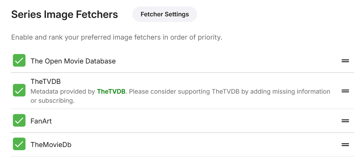

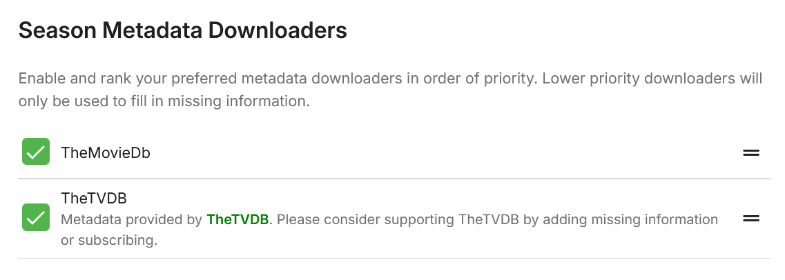

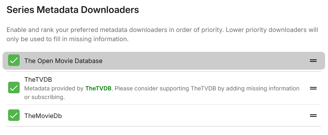

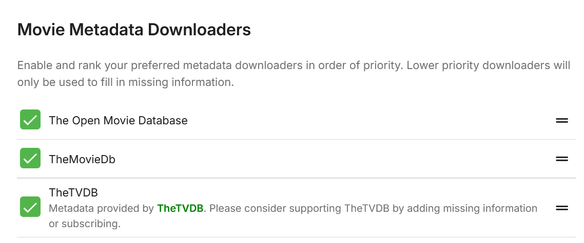

WingDog 17 Posted July 25, 2025 Author Posted July 25, 2025 3 hours ago, Happy2Play said: But has no issue here with TVDB but I have another metadata - look at my screenshots. and I'm asking again and again: how to fix this?
Happy2Play 9814 Posted July 25, 2025 Posted July 25, 2025 In the end almost everything will only come from first provider and if it doesn't exist there it will move to next provider. It will not get everything from every provider. 1 minute ago, WingDog said: but I have another metadata - look at my screenshots. and I'm asking again and again: how to fix this? Without settings it is impossible to say.
WingDog 17 Posted July 25, 2025 Author Posted July 25, 2025 11 minutes ago, Happy2Play said: only come from first provider and if it doesn't exist there it will move to next provider. this is beyond my comprehension. please explain why the fetchers (providers) are still go in order despite the fact that the user clearly and distinctly specifies which one to use during manual Identification? isn't it obvious that this situation only happens if the automatic determination screwed up and the result needs to be corrected manually? why does manual Identification uses the usual algorithm work from top to bottom? 13 minutes ago, Happy2Play said: Without settings it is impossible to say. 3 hours ago, Happy2Play said: What is your metadata and image downloader order?
