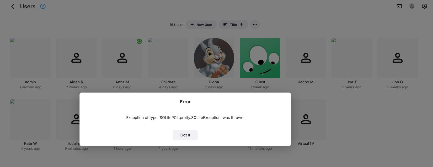

Micael456 45 Posted June 17, 2025 Posted June 17, 2025 (edited) Afternoon, hoping an API guru can help me here. I'm attempting to log on locally using a script user (would prefer this over an API key for scoping reasons). Unfortunately when the user attempts to log in I get a funky error thrown. I know the issue is something to do with the way I'm calling this, as I have tested the account via the browser. I'm just not sure what obvious thing I'm missing. Any pointers would be appreciated. This is what I'm posting: Spoiler curl --header "Content-Type: application/json" --header 'request: Authorization=Emby UserId="2c772b2cbdf249eb9cf5d16f4249636b", Client="Bash Script", Device="Linux OS", DeviceId="12345", Version="1.0.0.0" \ --request POST \ --data '{"Username":"localhost","password":"*****"}' \ http://localhost:8096/Users/AuthenticateByName And I'm fairly sure this is the relevant log section (though full log is attached): Spoiler 2025-06-17 15:25:44.771 Info Server: http/1.1 POST http://localhost:8096/Users/AuthenticateByName. Source Ip: ::1, Accept=*/*, Host=host3, User-Agent=curl/7.58.0, Content-Type=application/json, Content-Length=52, request=Authorization=Emby UserId="2c772b2cbdf249eb9cf5d16f4249636b", Client="Bash Script", Device="Linux OS", DeviceId="12345", Version="1.0.0.0" 2025-06-17 15:25:44.773 Info UserManager: Authentication request for localhost has succeeded. 2025-06-17 15:25:44.773 Info SessionManager: Creating new access token for user 16 localhost 2025-06-17 15:25:44.774 Info App: Sqlite: 1299 - abort at 9 in [Insert Into Devices2 (ReportedDeviceId, ReportedName, IpAddress) Values (@ReportedDeviceId, @ReportedName, @IpAddress) returning Id]: NOT NULL constraint failed: Devices2.ReportedDeviceId 2025-06-17 15:25:44.781 Error Server: Error processing request *** Error Report *** Version: 4.8.11.0 Command line: /opt/emby-server/system/EmbyServer.dll -programdata /var/lib/emby -ffdetect /opt/emby-server/bin/ffdetect -ffmpeg /opt/emby-server/bin/ffmpeg -ffprobe /opt/emby-server/bin/ffprobe -restartexitcode 3 -updatepackage emby-server-deb_{version}_arm64.deb Operating system: Linux version 4.9.241-77 (root@builder_n2) (gcc version 7.5.0 (Ubuntu/Linaro 7.5.0-3ubuntu1~18.04) ) #1 SMP PREEMPT Mon Mar 29 23:04:14 -03 2021 Framework: .NET 6.0.36 OS/Process: arm64/arm64 Runtime: opt/emby-server/system/System.Private.CoreLib.dll Processor count: 6 Data path: /var/lib/emby Application path: /opt/emby-server/system SQLitePCL.pretty.SQLiteException: Constraint: NOT NULL constraint failed: Devices2.ReportedDeviceId SQLitePCL.pretty.SQLiteException: Exception of type 'SQLitePCL.pretty.SQLiteException' was thrown. at SQLitePCL.pretty.SQLiteException.CheckOk(sqlite3 db, Int32 rc) at SQLitePCL.pretty.StatementImpl.MoveNext() at Emby.Sqlite.SqliteExtensions.ExecuteQuery(IStatement This)+MoveNext() at Emby.Server.Implementations.Security.AuthenticationRepository.GetDeviceId(Int64 internalId, String reportedDeviceId, String reportedDeviceName, IPAddress deviceIpAddress, Boolean checkForUpdatedDeviceValues, IDatabaseConnection db) at Emby.Server.Implementations.Security.AuthenticationRepository.Create(AuthenticationInfo info, IDatabaseConnection db, Boolean checkForUpdatedDeviceName) at Emby.Server.Implementations.Security.AuthenticationRepository.Create(AuthenticationInfo info) at Emby.Server.Implementations.Session.SessionManager.GetAuthorizationToken(User user, String reportedDeviceId, String app, String appVersion, String deviceName, IPAddress remoteIpAddress) at Emby.Server.Implementations.Session.SessionManager.AuthenticateNewSessionInternal(AuthenticationRequest request, Boolean enforcePassword, CancellationToken cancellationToken) at Emby.Api.UserService.Post(AuthenticateUserByName request) at Emby.Server.Implementations.Services.ServiceController.GetTaskResult(Task task) at Emby.Server.Implementations.Services.ServiceHandler.ProcessRequestAsync(HttpListenerHost httpHost, IServerApplicationHost appHost, IRequest httpReq, IResponse httpRes, IStreamHelper streamHelper, RestPath restPath, String responseContentType, CancellationToken cancellationToken) at Emby.Server.Implementations.HttpServer.HttpListenerHost.RequestHandler(IRequest httpReq, ReadOnlyMemory`1 urlString, ReadOnlyMemory`1 localPath, CancellationToken cancellationToken) Source: SQLitePCL.pretty TargetSite: Void CheckOk(SQLitePCLEx.sqlite3, Int32) 2025-06-17 15:25:44.892 Info Server: http/1.1 Response 500 to ::1. Time: 121ms. POST http://localhost:8096/Users/AuthenticateByName Thank you! Edit: realised I created this post in the wrong category, if a mod could move it. Sorry! embyserver (26).txt Edited June 17, 2025 by Micael456 Edited as I realised I made the post under client apps and not server Linux.

Micael456 45 Posted July 9, 2025 Author Posted July 9, 2025 Sorry for the delay, unfortunately when I tried again in the browser it failed with the same error. I'm also seeing that issue in the GUI when I'm trying to delete the user.
Micael456 45 Posted July 9, 2025 Author Posted July 9, 2025 (edited) As a quick update- that might be a red herring right now. Looks like my root drive has completely filled up- 20GB of temp cache has appeared. I suspect at least some of today's issues are caused by that. Let me resolve this and see what the situation is afterwards. Edited July 9, 2025 by Micael456 1
