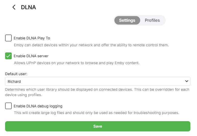

Luke 42234 Posted June 17, 2025 Posted June 17, 2025 @Richard Branchesin dlna server options you select the user you want to portray the library based on, and then the library display will be based on that user.
Richard Branches 338 Posted June 17, 2025 Author Posted June 17, 2025 Hello, so I see the below screenshot where I select the user: And then I see the "Profiles" tab with some system profiles and the ability to create a new one but there's a bunch of options unknown for me, I imagine I just have to create a profile for the receiver or that isn't necessary, correct?:

Happy2Play 9811 Posted June 17, 2025 Posted June 17, 2025 7 minutes ago, Richard Branches said: How do I create a custom profile for the receiver? What options do I have to use? What profile is your device using per your server log now? But you will want to enable DLNA debug logging to capture some device info and click on the profile it is currently using and modify it with custom info and give it a different name and save.

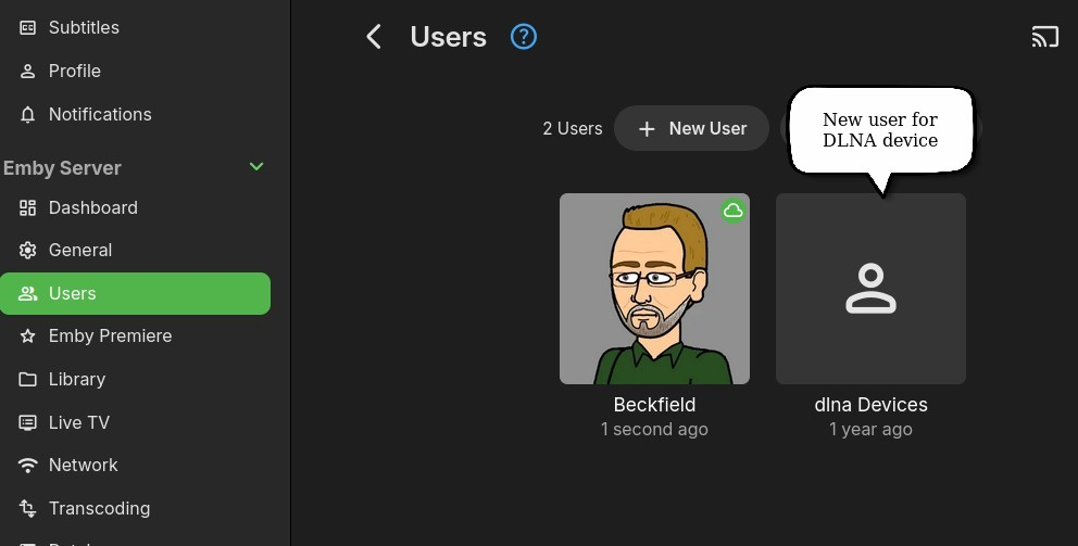

beckfield 174 Posted June 18, 2025 Posted June 18, 2025 (edited) One thing not covered in that process write-up: @Luketold me the following: Quote Currently supported media types does not change what is presented to the device. We probably should, but that doesn't happen right now. In the meantime, the only way to do this would be to create a separate user that only has access to the audio libraries, and then in your new dlna profile, set that user as the user library to be displayed. This will achieve what you want, albeit with the drawback that anything you play won't be reflected in the user data of the user that you normally use. Pursuant to that, in addition to the custom DLNA profile, I created a new User on my Emby server: When creating that user, I think I left every setting at the default on the first tab (Profile), other than giving it a name. The important stuff is on the "Access" tab, where you select the libraries this user will have access to. Then I used this user to connect the DLNA device to the Emby server. This is what will determine which libraries are displayed on your DLNA device. Edited June 18, 2025 by beckfield 1

Happy2Play 9811 Posted June 19, 2025 Posted June 19, 2025 4 hours ago, Richard Branches said: So I enabled DLNA debug logging and then I played a song but I don't see anything helpful about the profile of the receiver in the server log, please take a look: embyserver.txt 42.09 kB · 0 downloads Not seeing any "Debug DLNA" logging in the log. Can't remember but may need to enable debug logging in log also.

Richard Branches 338 Posted June 19, 2025 Author Posted June 19, 2025 I enabled debug on both the server and DLNA and I still don't see what to look for in that log: embyserver.txt
Happy2Play 9811 Posted June 20, 2025 Posted June 20, 2025 Looks like you have two devices using Default profile first being really generic Source Ip: 192.168.18.158, UserAgent: DLNA/1.0 DLNADOC/1.50 UPnP/1.0 and the other with a different useragent that can be used for a custom profile Source Ip: 192.168.18.208, UserAgent: dLeyna/0.5.0 GUPnP/0.20.13 DLNADOC/1.50 still not seeing device info. @Lukeis that info only via upnp like from a beckfield log? As OP log does not appear to have any of this info. Spoiler 2025-06-19 09:18:49.870 Debug DLNA: Response from http://192.168.1.69:8888/upnp_descriptor_0: <?xml version="1.0" encoding="utf-8"?><root xmlns="urn:schemas-upnp-org:device-1-0"><specVersion><major>1</major><minor>0</minor></specVersion><device><deviceType>urn:schemas-upnp-org:device:MediaRenderer:1</deviceType><friendlyName>CR-N755</friendlyName><manufacturer>ONKYO</manufacturer><manufacturerURL>http://www.onkyo.com</manufacturerURL><modelDescription>AV/CD Receiver</modelDescription><modelName>CR-N755</modelName><modelNumber>CR-N755</modelNumber><modelURL>http://www.onkyo.com</modelURL><UDN>uuid:fad44c92-a24c-92b6-1e2e-9262a2b6c076</UDN><serviceList><service><serviceType>urn:schemas-upnp-org:service:RenderingControl:1</serviceType><serviceId>urn:upnp-org:serviceId:RenderingControl</serviceId><controlURL>/upnp_control_0</controlURL><eventSubURL>/upnp_event_0</eventSubURL><SCPDURL>/scpd/RenderingControl_1</SCPDURL></service><service><serviceType>urn:schemas-upnp-org:service:ConnectionManager:1</serviceType><serviceId>urn:upnp-org:serviceId:ConnectionManager</serviceId><controlURL>/upnp_control_1</controlURL><eventSubURL>/upnp_event_1</eventSubURL><SCPDURL>/scpd/ConnectionManager_1</SCPDURL></service><service><serviceType>urn:schemas-upnp-org:service:AVTransport:1</serviceType><serviceId>urn:upnp-org:serviceId:AVTransport</serviceId><controlURL>/upnp_control_2</controlURL><eventSubURL>/upnp_event_2</eventSubURL><SCPDURL>/scpd/AVTransport_1</SCPDURL></service></serviceList><presentationURL>http://192.168.1.69/</presentationURL><pnpx:X_hardwareId xmlns:pnpx="http://schemas.microsoft.com/windows/pnpx/2005/11">VEN_1666&DEV_1200&REV_01 VEN_0033&DEV_000C&REV_01</pnpx:X_hardwareId><dlna:X_DLNADOC xmlns:dlna="urn:schemas-dlna-org:device-1-0">DMR-1.50</dlna:X_DLNADOC><df:X_deviceCategory xmlns:df="http://schemas.microsoft.com/windows/2008/09/devicefoundation">Multimedia.DMR</df:X_deviceCategory><pnpx:X_compatibleId xmlns:pnpx="http://schemas.microsoft.com/windows/pnpx/2005/11">MS_DigitalMediaDeviceClass_DMR_V001</pnpx:X_compatibleId><iconList><icon><mimetype>image/jpeg</mimetype><width>120</width><height>120</height><depth>24</depth><url>http://192.168.1.69/icon/mini_120.jpg</url></icon><icon><mimetype>image/jpeg</mimetype><width>48</width><height>48</height><depth>24</depth><url>http://192.168.1.69/icon/mini_048.jpg</url></icon><icon><mimetype>image/jpeg</mimetype><width>32</width><height>32</height><depth>24</depth><url>http://192.168.1.69/icon/mini_032.jpg</url></icon><icon><mimetype>image/png</mimetype><width>120</width><height>120</height><depth>24</depth><url>http://192.168.1.69/icon/mini_120.png</url></icon><icon><mimetype>image/png</mimetype><width>48</width><height>48</height><depth>24</depth><url>http://192.168.1.69/icon/mini_048.png</url></icon><icon><mimetype>image/png</mimetype><width>32</width><height>32</height><depth>24</depth><url>http://192.168.1.69/icon/mini_032.png</url></icon></iconList><pnpx:X_deviceCategory xmlns:pnpx="http://schemas.microsoft.com/windows/pnpx/2005/11">MediaDevices</pnpx:X_deviceCategory><microsoft:magicPacketWakeSupported xmlns:microsoft="urn:schemas-microsoft-com:WMPNSS-1-0">0</microsoft:magicPacketWakeSupported><microsoft:X_magicPacketSendSupported xmlns:microsoft="urn:schemas-microsoft-com:WMPNSS-1-0">1</microsoft:X_magicPacketSendSupported></device></root> 2025-06-19 09:18:49.874 Debug DLNA: Device Manufacturer: ONKYO 2025-06-19 09:18:49.874 Debug DLNA: Device Model Name: CR-N755 2025-06-19 09:18:49.874 Debug DLNA: RequestThrottleMs is 50ms for CR-N755 2025-06-19 09:18:49.874 Debug DLNA: Found device name CR-N755 from device properties
