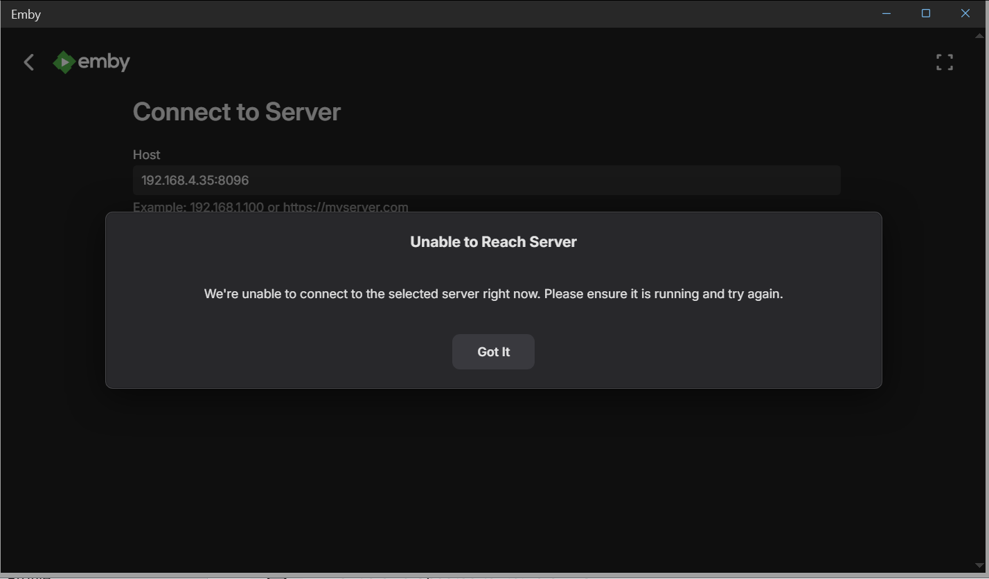

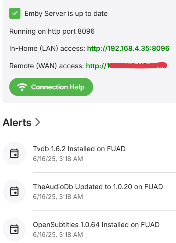

DfY38Mb55 2 Posted June 16, 2025 Author Posted June 16, 2025 (edited) Thank you for your kind assistance. I believe I have the server installed. It was the first thing I installed. I only discovered I needed the client later. Now, I have both. The Windows 10 Start menu shows "Emby Server,: "Emby Server Dashboard," and "Emby." See also the attached screen capture image. See also the second image "Unable to connect." I await further advice, with thanks. Edited June 17, 2025 by GrimReaper WAN IP masked

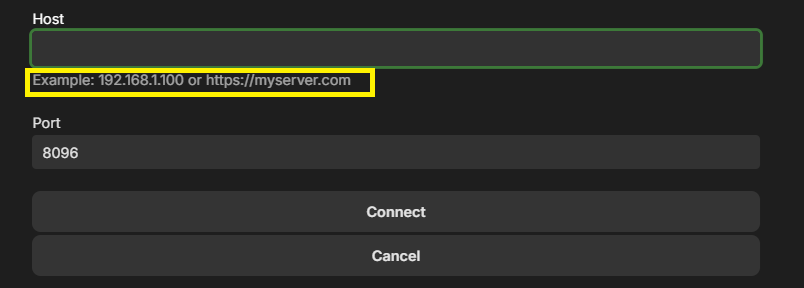

Lessaj 486 Posted June 16, 2025 Posted June 16, 2025 1 hour ago, DfY38Mb55 said: I await further advice, with thanks. For host you only enter the IP address, host name or domain name, the second field is the port number. 2 1

Happy2Play 9814 Posted June 17, 2025 Posted June 17, 2025 Will need a Mod to edit image above @GrimReaper@seanbuff But there really shouldn't be any issues as the port is open Since I can see your page remotely It shouldn't be a firewall issue unless you recently changed it. But as mentioned above what client and type of connection?

DfY38Mb55 2 Posted June 17, 2025 Author Posted June 17, 2025 3 hours ago, Happy2Play said: Will need a Mod to edit image above @GrimReaper@seanbuff But there really shouldn't be any issues as the port is open Since I can see your page remotely It shouldn't be a firewall issue unless you recently changed it. But as mentioned above what client and type of connection? I see that someone has redacted the WAN access number in the image file that I sent. Was that for my protection? If so, thank you. Was I wrong to send it unredacted? Did I unwittingly expose my computer to intruders? Is there any further protection measure that I should do now after the fact? You say, "I can see your page remotely." What page is that? How do you see my page remotely? Is that because I provided the WAN access number? If so, how do I prevent bad guys from doing the same from this point on? What client and type of connection? The client is the Emby app for Windows (Windows 10). Both the desktop and the storage device are connected to the network by ethernet. Thank you for your kind assistance.

Happy2Play 9814 Posted June 17, 2025 Posted June 17, 2025 (edited) Well from this image we should have seen your issue earlier. Host will not contain port as it is the next line. Edited June 17, 2025 by Happy2Play

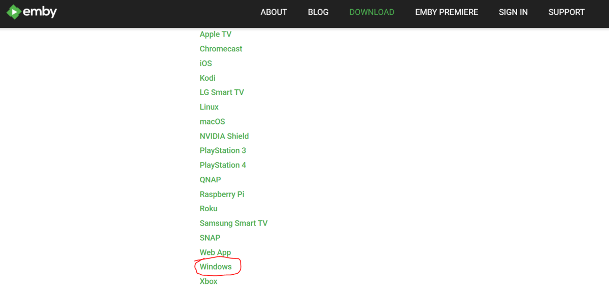

DfY38Mb55 2 Posted June 17, 2025 Author Posted June 17, 2025 7 minutes ago, Happy2Play said: When you say Emby app for Windows you mean this one? Emby for Windows - Emby It probably is, but I can't tell because mine is an empty Emby. It has no media, so so it does not look anything like the one advertised. I have attached a picture of the page from which I downloaded it, if that helps.

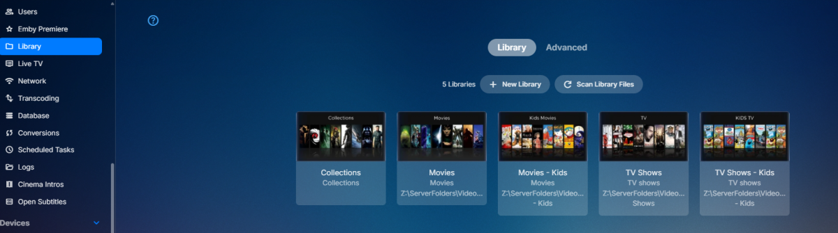

Happy2Play 9814 Posted June 17, 2025 Posted June 17, 2025 5 minutes ago, DfY38Mb55 said: It probably is, but I can't tell because mine is an empty Emby. It has no media, so so it does not look anything like the one advertised. Will be glad when 4.9 gets released as it will how libraries. Have you configured your libraries when you installed Emby? If you go to the Dashboard and click Library are they shown?
seanbuff 1360 Posted June 17, 2025 Posted June 17, 2025 21 minutes ago, Happy2Play said: Well from this image we should have seen your issue earlier. @Lessajalready pointed this out earlier 7 hours ago, Lessaj said: For host you only enter the IP address, host name or domain name, the second field is the port number. 1
DfY38Mb55 2 Posted June 17, 2025 Author Posted June 17, 2025 39 minutes ago, Neminem said: Emby do not supply media files. You need to rip your own media, from disc. Emby, thankfully, does not supply media files. I have my own. All I was trying to accomplish was to use Emby to access my media files (migrating from Plex). Emby didn't seem to want to do that at first. That's how this thread started. It looks like things are moving now. I am building the first "library." The progress bar is now at 96%. It moved fairly quickly until it reached 90% and then became very slow. Let's see how far it goes. Thanks to all who have rushed to my rescue. We are not out of the woods yet, but we have advanced. 2
